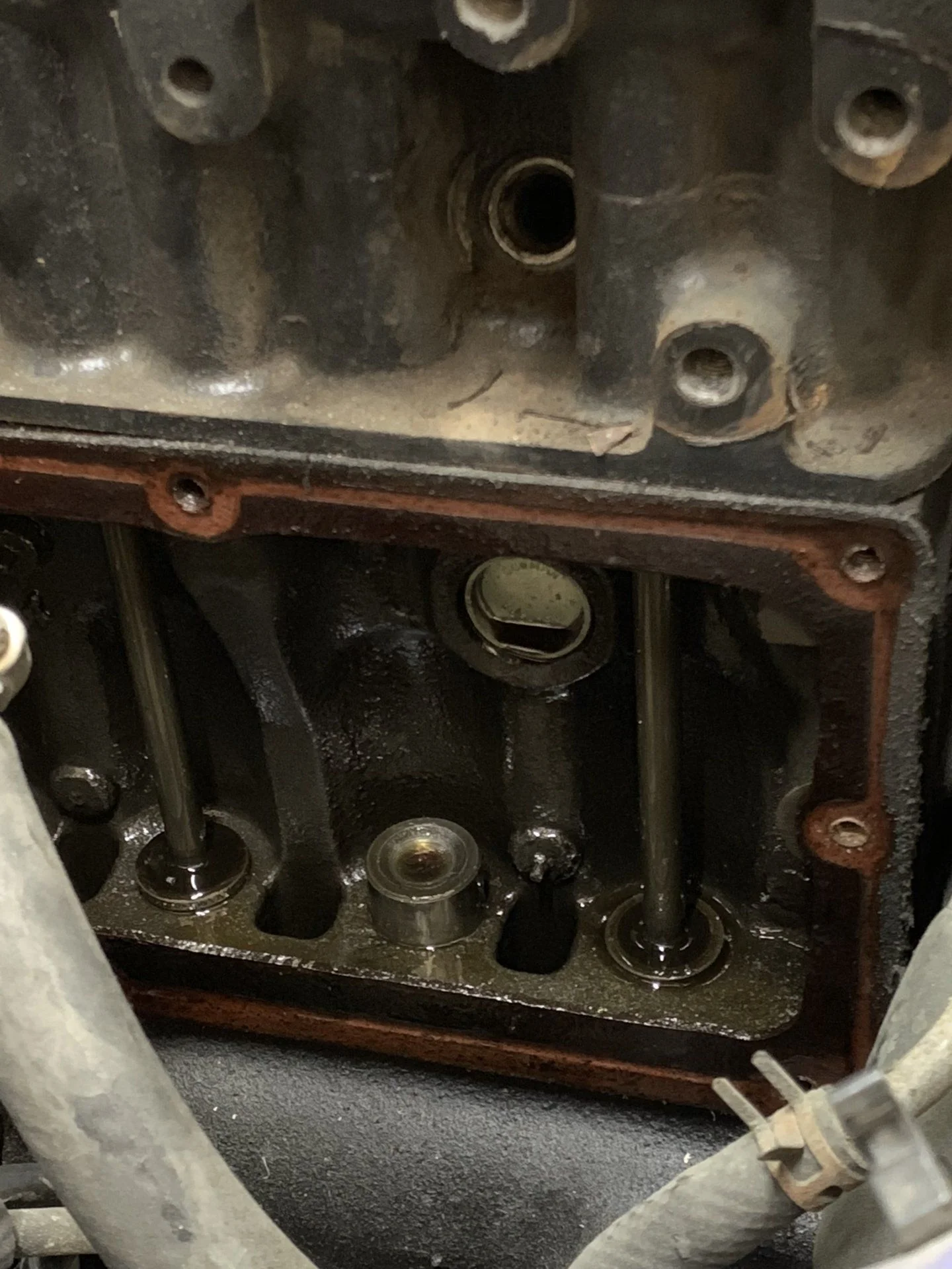

Cylinder 1 lifter is believed to be collapsed at the bottom where it meets the cam lobe. Looking for input on how to remove as it seems to be stuck. Will move freely until a certain point (about 3/4" exposed) and then will not move further. There's room to get channel locks etc. on it but no luck prying on it as there's not much leverage. If anyone has any tips on this that would be awesome. Pic attached for reference

2F lifters are solid - not hydraulic. They can't "collapse". If you really want to get it out to examine the rubbing surface, try rotating the engine a bit, Normally they come out easily with a magnet.
Why do you feel it is "Collapsed"?
Ended up getting it out by turning the lifter to where I could get a small punch inside and was able to get enough leverage on it to get it free. Bottom of the lifter is warped and that’s why it wouldn’t come out with a magnet (tried that first). Plan on replacing all lifters while we have it apart. Inspected cam lobes on that cylinder and no sign of damage, so just a bad lifter is all I’ve found. Going to put it back together and see what happens. Will post a pic of the lifter tomorrow if I remember. Thanks for the help guys

Good call. I guess "collapsed" is the wrong term. I assumed he meant it got mushroomed out or something like the lobe had damaged it somehow.
I would pull all the lifters label in order and pull the camshaft and inspect it with a micrometer if the lifter is that bad the camshaft has to be damaged also.

Make sure lifter bore is not scored.
Mushroomed is the term my brother used and that sounds like a more accurate description, not collapsed.
"inspecting" all the lobes of a camshaft while it is still in the engine sounds pretty iffy to me. I know that I would not assume that I would be able to accurately assess the condition and wear that way.
It is also doubtful in the extreme that a lifter has excessive wear while the matching lobe is undamaged.
2F cams have a bit of a reputation for wearing out.
New lifters on an old cam? Not how I would do it. Ever.

Cam lobe looks a bit worn where that lifter got damaged so I'm replacing the Camshaft. Dealer says it's discontinued of course, does anybody have any leads on one? I don't want any kind of performance one, just one close to factory specs.
