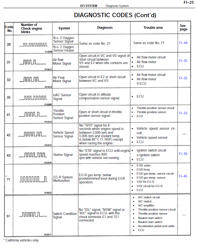

From the 1991 Toyota FSM:
Which version of the manual did you grab? You would need one from a year that had OBD I. The 96 manual I have has an extensive section on diagnostics, but it only covers OBD2
I have the 1991 FSM.
Perfect. Thank you. I have about 6 different folders with a lot of documents to go trough. I didnt see this one but I will double check.
