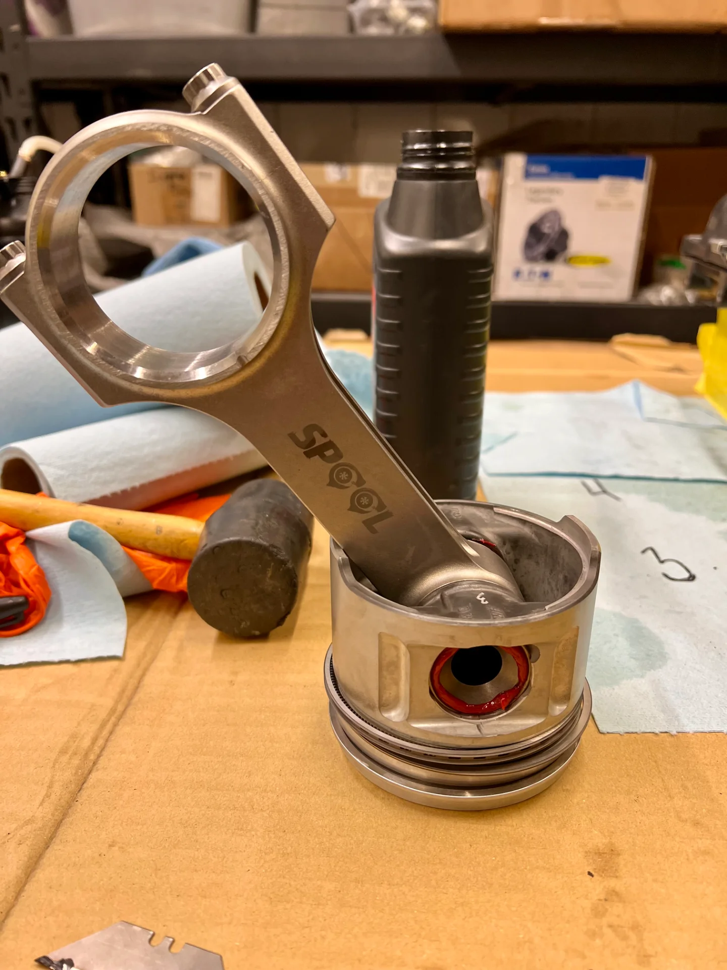

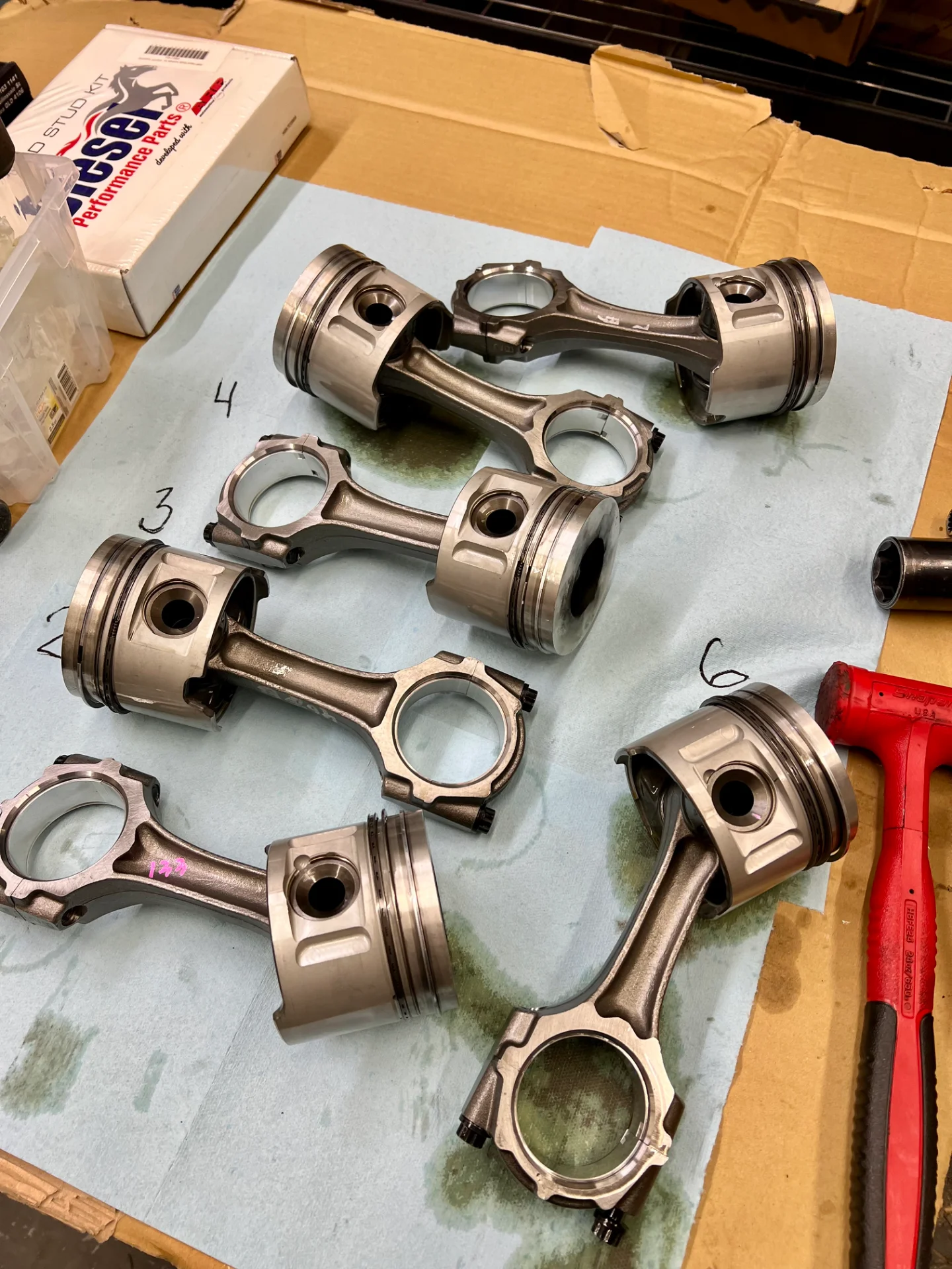

Ready to start swapping conrods. Unfortunately the block and head need to be painted before reassembly.

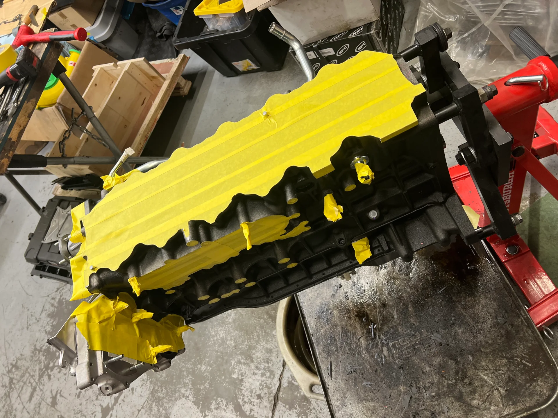

Cheers

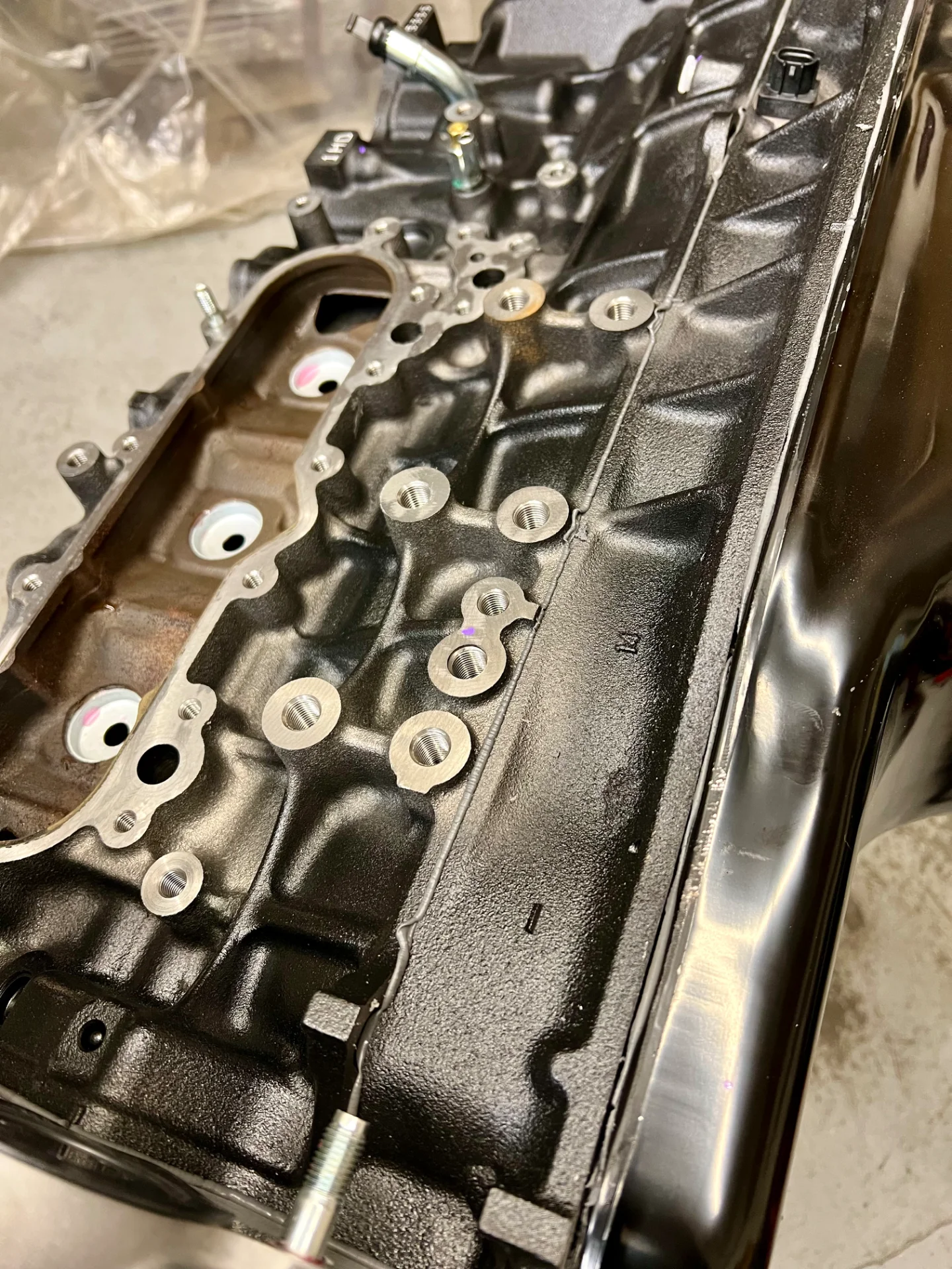

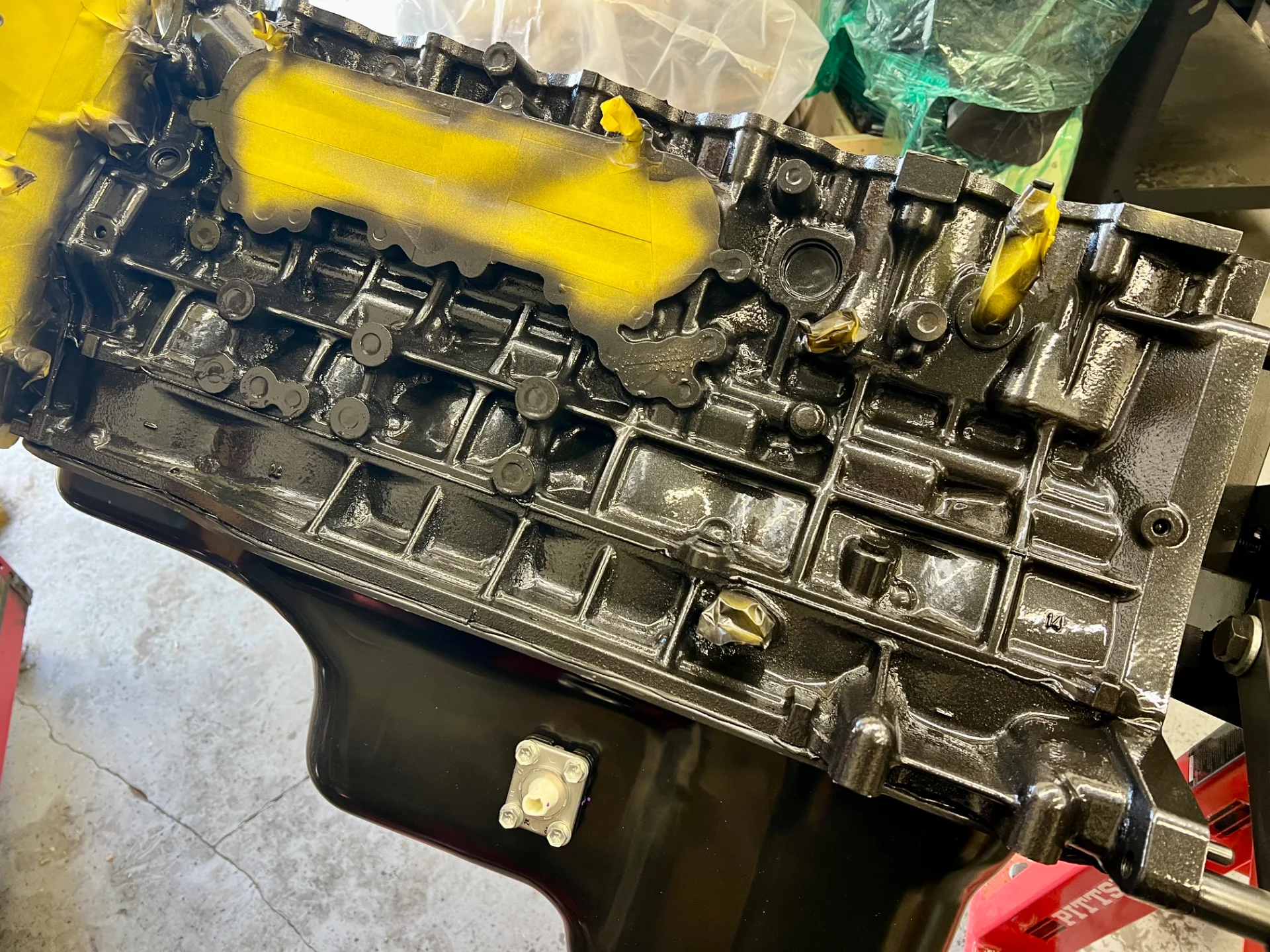

What paint do you recommend for blocks?
VHT engine paint. It’s all about the prep though, you got to remove any and all oil/grease and you have to remove rust if there is any. Then you got to scuff or sand or sometimes I use a needle scaler if the block is rusty. More or less etch the surface so the paint will stick and last long term.
Cheers

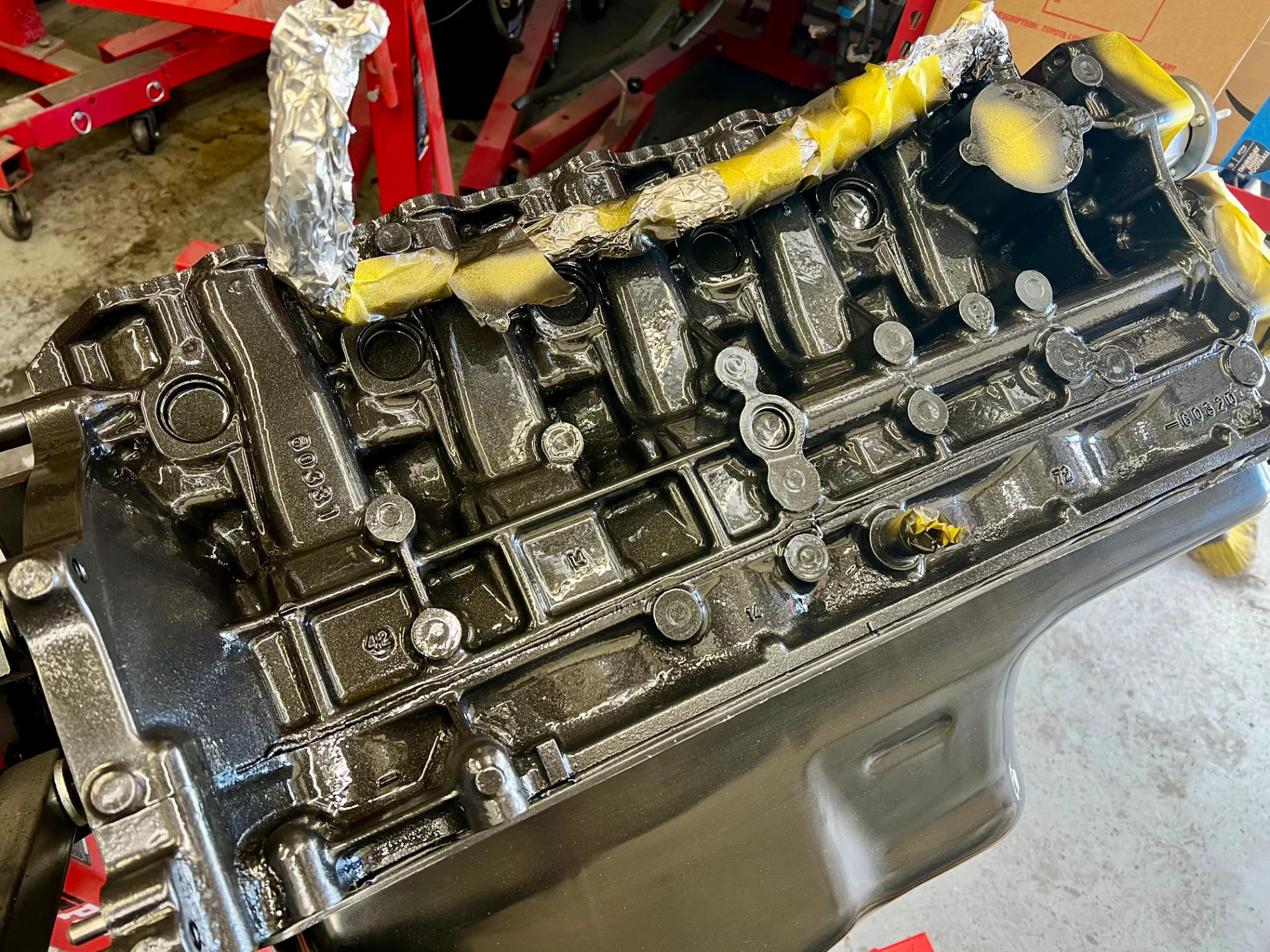

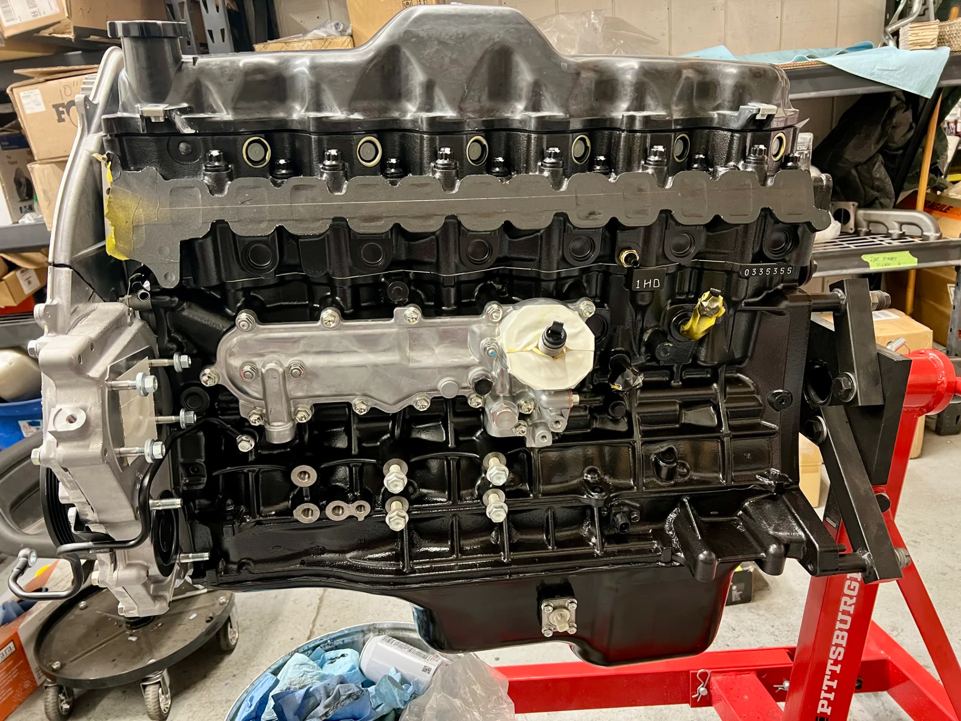

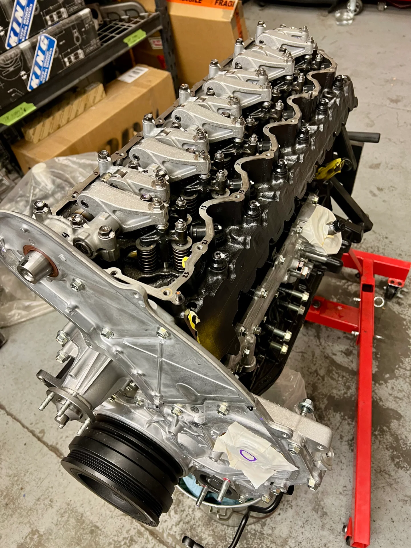

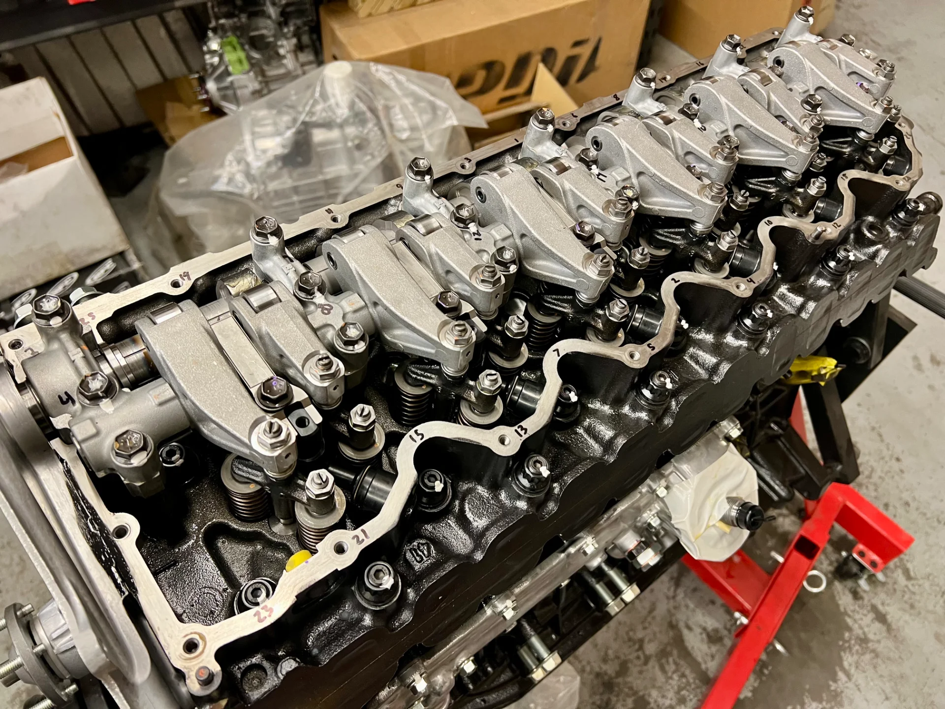

Block is done, black pearl! 😁🤌
Tomorrow I will do the head and then it is time to reassemble.
Cheers

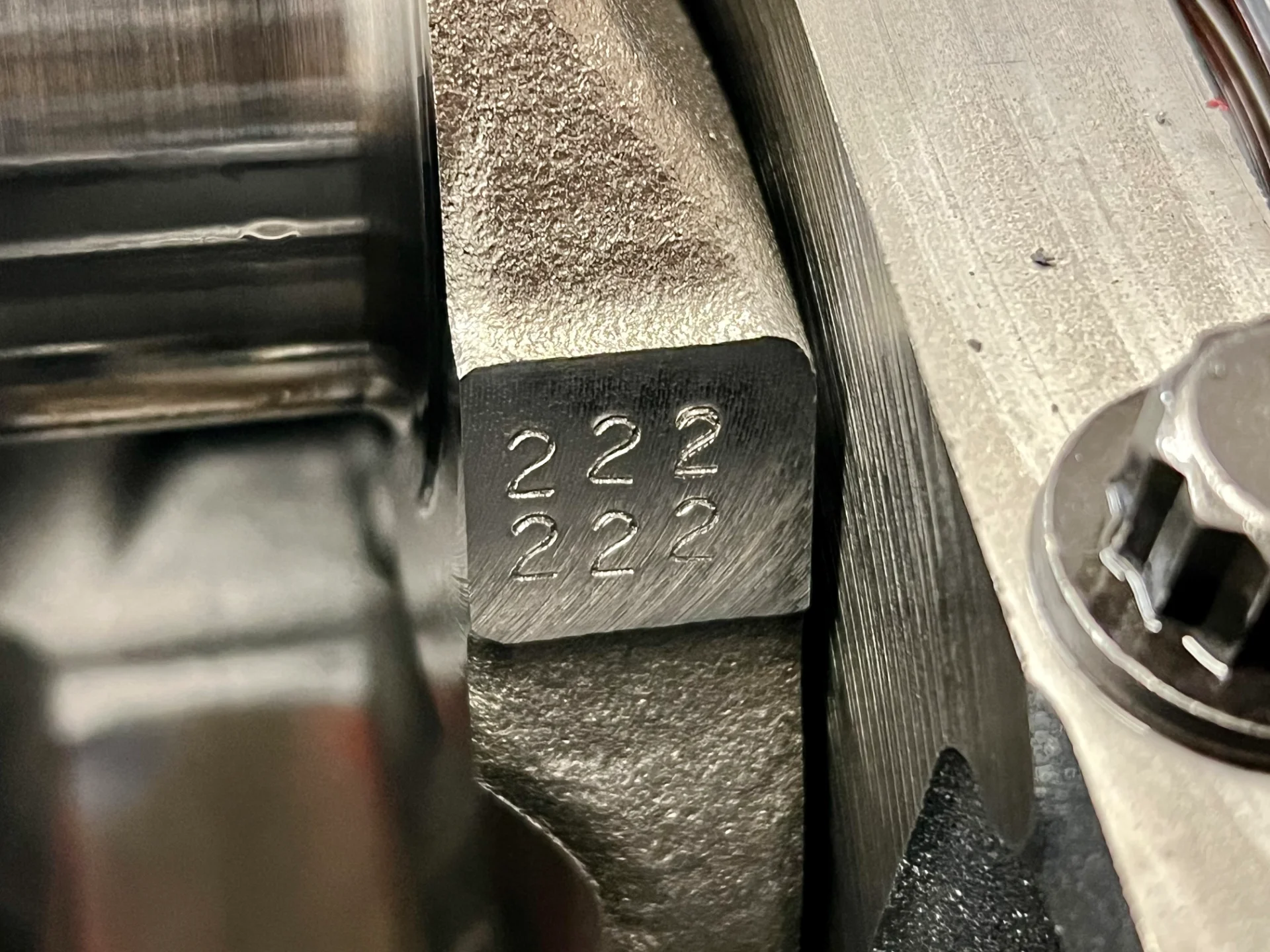

A little machining needed to fit the Spool conrods. That is all done now.

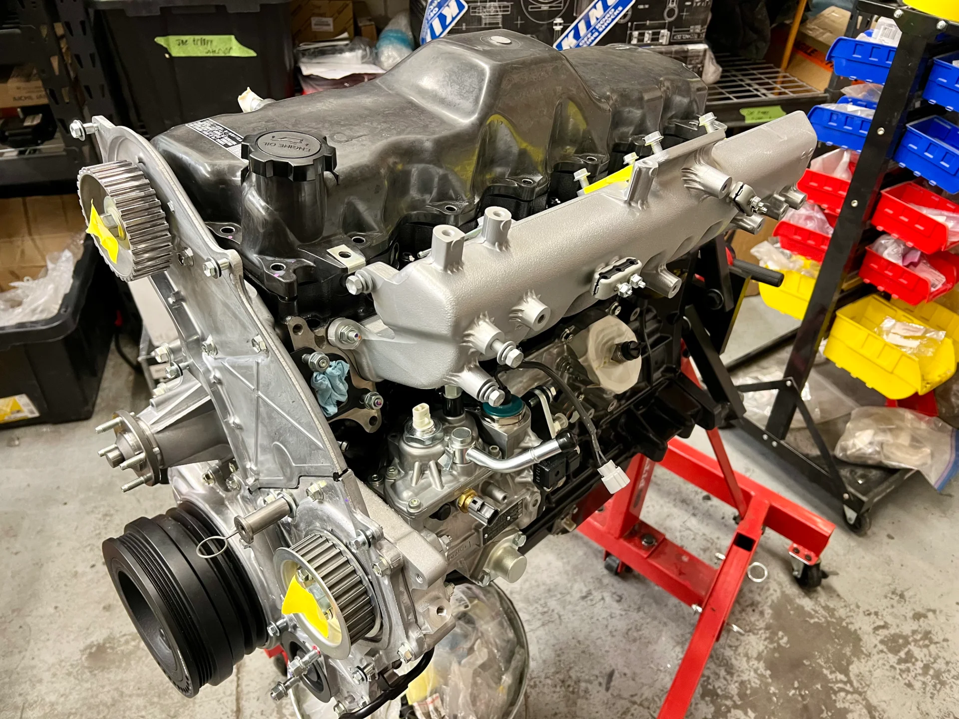

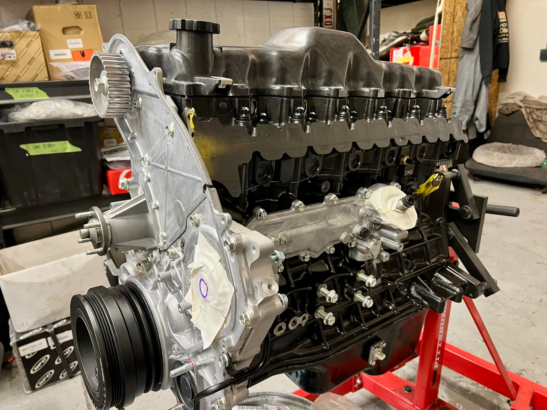

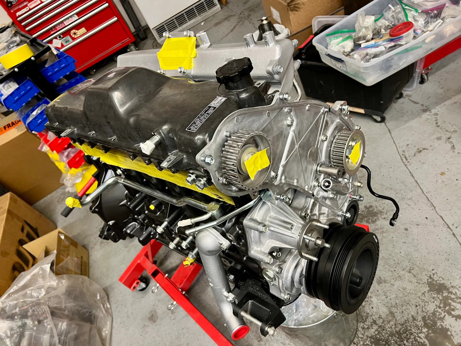

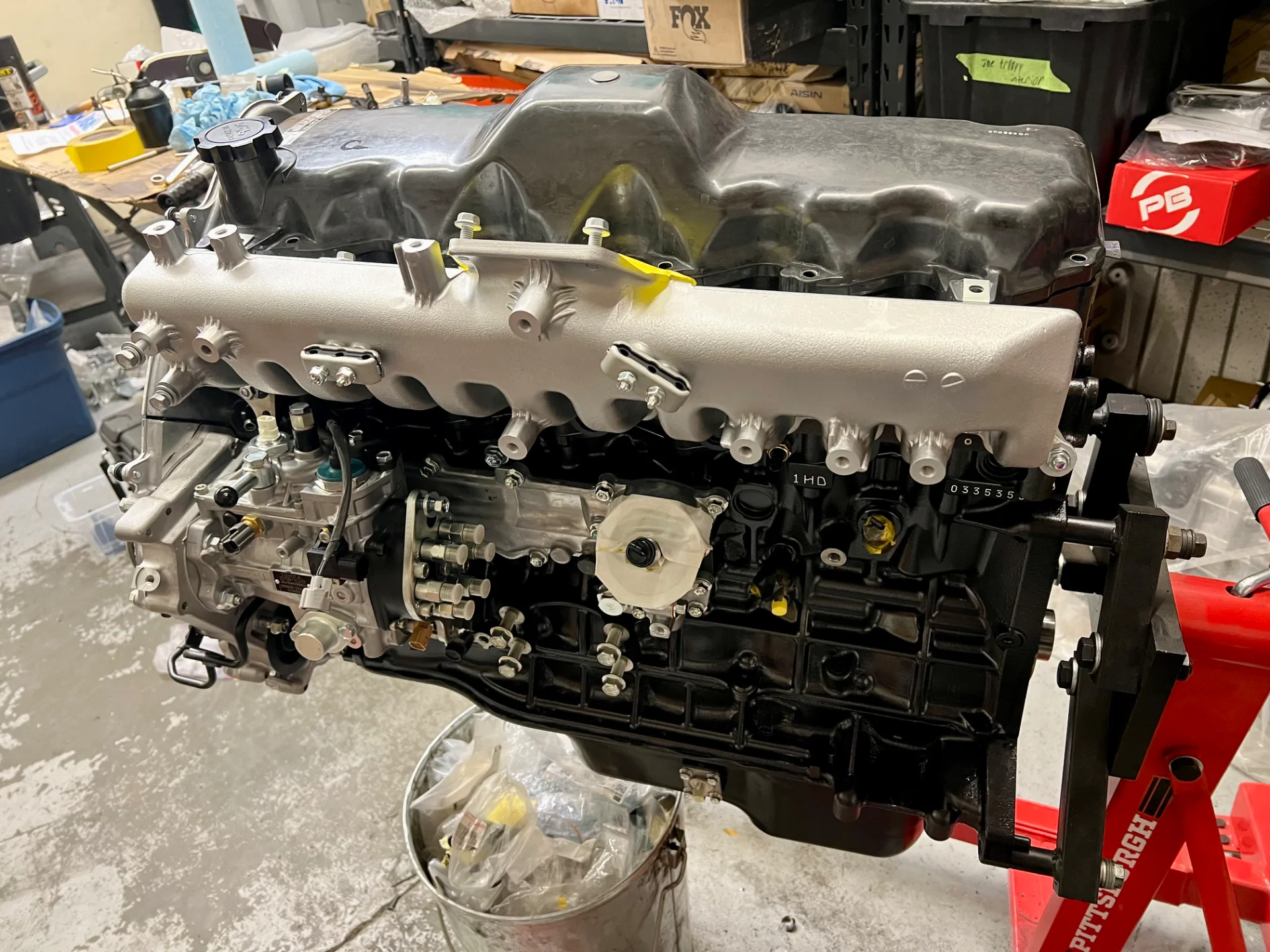

They sure look good when you get them painted properly.
We have a bunch of engine parts out getting ceramic/cerakote/powder coatings.

The powder coater did an amazing job that motor looks killer !!
Great work as usual !!
