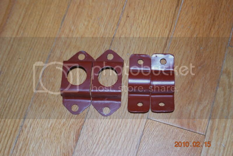

that's awesome! that's more than enough of the "missing" info i was looking for to piece this all together.
no problem to make my own parts if i need them (i'm only missing a few brackets). the prices of Toyota parts from Toyota here down unda' would shock the pants off ya!
cheers
crusty
I have some of the brackets if someone needs them.
