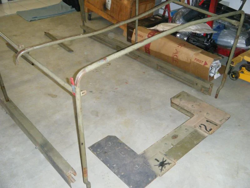

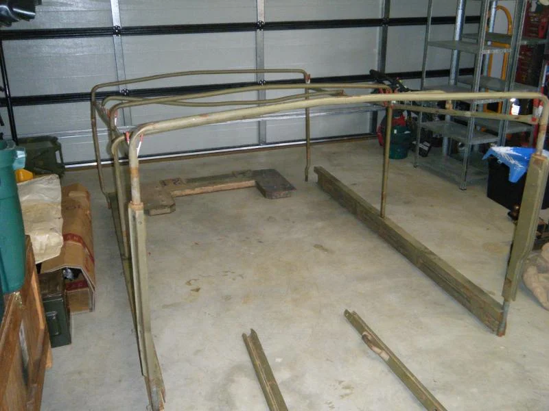

first pic is factory bows, modified for the army top, and a couple more.
it's "almost" all there, a few parts are missing but mostly it's bent and rough. the canvas is wasted.
any ideas/info and thoughts appreciated.

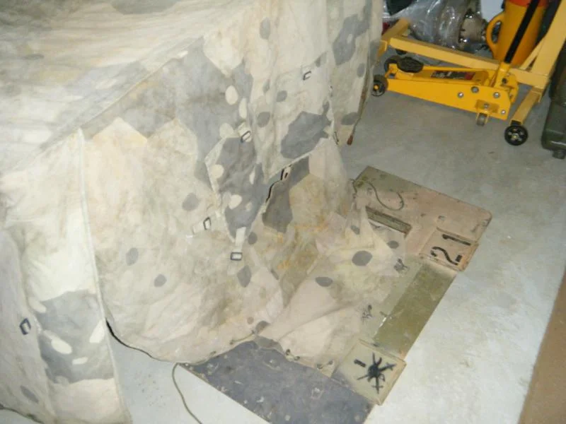

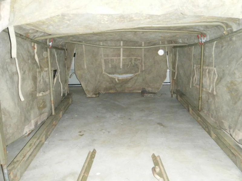

couple more...
i'm not going to be using the side or back bits. it's missing pieces and i want to run half doors in the back.
just putting them in the pic for reference (and to hold it all together).
the bottoms of some bows have been cut down, but easy enough to fix back to stock height.
it's really too bad the top is in such rough shape, i do like it.

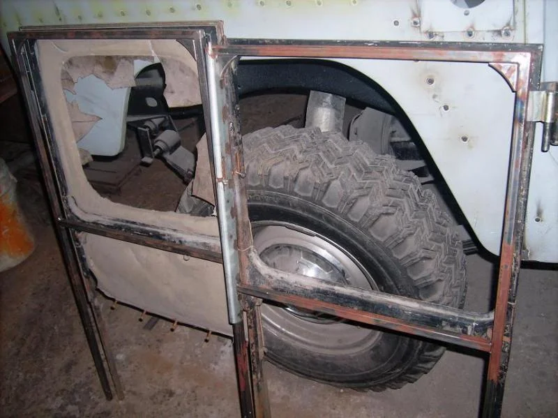

dont know if this helps,
we decided to put bi folds with removeable top frame,
we ended up making the bows, and then fabing up the rear bi folds with the slots to remove the frame..then we made the door frames,
we made this clasp up on the back cross bow as it will look prettier than just flattened and welded tube.

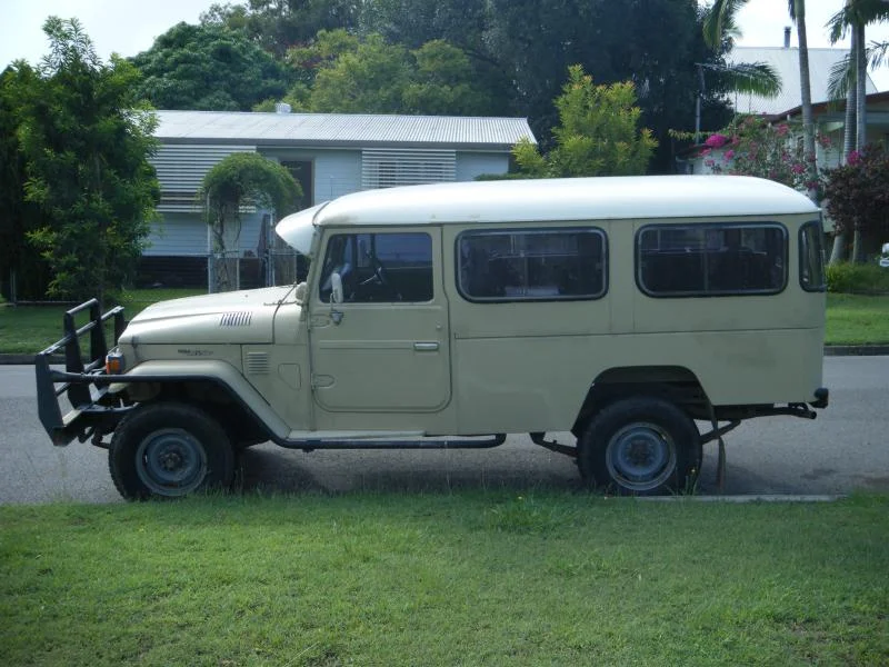

Hope these two pics help a little bit

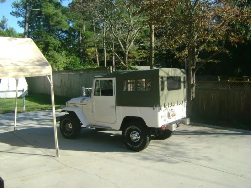

first is my BJ43 with half /ambulance doors
second a 45 .
Construction of the roof bows / doors are the same on both trucks
only the length of the side parts and the number of the middle parts are different.
Cheers
Peter

would do the small windows on the side and the rear like they are in the ambulance doors and no corner windows, just my two pence ;)

yes, windows like the yellow troopy, but with the corner windows in the back, like a 40.
small windows would look a bit lost on all that canvas on the sides, and the corner windows in the back won't change the look from the side.
in the attached pic, the rear window looks to be the right size and shape for the side windows as well.

a) It`s your truck and your choice ;)
b) no, I don`t think so, I like this little " secret" windows side and rear.
c) The corner windows will scratch a lot over the years if you pull the roof off and on.
I own my BJ43 30 years now :clap: and mounted this vinyl top up and down more than 500 times or more ( haven`t counted it) and the top is in good shape for it`s age.
My side plastic windows are renewed twice.
On the ambulance doors I made another construction to put glas windows in.
c) sorry no other pics and parts are no longer available.

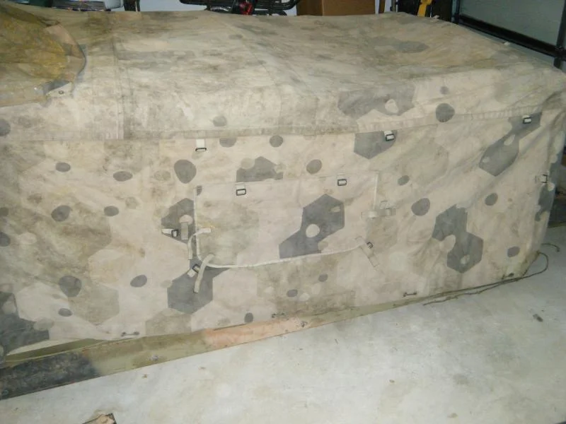

any idea who bought this troopy? has it shown up here on mud yet? i'd like to get a few detailed pics of how the soft top attaches to the tub.
specifically the "center" bits of the soft top.

some detailed pics of this area would be awesome! i'm still not sure how the top is attached there. footman loop and strap or???
i've looked and looked, and i can't find many good pics online.

I think it`s attached with this "little knobs" (sorry don`t know the english name for them)
you can see in this pic, my 43 have 5 "knobs" on each side. One knob behind the front doors is covered from the top part which is secured in the channel too)
so I`m sure they did the same in the middle area of the 45 top.
Pic of the yellow 45 make me pretty sure ( not 100 % ;) ) for that.

i wondered about that. but that would make sense, it would attach like the piece just behind the door opening .
pic stolen from ocdbeetle's soft top thread.
