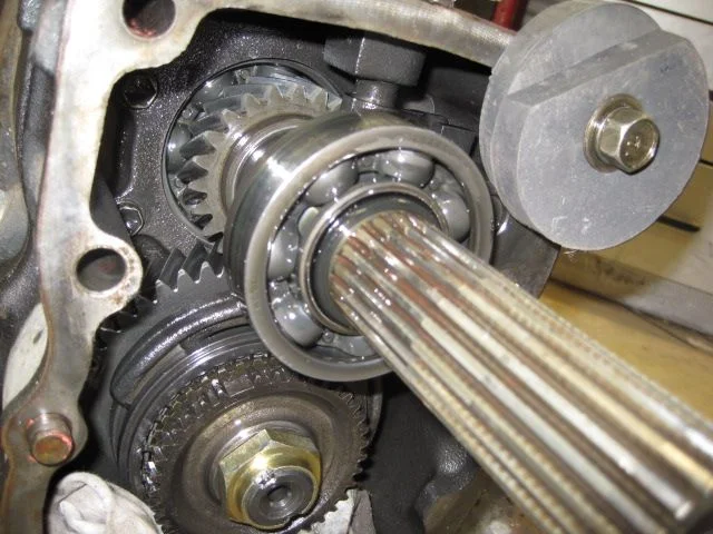

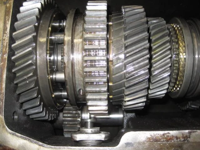

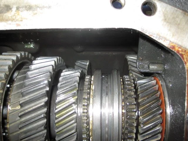

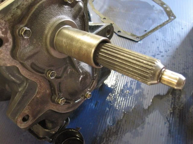

rear output shaft is excellent shape, on the H55F this is one area to check for wear since the mountains, over time, wear from flat top wide ridge to pointed, narrow ridges which allows excessive shock when shifting and going from forward to reverse.
input shaft is snug and clean.

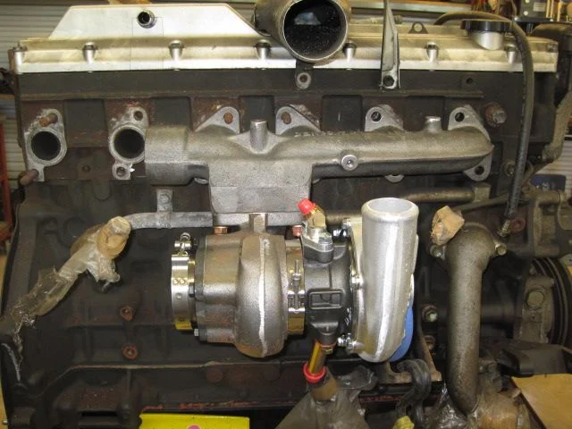

test fitting the turbo

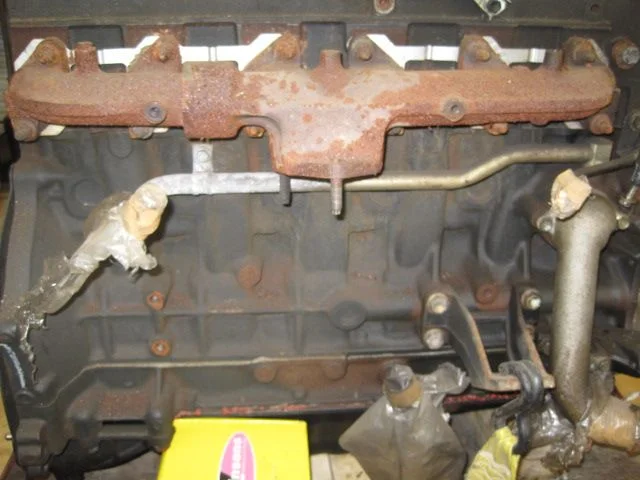

the manifold is now off to the PC to be coated with a high heat silver coating. it sucks how fast cast rusts.

tranny gears appear in excellent shape.

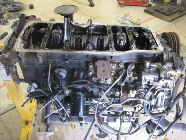

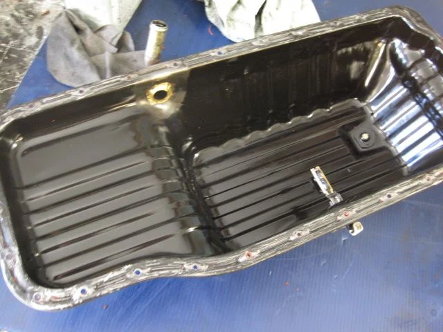

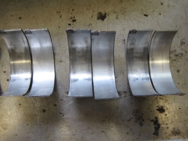

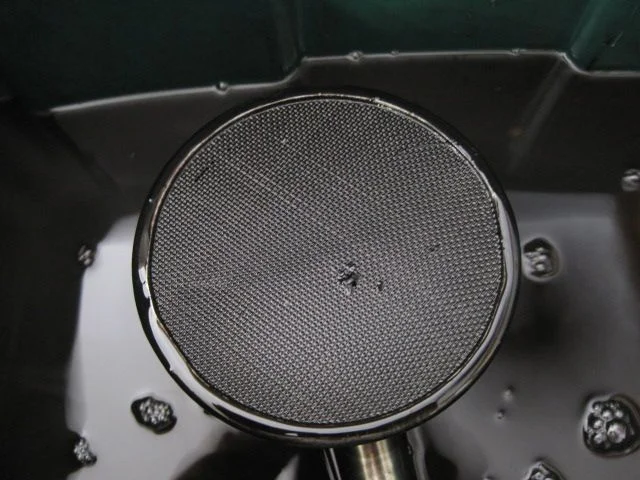

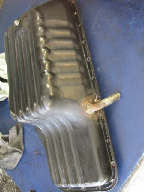

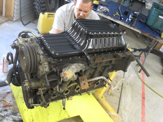

removing the oil pan to do the BEBs
the screen is surprisingly clean.

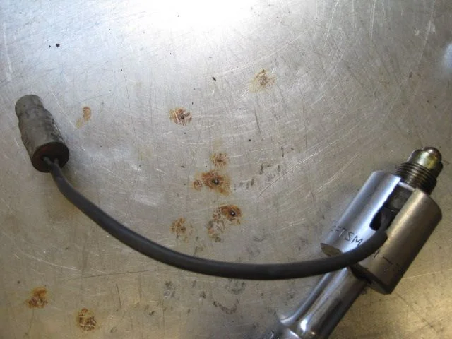

better shots of the turbo oil return pipe

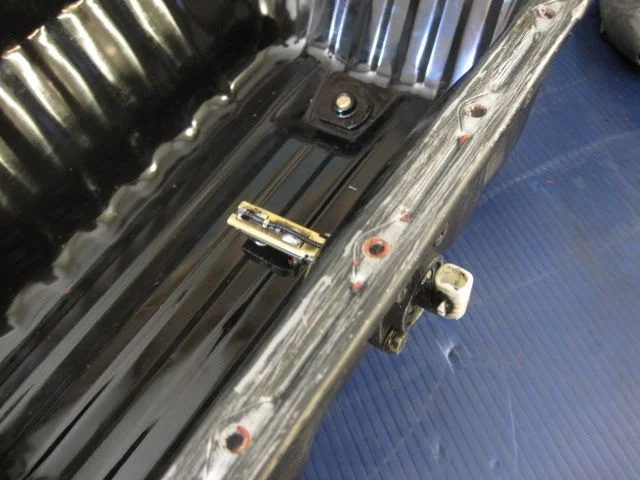

the oil level indicator sending unit.

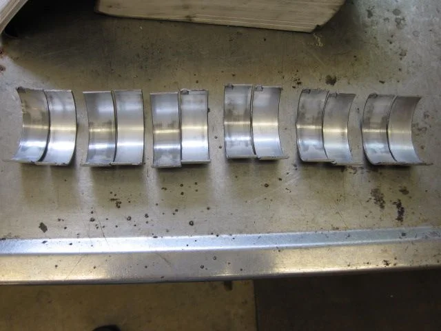

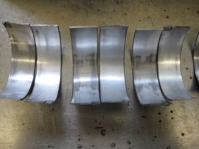

the old BEB from this engine ...
not bad shape, normal wear, no delaminating but for the cost new just made sense.

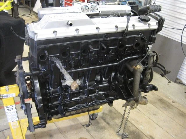

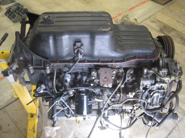

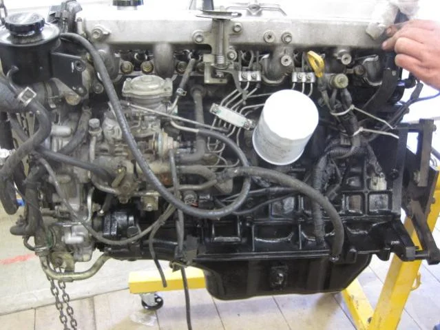

looking better, most of the engine just needed a good cleaning, the basic block got a shot of high heat paint applied.

checking the turbo kit for accuracy.
packaging was second to none, very well packaged.
so far seems everything is there
but
doing a quick read of the instructions show they are less than what i was hoping for. if possible when i install this it will help fill the missing information.

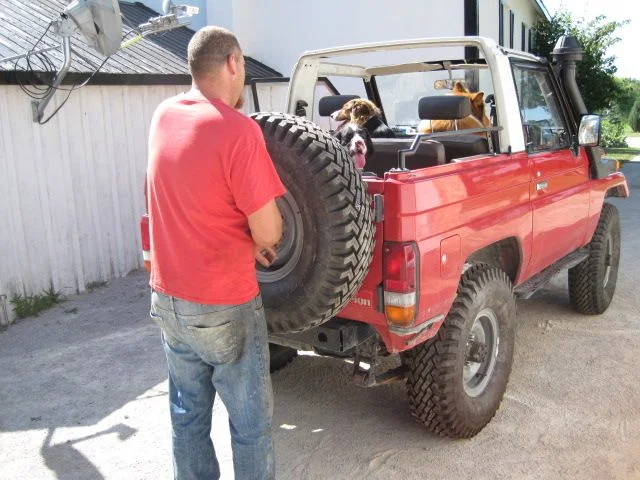

mounted the troopy tires on the PZJ70 ragtop and went for a drive.
very quiet for a lug tire
handled with one finger on the wheel
through very few stones on gravel roads.
has some sidewall flex but i am only running 40 psi
looks stock on a 2.5" lift.
will rub while turning on a bank but moving the axle ahead 1" will cure this concern.
all in all, i think i am in love.

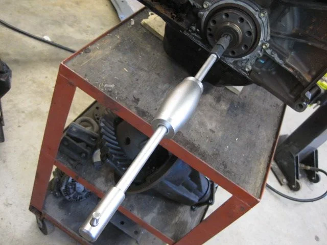

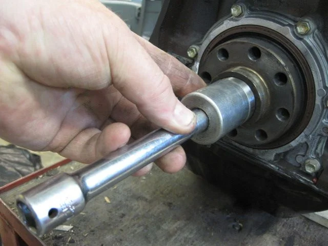

slide hammer to remove the old pilot bearing
find a socket that fits the OUTSIDE collar of the new pilot bearing.
tap in till flush.
done.

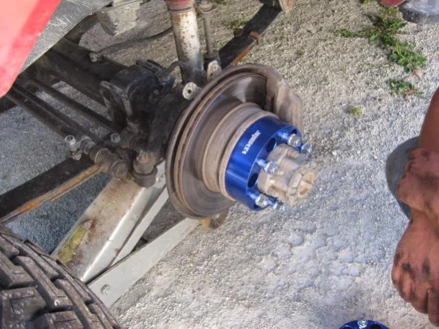

testing the spacers ...
an idea of the height of the truck with these tires, Mitch is 6'4" so they do raise the truck significantly.
but
the truck itself still rings of the stock look, most people would never know it isn't stock.
