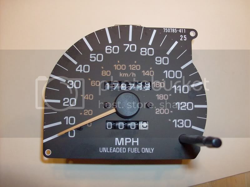

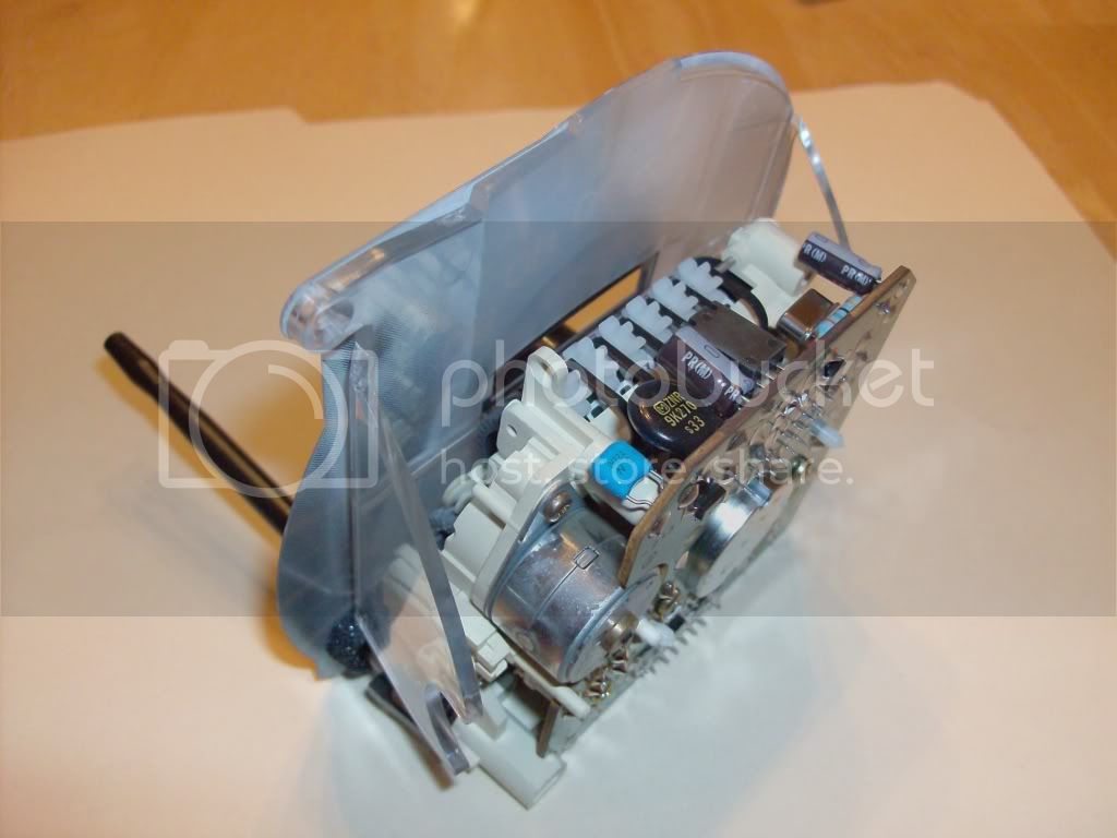

This was about as far as I got with mine:

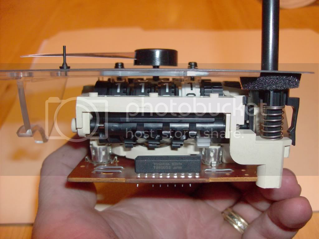

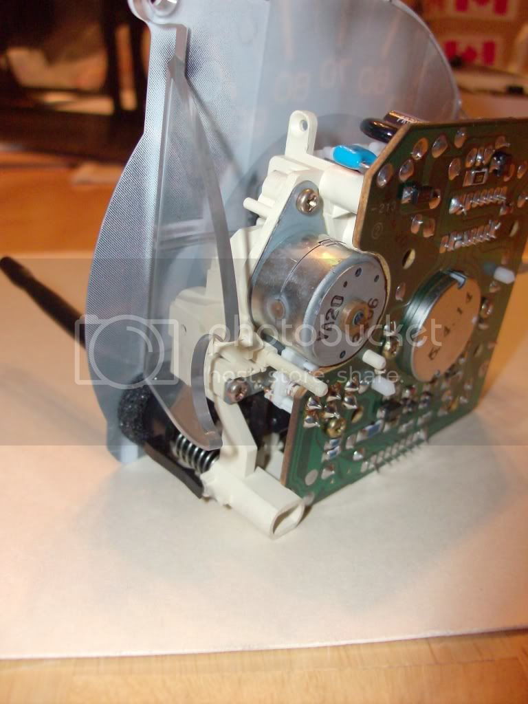

IIRC one issue was a piece of foam from around the reset post getting stuck in the gears and another issue was a broken very small plastic pawl.
Yes the trip meter is replaceable, but when mine broke, I couldn't find one. You'd most likely have to buy an entire gauge cluster with it included, but then you're still dealing with old brittle plastic bits, and the cluster is certainly more than a few dollars.
The connecting piece from the post on mine broke, and there were some tiny debris in the mechanism that prevented it from moving smoothly (probably bits of foam as mentioned above). I assume that extra resistance is what leads to the break. Cleaned, scuffed mating surfaces & glued it back together. You have to be delicate with it after the repair, and expect it to break again eventually. That said, I didn't go to town with the most robust repair possible, so I'm sure one could do it better.
