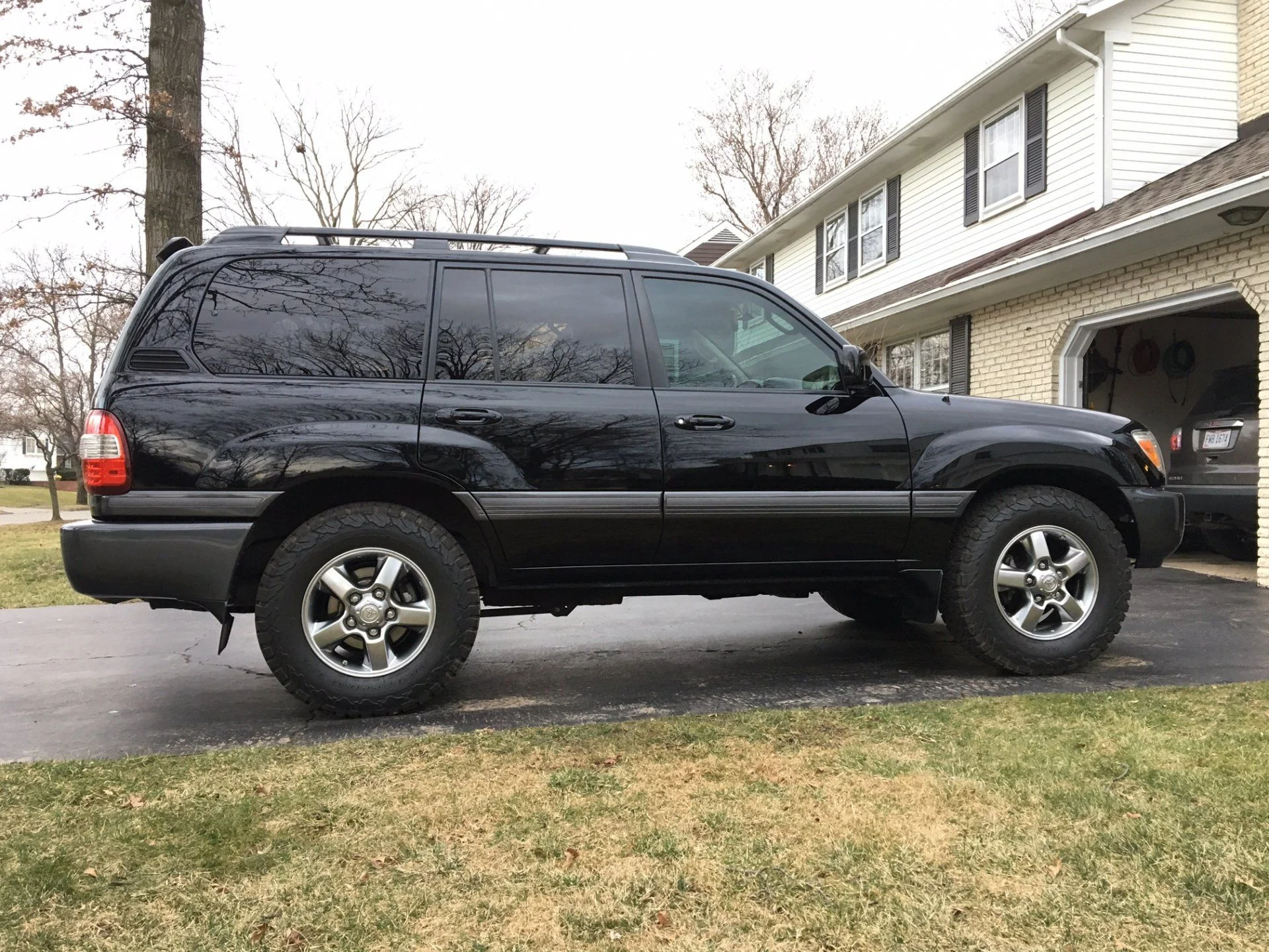

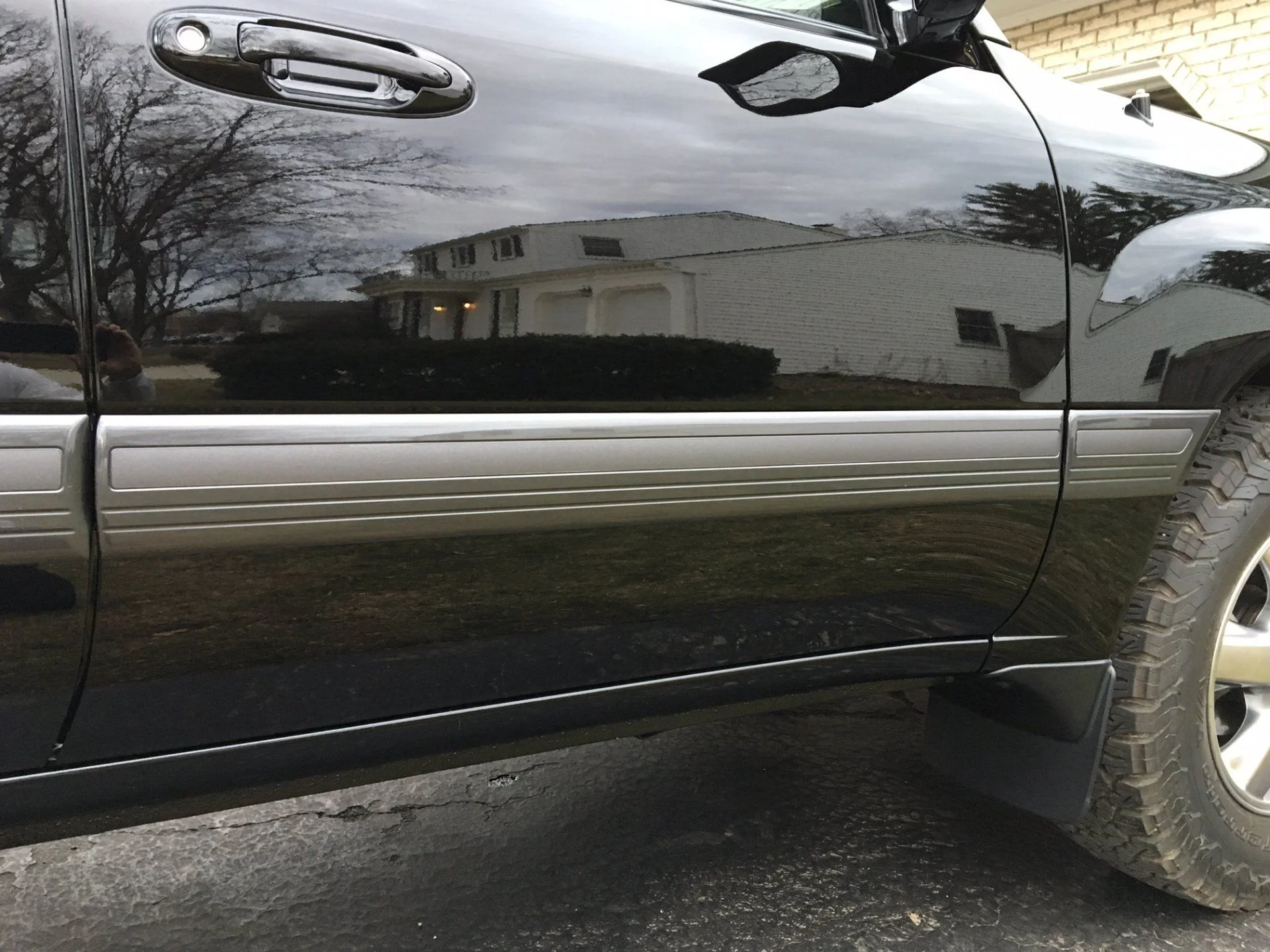

Finally got around to installing the M261 wrap on my trim. I cut the material into strips before installing then finished the ends with an xacto knife on the car. Completely satisfied with the results.
That looks really good @aging fleet
Any special tools needed besides a straight edge to cut the strips and an exacto knife? Any tips for someone who's never dealt with applying vinyl wrap?
Thanks
No special tools, the material was like a big sticker. What was key was having a flat surface and a long straight edge to help keep my cuts in line (used the xacto knife for this). I used painters to secure the vinyl wrap to my work surface to keep it from moving around while measuring and cutting.
Finishing the ends on the car was the most challenging part for me. I cut the curves freehand, sometimes it went well and other times it didn't. Some advice n55luvr gave me, practice on the smaller pieces of trim to minimize waste.

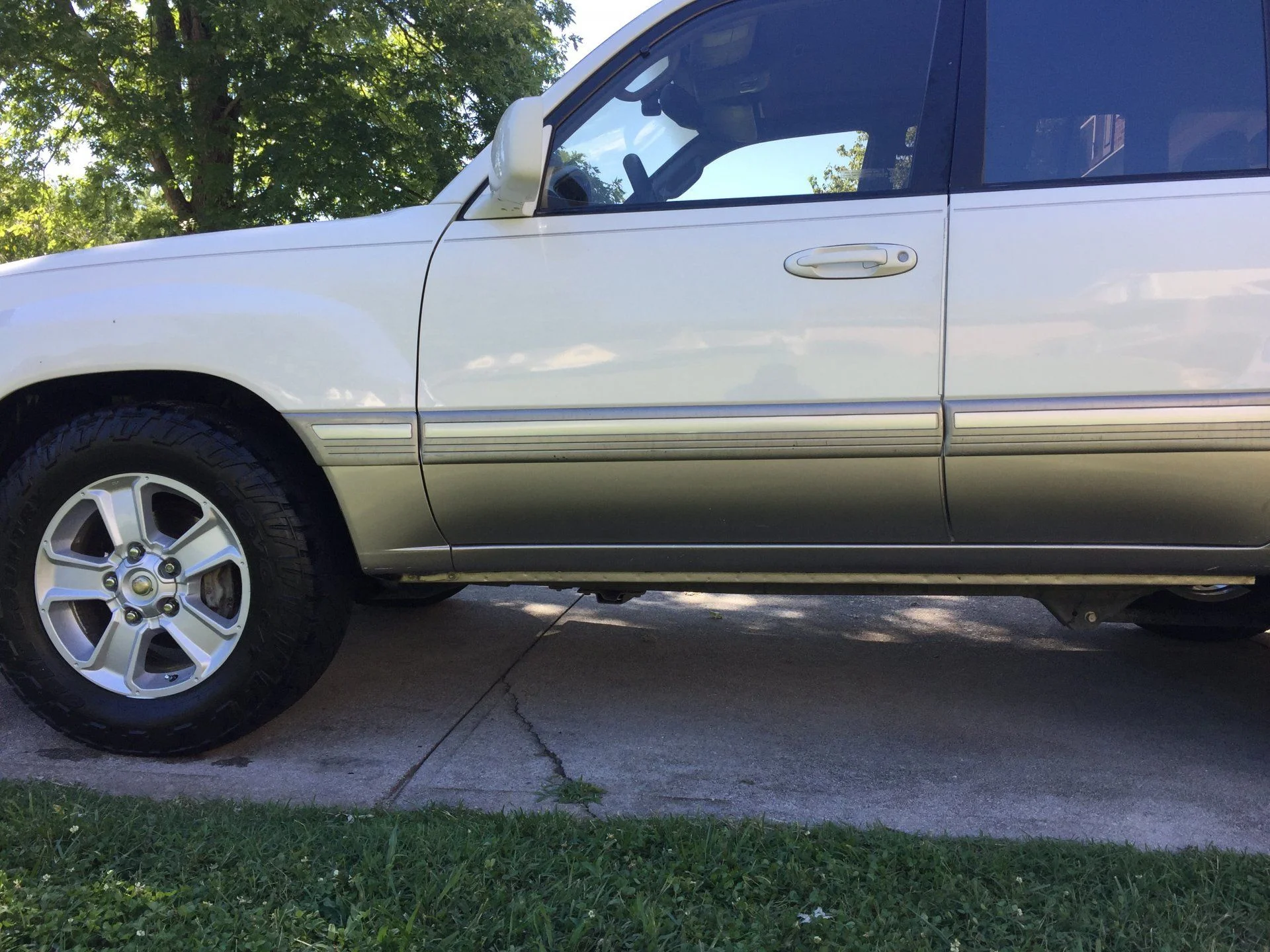

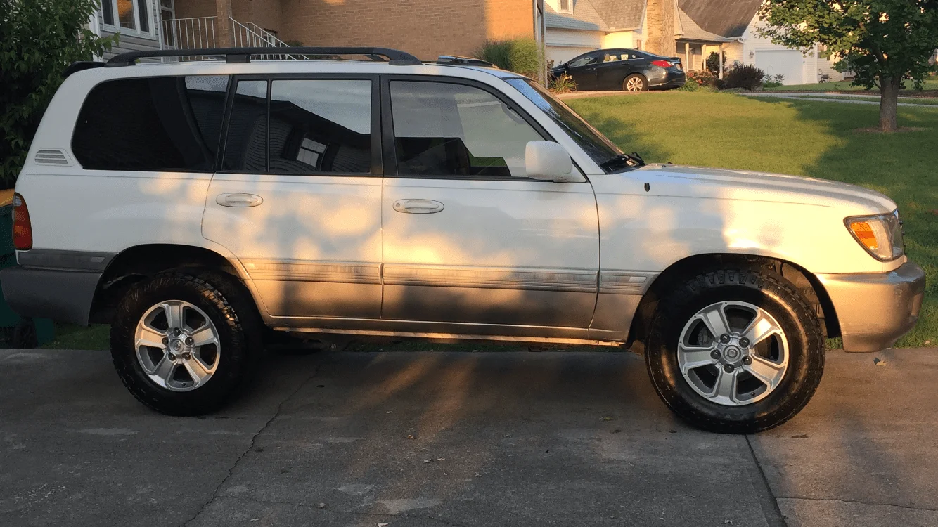

Anyone know what 3M vinyl code to match the Light Greyish Beige Metallic on my LC,
The center section looks terrible and I would rather try the vinyl first.
I know the Toyota code is UCA46.

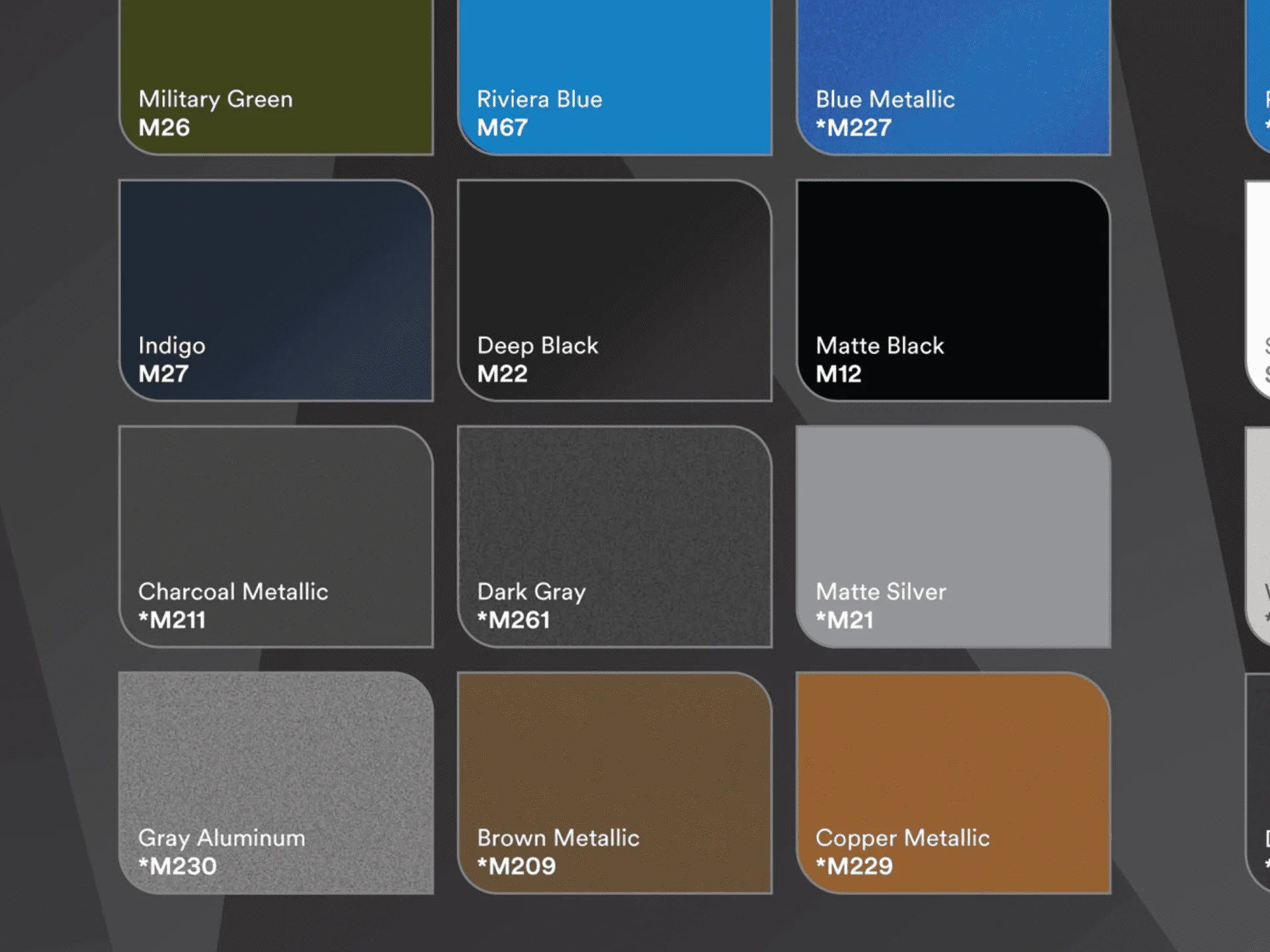

I'd rather not remove them and/or paint or spray anything if I can make the 3M look decent.

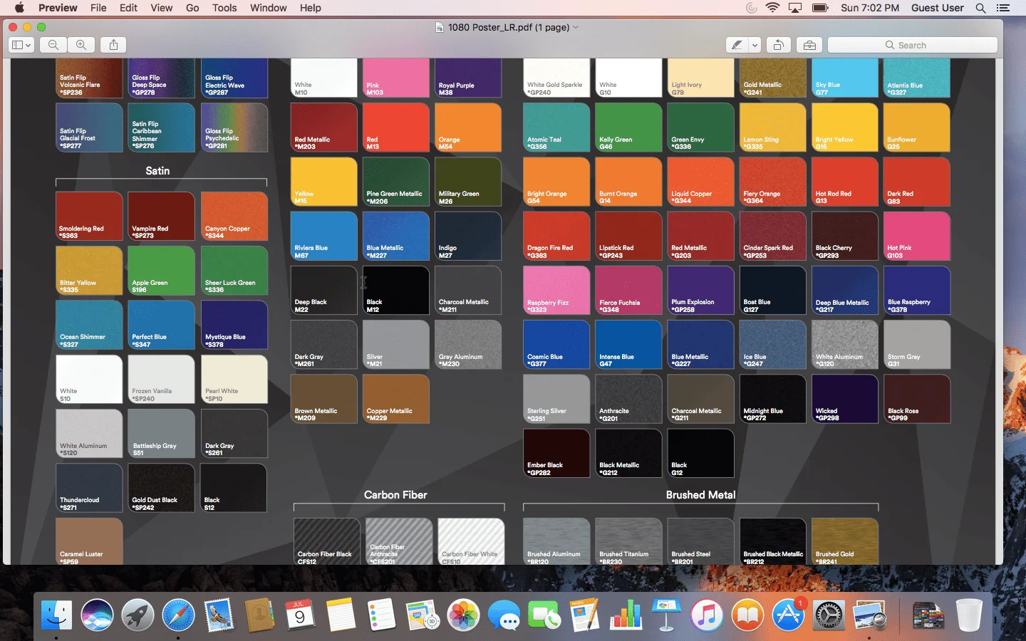

This is the 3m color chart, I'm not sure anything else would be worth a try.
really wish I had a local 3M rep with the color plates or samples to lay them against the trim to see real time.

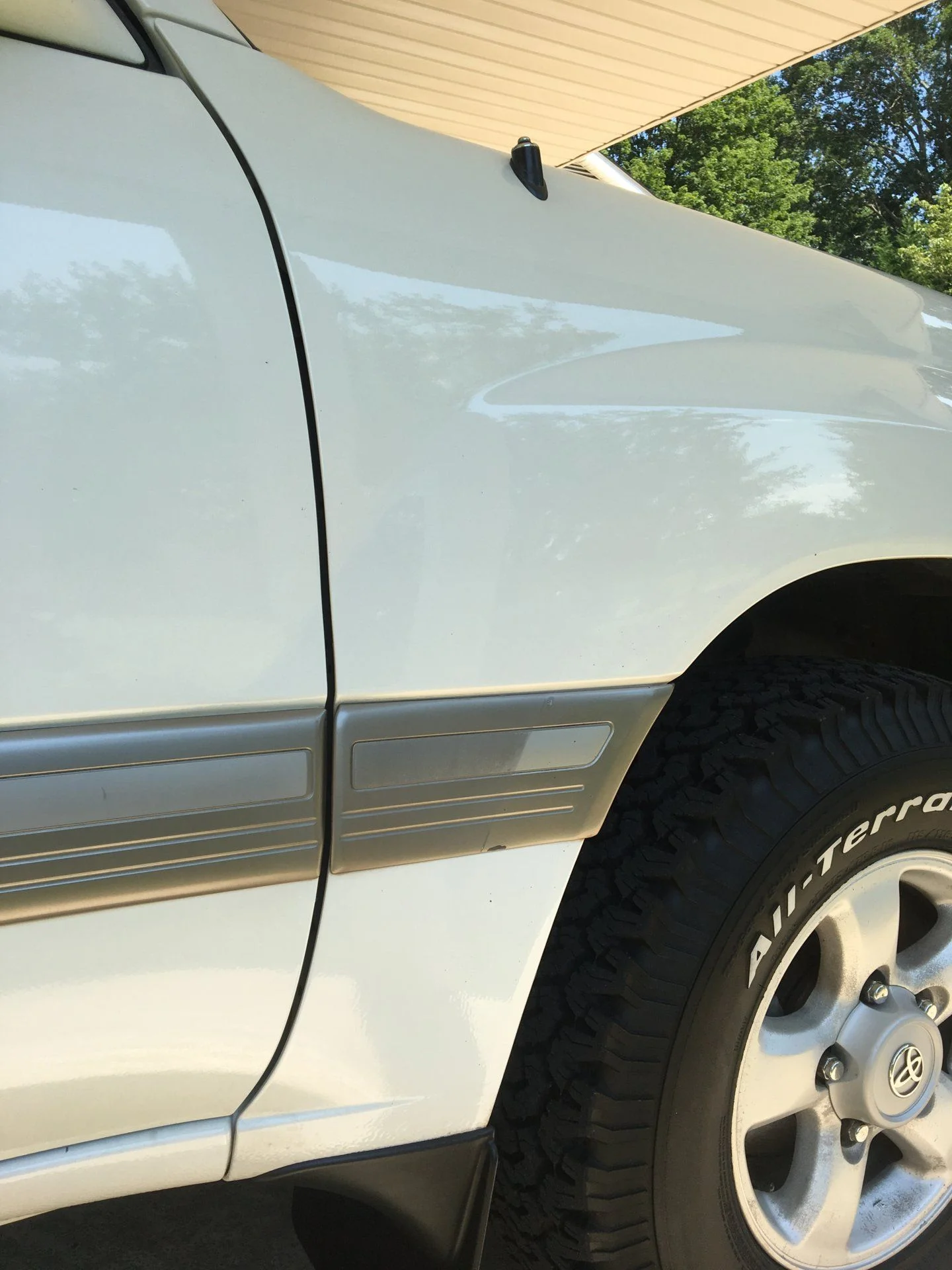

My post from the other thread so everyone can see what matches.

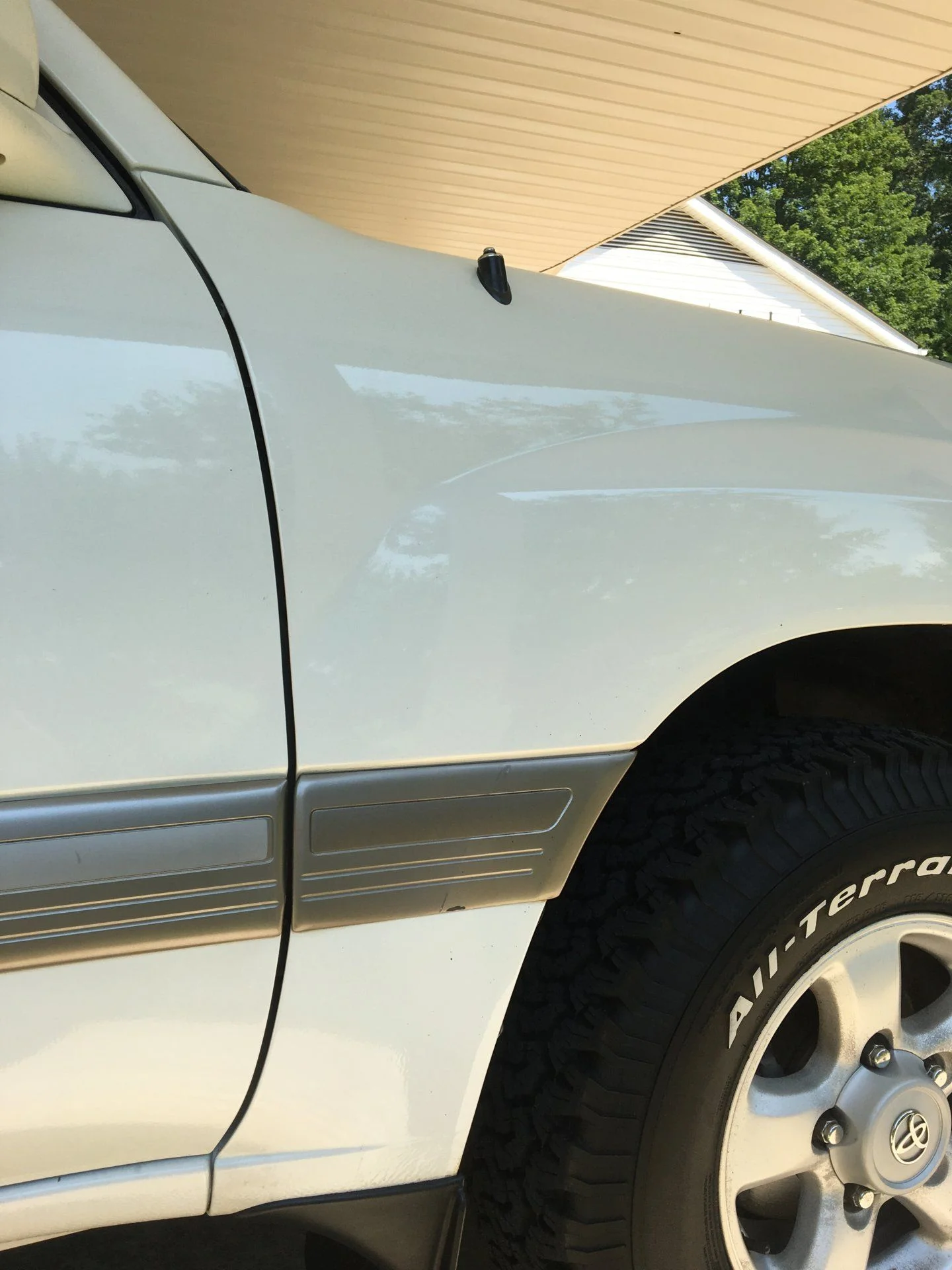

Well folks,
Turns out M230 Matte Grey Aluminum is absolutely fantastic on those mouldings that Toyota woul call color code UCA46, Light Greyish Beige Mettalic.
Wow I am tickled because I paid under 15 bucks and I'm doing it myself! :D
I did go pick up some brand-new X-Acto knife blades at the hobby shop a little while ago to help with the trimming.
Turns out that the sheet being 1'x5' works great. I cut barely over an 1-1/8" of which to test on the two front pieces because those are the short ones and I could sit down and go slow.
It's actually kind of nice because you can pull and if need be slightly stretch the vinyl as you slowly peel back the backing that covers the adhesive and you can form it into the corner where you need to and just take your time and slowly trim.
How about a before and after!
The slight line that you see on the after photo on the very front of the molding is a reflection.
img_0392-jpg.1500697
img_0393-jpg.1500699

Looks great. Does this match the original color of the center stripe of the trim or does it match the outside color of the trim. Hard to tell the exact color on my monitor. I plasti dipped the center of my trim and it looks fine. Been looking at options for the outside.
It matches the outside portion a lot better, kind of blends it in I think.

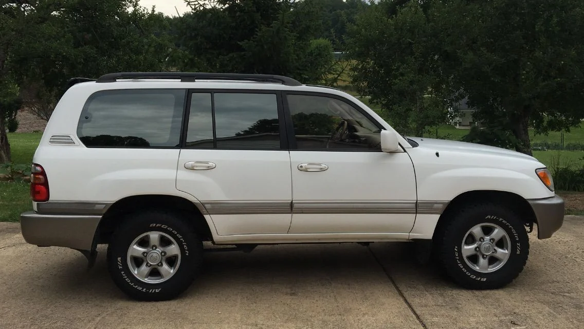

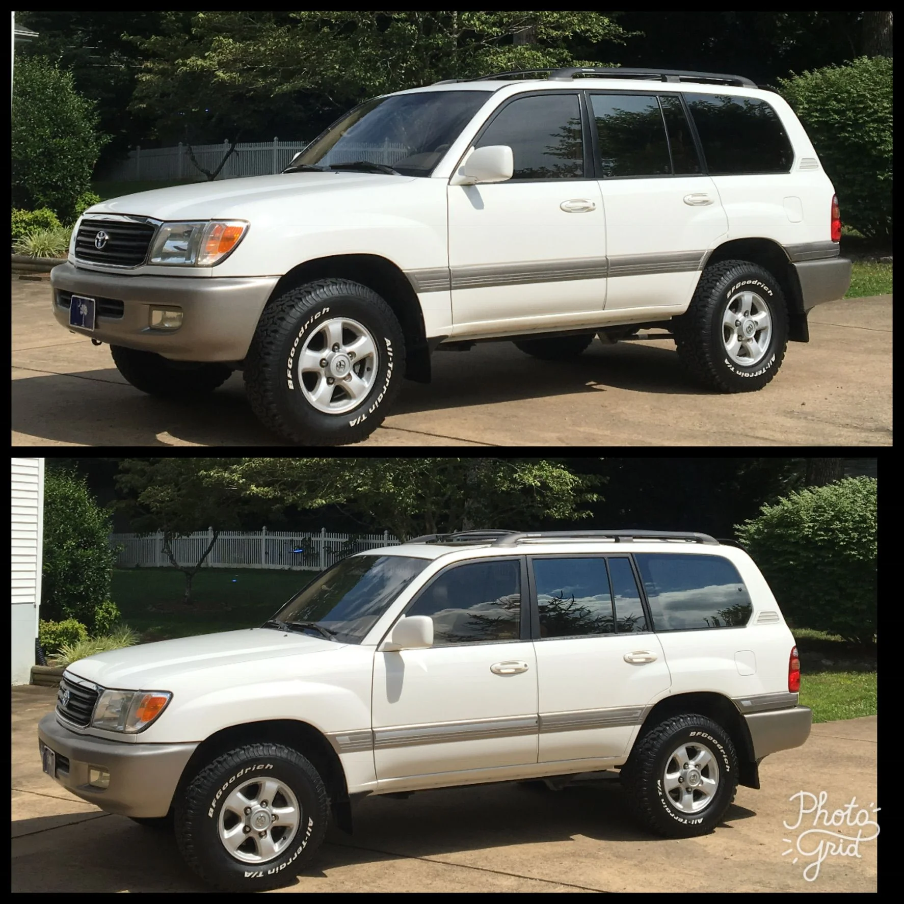

Here is a better pic of the whole rig, after on top, before on bottom...
Note the very silver looking sections that were under the flares that were next to new, then look at the after pic and see it's all a nice color almost.
Went w the 3M method to fixing faded center trim. Not bad at all, cutting edges was a lil difficult but all in all pretty easy.
