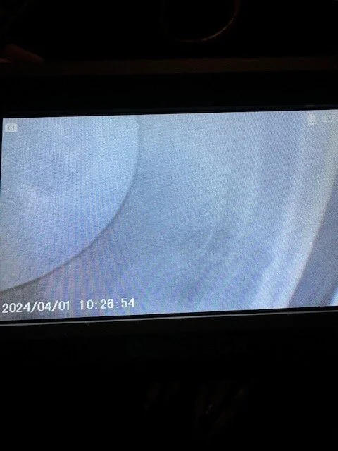

Okay, the engine. As stated, I bought it from SOR in 2000. Marv at SOR said it's likely from a Japanese fire truck and has 7-8k miles. I replaced the seals and gaskets and installed it along with the rebuilt transmission and transfer case. All three have sat dry since then. I'm convinced that if I can get the engine running that's all the motivation I'd need to see this thing through. The cylinders all look great through a borescope run through the spark plug holes, however, I cant budge the crank pulley. I'm thinking I should squirt some oil around each piston circumference first, but, once I do, should this thing turn freely by the crank pulley or is there something else I should do before trying? Thanks again in advance.

That last pic is cylinder 3 (or 4 depending on which direction you’re supposed to count from).

Hey you have a garage, much nicer than my dirt (this time of year mud) open air parking spot. That bore look's spiffy to me.
Thanks, that gives me some confidence this thing may be salvageable. Thanks also for the advice in the other reply. Unfortunately it’ll be hard to rock back and forth as the Buckshots that were new when I bought it have given up the ghost but I WILL give the Marvel Mystery Oil a look-see.
