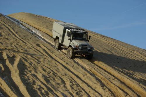

if you would use 7.5 R16 and Nissan rims you might not need the widening of the fenders. Have a look throug the thread, I posted pics from another german yellow HDJ80/45 build with the Nissan rims and 9.00 tires.(that won´t fit, see pics beow in the links)
I don´t know if you could go without the lift,...but if your are willing to rebuilt some mounts , I think it should work.

Hi Soenke,
I am actually drawing some sketches for my future build.
Can you tell me more about the operating clearance left between the wall and the roof ?
Did you use some plastic (PEHD) pads (if yes wich thickness and wich clearance left then ) in the corners to help the roof to slip easily ?
Thanks for your precious help.

If you were to do this again (and money and time was not a problem) what would you consider doing differently? V8 diesel? Cab and Camper joined together? Side doors?
Casper
thanks guys,
I ám not shure what to change ...
Maybe bulding the cabin in carbon, it will make it lighter about 150kg.
Maybe stretching the frame abut 30cm to have the space with a less wide body an cabin, using tires 9.00 and sleeping head in front,
maybe building new mounts for engine and gearbox, using selfmade shafts...in order to get the frontaxle in the right J4 position...
but every point will have disadvantages for us too...
you´ll find out your way..:cheers:

it is a 1993 HDJ 80 with manual gearbox, changed to 12V alternator and starter from the HDJ 100, australian clutch (like the one from the later 24v 80), copper radiator from HZJ75, 4.5:1 Diffs from PZJ75, HT rallye Suspension, 325/80 R16 Cooper on Alcoa 8" rims, reinforced front axle, 2x about 200l diesel in alu tanks underfloor and 2x about 60l water in V4A tanks underneath the seats......
