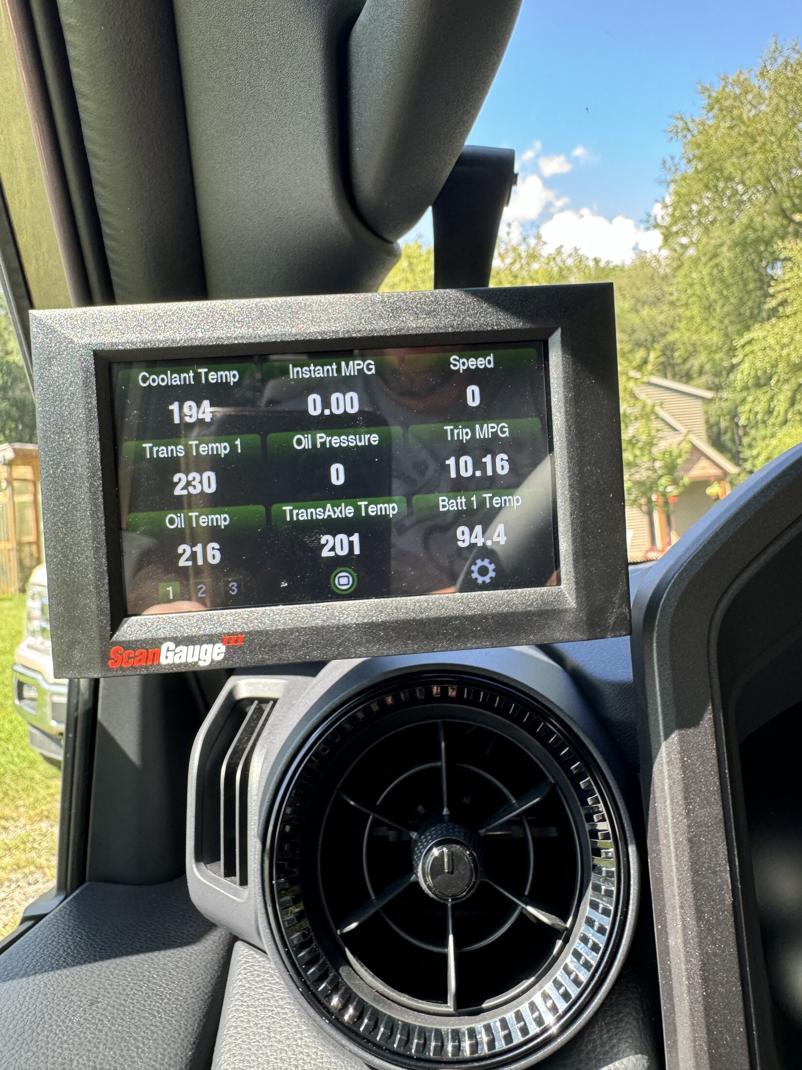

Similar concerns for towing our 2,800lbs teardrop in mountains. Will be curious to see what additional cooling options are available.I run a scan guage and this is after towing my 5k camper 2.5 hours. Too hot for my liking and I’m planning to tow cross country in the future so think an extra cooler is in order. View attachment 3751887View attachment 3751888
Are you thinking 230 is too high?I run a scan guage and this is after towing my 5k camper 2.5 hours. Too hot for my liking and I’m planning to tow cross country in the future so think an extra cooler is in order. View attachment 3751887View attachment 3751888
I guess I was just worried about it being that hot on a short trip in relatively flat Pennsylvania, Towing cross country up mountain passes is what worries me, but maybe you are correct and that isn't hot at all.Are you thinking 230 is too high?

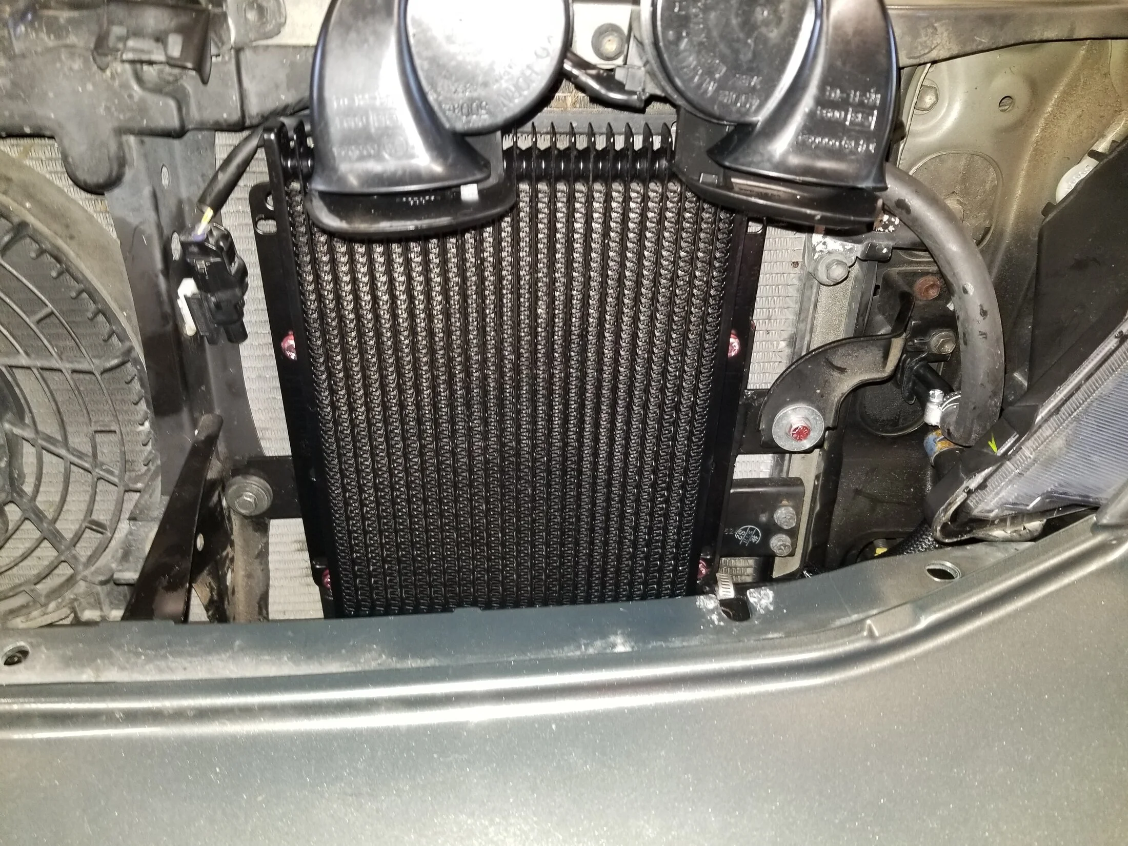

For my 120-platform rig, I've added a larger external cooler (Hayden 678), installed a Nomad valve body and lockup switch, and changed to synthetic Valvoline MaxLIfe AFT. My trans usually runs 170-180F and has never gotten above 220F after those mods, and that was in some rather extreme conditions.
If I were to buy a LC250 (or a GX460 for that matter) I would figure out a way to mount a Hayden 678 or similarly-sized auxiliary cooler. I can't imagine a replacement 8-speed trans with hybrid integration to be cheap to replace. The cooler itself is only $60 - same price as 5 quarts of Toyota WS!

You need a WAT lockup switchDepends if 230 is pan or torque converter. On my 200 I see a stable temp of about 217F when towing, pan and torque converter. If the torque converter unlocks it’ll easily run 230-240 and I don’t see it as a big deal if the pan temp is lower and stable because this is hot fluid coming out of the transmission but is being cooled ok. I don’t start to worry about temps until the pan starts getting up to 250F, which I’ve only seen on the highway on Vail pass with a 6000# trailer in tow in sunmer

217 is hotter than I'd like to personally run. If that was my rig I'd splice in a bigger cooler or change the fluid every 30K.

The 200 has both a liquid and air cooled radiator. But @TeCKis300 has a thread that shows how he installed a third cooler (second air cooled radiator) if you search around the forum a bitFollowing this closely as I live in Tucson and am planning on towing our Airstream Basecamp (3500# max) up to Ten Sleep Wyoming and into the Bighorn mountains (~9,500') with the wife's LC 250.
I see that these vehicles do have a transmission oil cooler, but given that it is a liquid to liquid cooler using the antifreeze which will be 180-190, I would much prefer an auxiliary cooler since the air is much cooler than the engine coolant.
