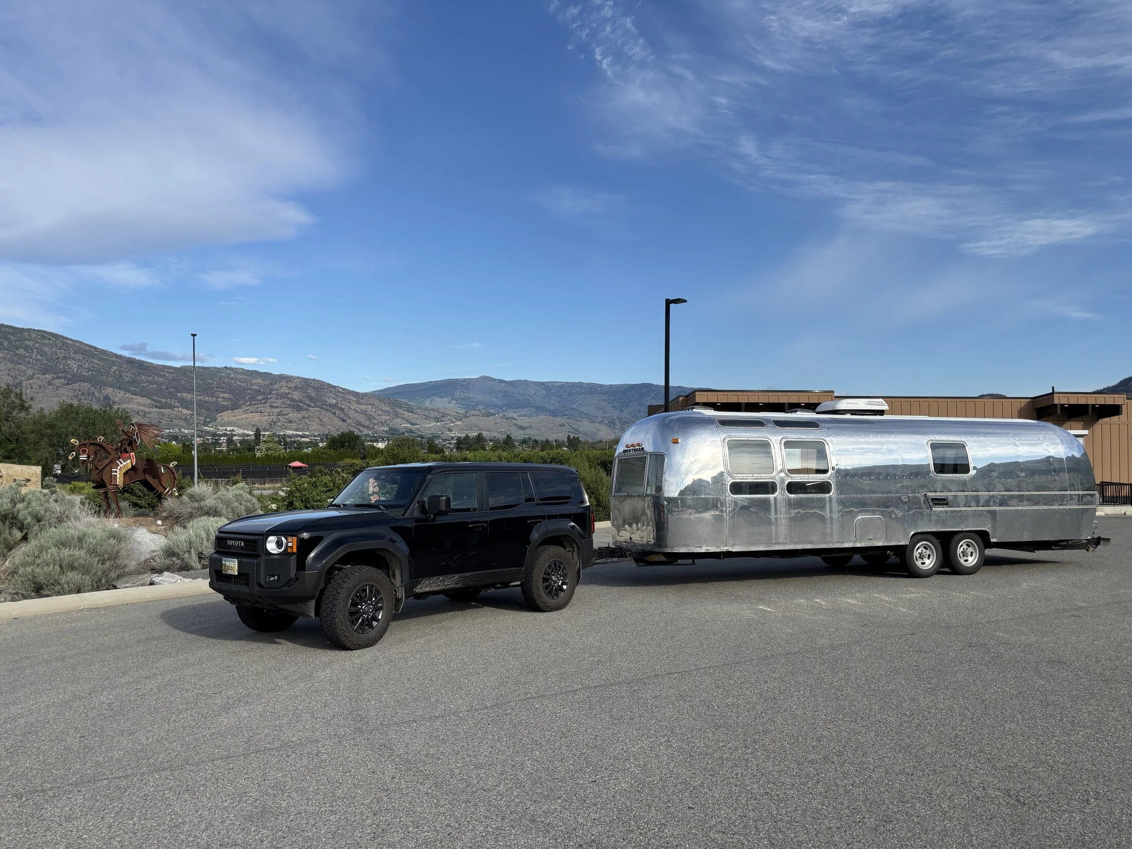

I towed a customers 31’ Airstream over 4 significant passes here in B.C. on Monday. Trans temp never went up at all…
