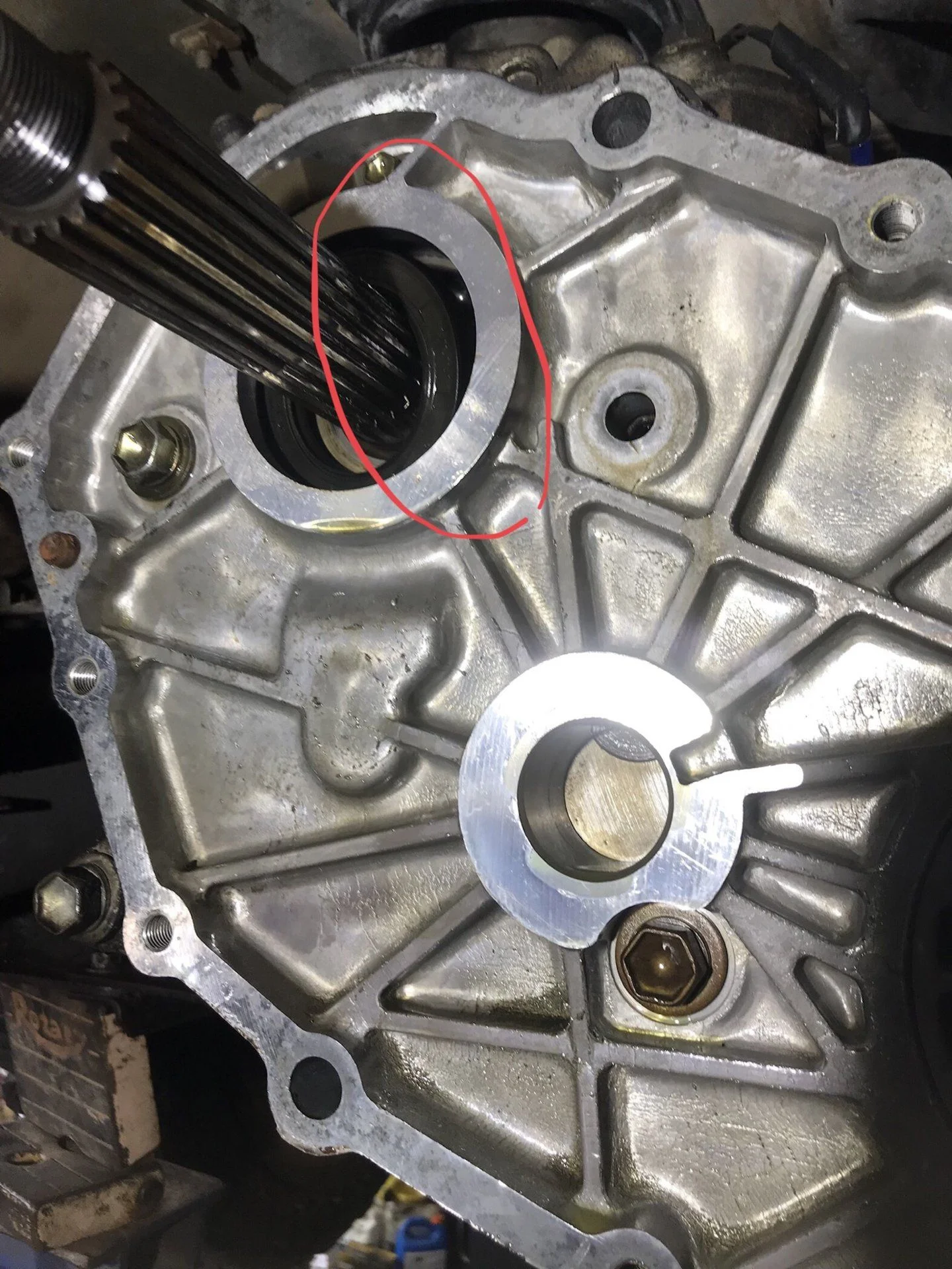

I noticed notchy shifts on the trans and went to replace all driveline fluids. Got a little soaked when cracked the TC fill plug. Here is what my seal looked like when I went in for a TC rebuild to remedy.
Yup thats a complete seal failure.
