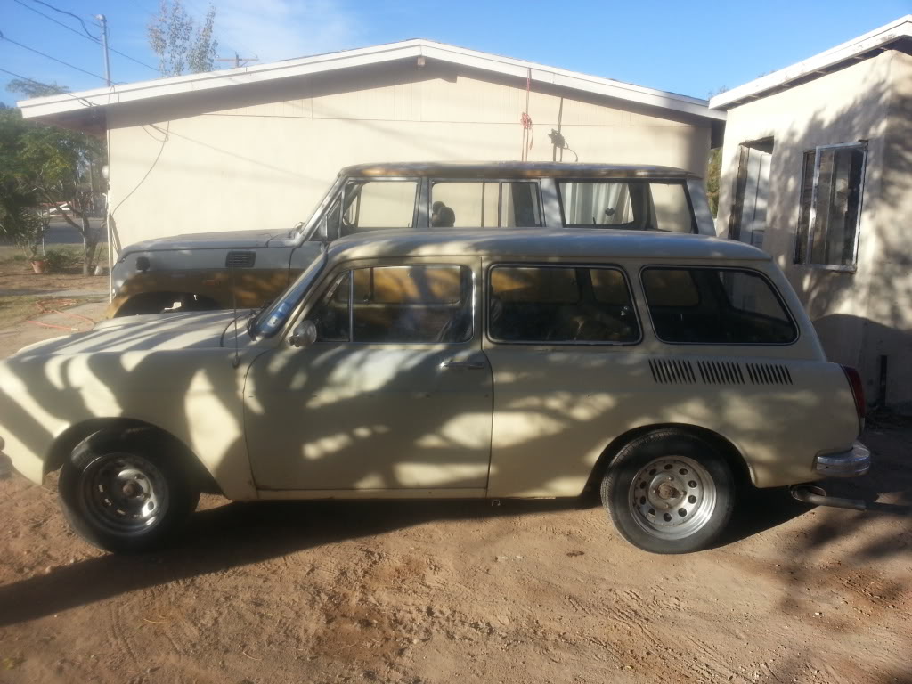

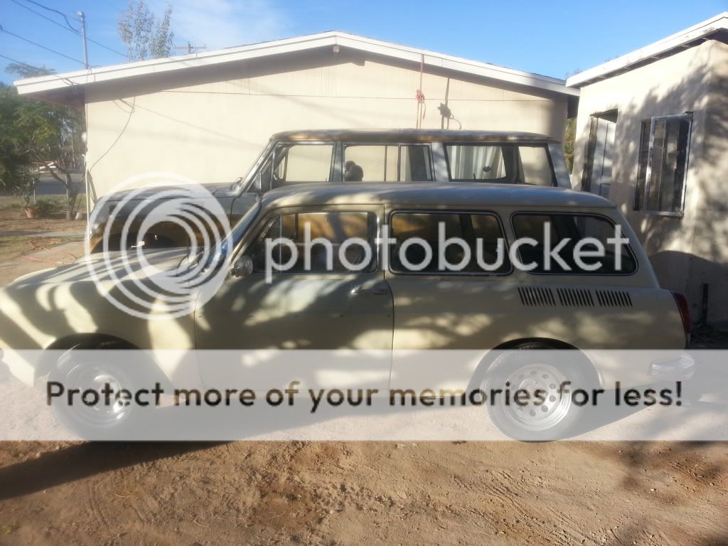

Below is my daily driver, she is loud, cold, she smells, and eats up gas like i didnt think it would, but I wouldnt change her.
