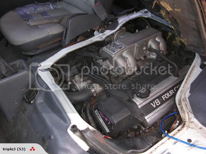

The engine room is somewhat spacy, but not so easy and not unlimited in height. The reason, you sit on top of the engine :P
Just to give an idea about the engine compartment. In this case a V8 which was only standard in the rare ambulance version...
