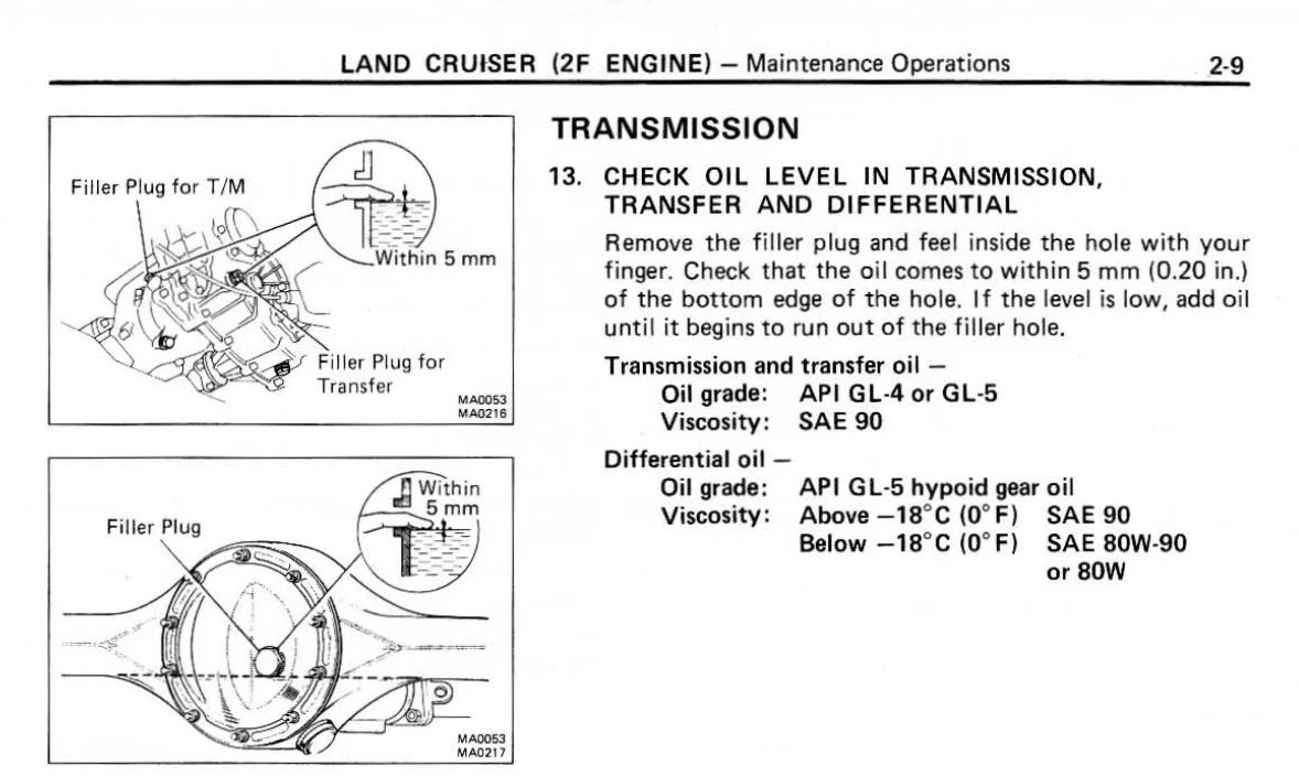

A straight gl5 in these would be about the worst thing you could do....mud water would be a better option.
This is from the 1986 Land Cruiser maintenance Procedures:
interesting.
its generally stated the gl5 is bad for yellow metal
This is why I am inquiring. Maint. manual says GL-5. People on here say stay away from it. I’ve searched the forum, I haven’t reached the inner bowls yet, but I’m not finding anything definitive. But the mud water suggestion was very helpful.
I generally stay GL5 in the Diffs, no yellow syncros and easier to find GL5 Mobil 1 that's formulated for higher shock loads, then I use GL4 for the Trans and T'case (sta lube or GL4 synthetics in the 5 spd).
The main difference btwn GL4 and GL5 (modern) is the amount of EP additive. GL5 is generally not recommended for a gearbox because the high amounts of EP additive for shock loads - usually Sulphur and Phos compounds that don't play nice with yellow metals.
