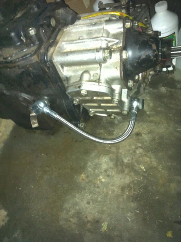

and if oil comes out of the transmission fill plug that's not good. The transfer case front seal is gone. 500 other people have found a hose I now sell lets that oil drain back into the transfer case. Check out this thread from classifieds.
Shipmag
Hagler Technology LLC
Ordered a 12.75. Looks like a super slick design. shipmag was great to work with!

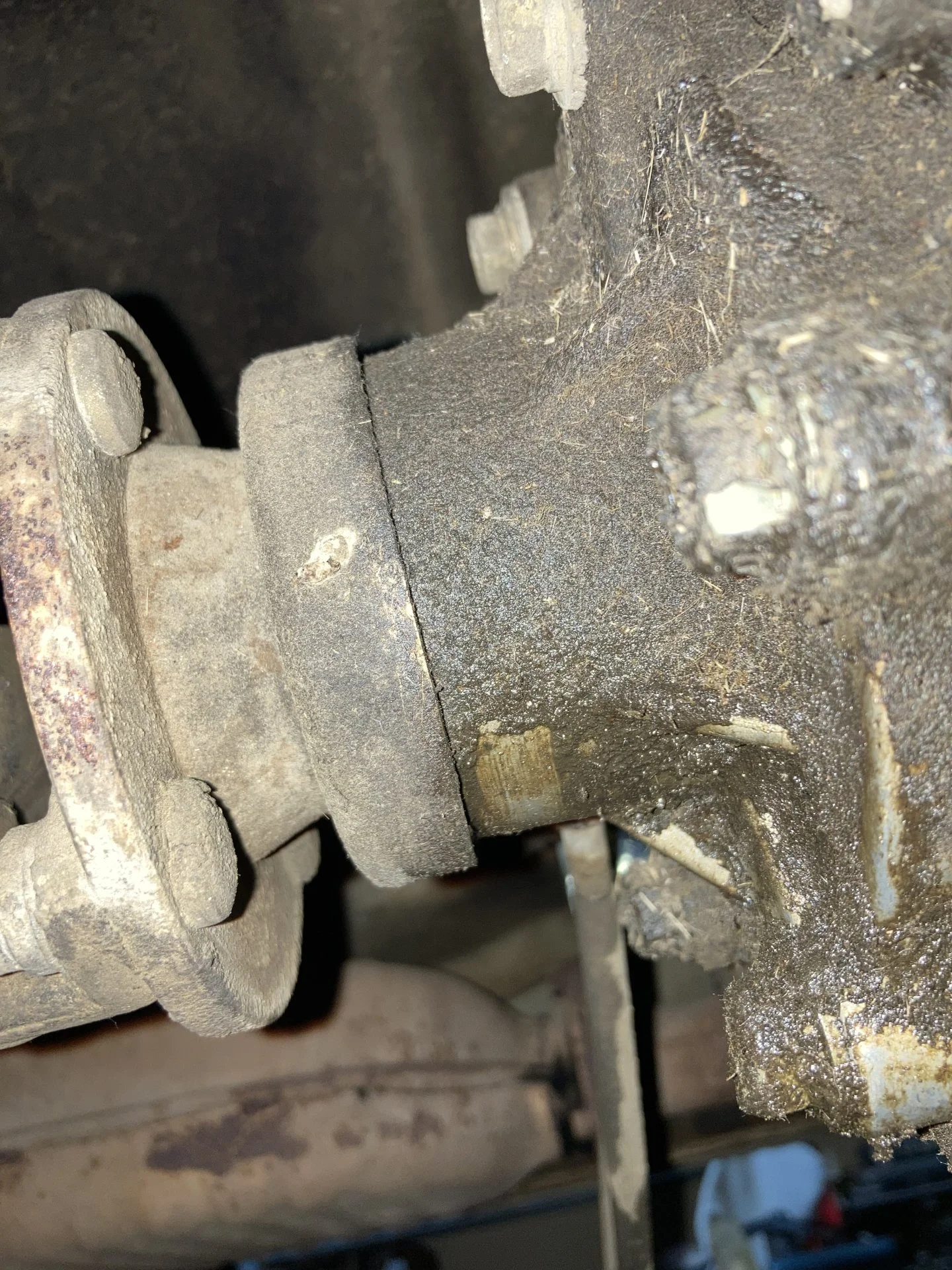

I was able to drain and fill both differentials, t-case and tranny fluid but now have a leak that wasn’t there before at what I think is the transfer case oil seal. Is it something that may stop or if it’s leaking is the seal shot? Thanks for any help!
Your fluid was probably too low before to make it leak fresh. I wouldnt wait for the leak to stop it may be a sign of something that needs to be addressed.
Even though it may be unlikely I would first verify the bearing is okay in the output flange. there should be absolutely no play in the left/right - up/down - in/out of the flange. Some rotational play is okay. If all is well then its probably just a seal. It can be a PITA but its doable. I got parts from @cruiseroutfit awhile ago and did this same job.
I would buy a new stake nut while your in there
@ChaserFJ60 thanks for the info!!!! Makes sense about the fluid level. I will do some searching for a thread on this maintenance.
That is the transfer case oil seal correct? Just want to make sure I am searching for the correct part and a thread on how to do it!
Thanks
The transfer case has a front and rear rotating seal associated with each output shaft. The one you show looks like the front, but it's hard to tell from your picture. If you drive around mostly in 2wd, the front drive shaft doesn't turn so much and that seal may develop a flat spot. You could try locking both wheel hubs (this will make the front differential and drive shaft rotate, even though you are in 2wd). Having the shaft rotate may make the leak go away or make it worse.
Clean the transfer case around the seal. drive around some with the wheel hubs locked and monitor the leak. If you need to replace the seal, the instructions are attached.
It doesn't seem too hard. You will need a way to hold the companion flange from rotating while you remove the lock nut. the SST shown is just a metal bar with holes so it can bolt onto the companion flange.
You might be able to carefully pry the seal out with a flat screw driver or pry bar. Seal driver kits can be found cheap at harbor freight or probably on amazon.
