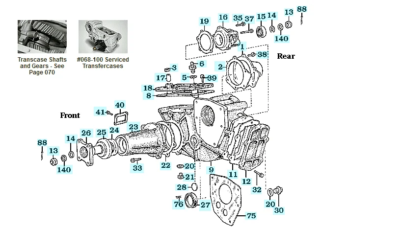

Quick question: Does the seal for the Rear output shaft "seal" around the Parking brake Drum? Thanks. I had a seal replaced and there are grooves worn in what I thought (did not take a picture) was the parking brake drum. Or is it this part 26 in picture?
I only see the front Part (26) and not one for the rear. Hence my question about where the seal. Wish I had my phone.
