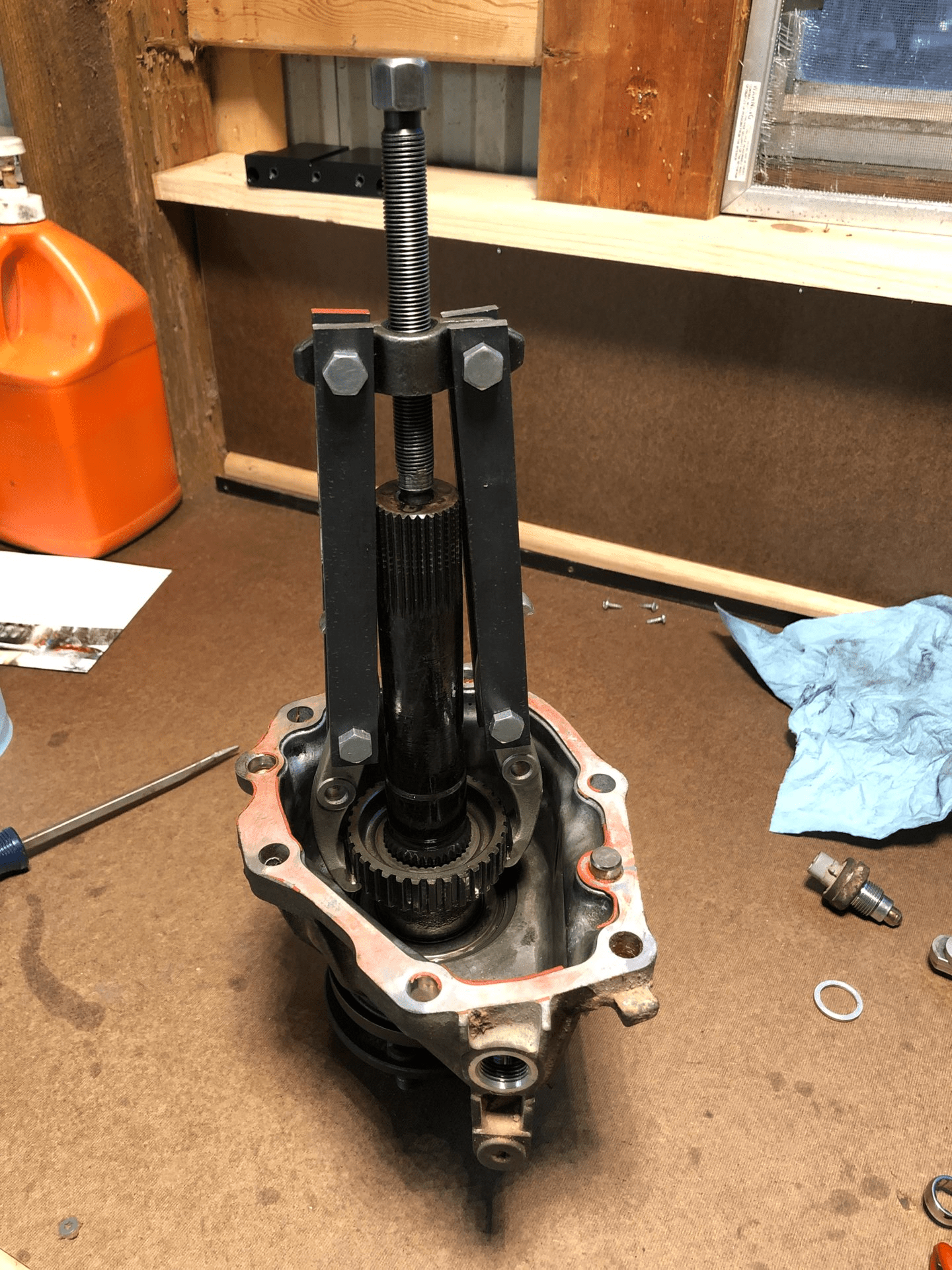

FYI, For the front output shaft I had to extend my puller to give it enough reach into the space. Other than that both the front and rear aren’t too bad if you have the right tools

FYI, For the front output shaft I had to extend my puller to give it enough reach into the space. Other than that both the front and rear aren’t too bad if you have the right tools View attachment 2637588
That is simple genius right there! Very smart, good job.

chap79: which size/length steel bars did you use to extend your puller and where did you buy it, Lowes's?
