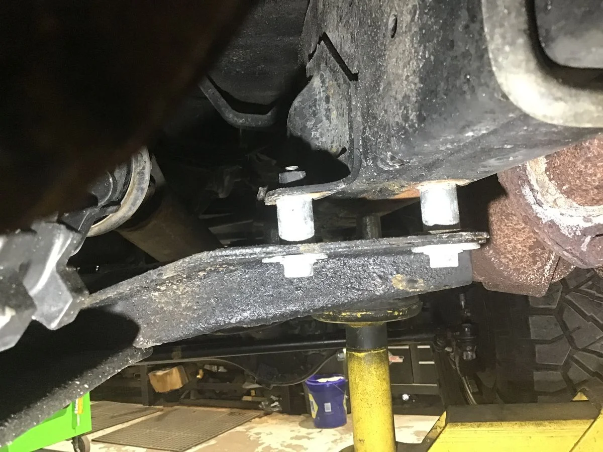

Anyone ever seen this? Any idea what the purpose or thought behind it would be?
Usually it’s from someone trying to avoid buying a DC driveshaft. Delete them
An incorrect attempt at correcting pinion angle on the driveshaft. It also messes with the fan shroud, hose connections, wiring harnesses.......
Yes, delete them and correct the angles properly.
Yup, I used solid 1" thick aluminum plate when I was troubleshooting my drive shaft angle issues. Wouldn't trust those sad little guys.
