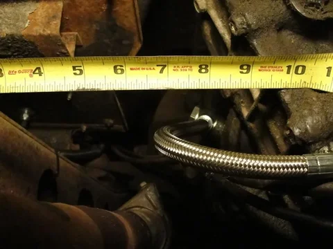

The 12.75 length hose is for stock 4 speed transmission and a one piece transfer case. To be sure it fits your drive train i would recommend you measure the distance from the center of the transfer case and transmission to make sure it fits.
1977 fj 40 4spd
P.M. sent 1977 pic. measured 13" so 12.75" should do the trick. Excellent work and thanks for your time.
Got my hose and found some time to get ur on... very nice job thanks again fits great.
the hose is a little stiff but can be moved if you wanted more room. clears beautifully. Got to add also even with a new seal, its a good protection to have anyway, not hurting anything, Great advice (from page 1) thank you...
