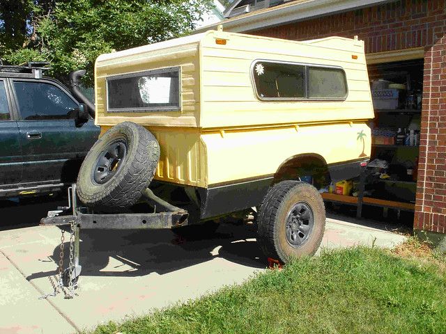

Mine is an older Datsun truck bed…. Tows perfect, wheels fine. Still has the original diff; re-arched springs with added leaf for load carrying; shocks and 33' BFG's.
Mark - that looks sweet - did you do all the extra slides/units (pic behind the van)?
GS - yours looks very similar to mine right now. Just need a rigid light cover as a lid and then some sort of rack for RTT

Heavy? I was concerned when I bought mine, but when I need to put it on jack stands, I can lift it - unloaded of course. Still has the Toyota axle and original shocks under it. I've had a number of utility trailers, and this by far rides the best, on and off road. I only miss a utility trailer when it comes to needing to get my golf cart somewhere.
My Toyota bed trailer
