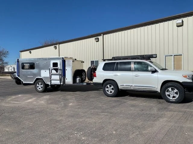

Just built these prototypes. Looks like we are gonna build 4 more in Jan. It fits lots of your needs. PM me for details
I can give you lots of feedback on our builds
