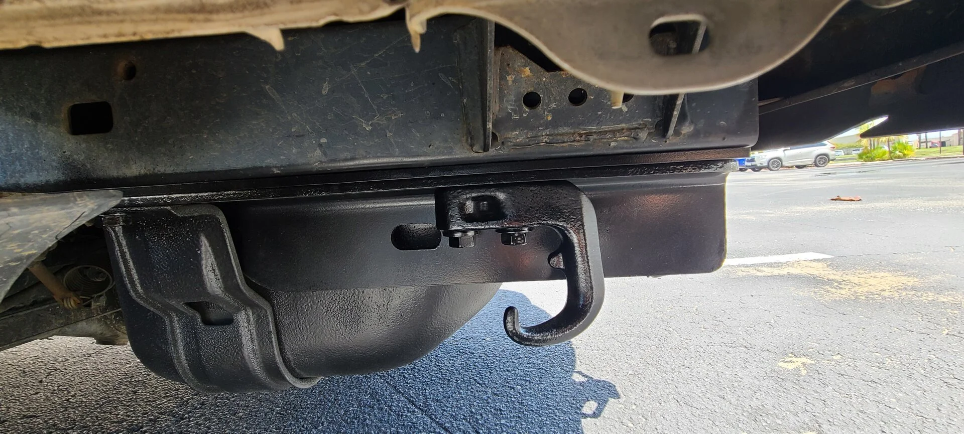

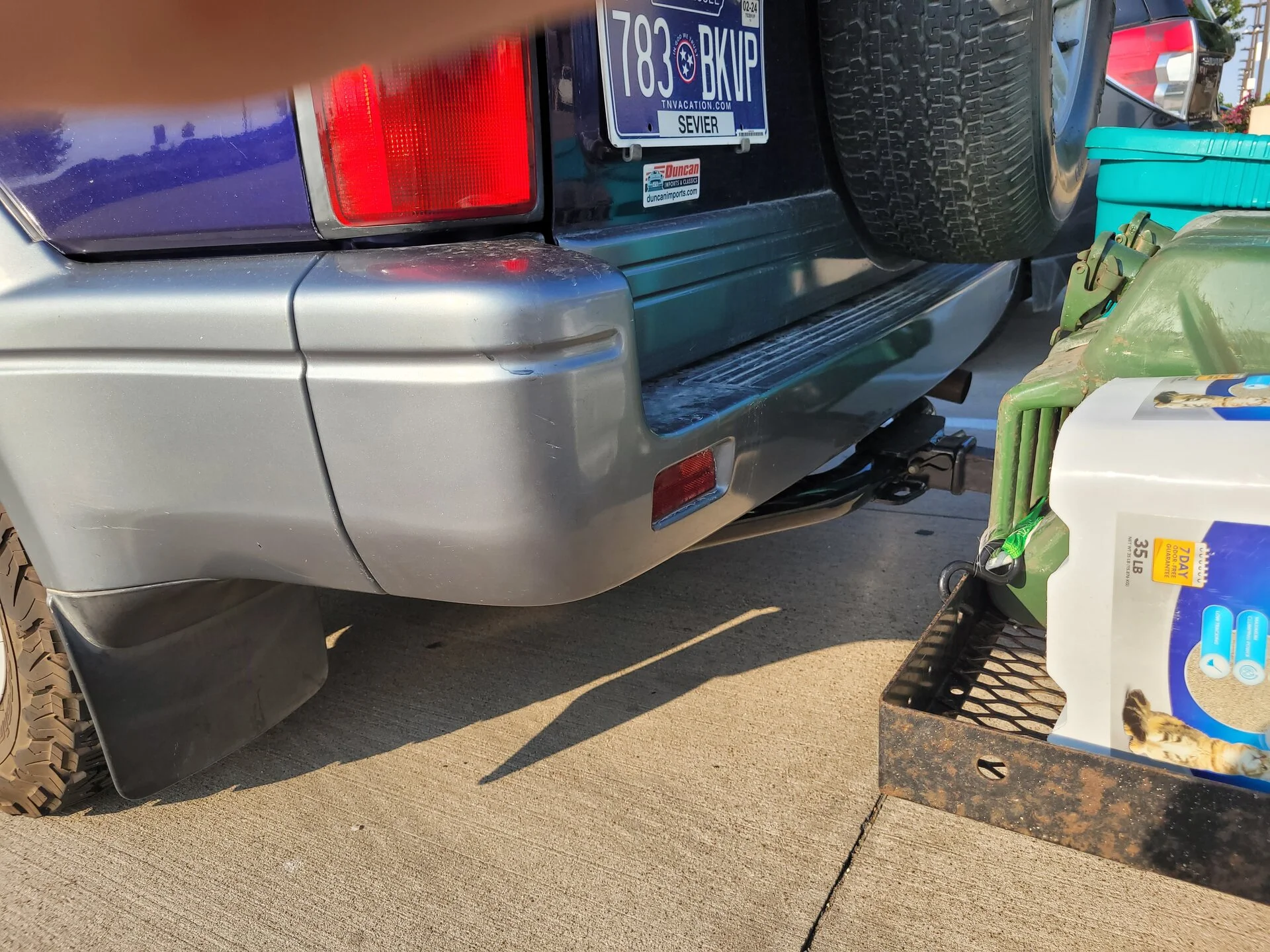

I installed this hitch and only had to trim the brackets to get them into the frame rails. We were moving at the time so I didn’t take any pictures of the install. Had to pull the exhaust to the side with a ratchet strap through the wheel, trim brackets to clear some burrs or other obstruction inside the frame rails, used some washers on the back bolts as spacers for an offset or weld bead. Rock solid after hauling a rickety old cargo shelf cross country full of cat litter and Jerry cans.
I've just received my curt hitch receiver. I was hoping somebody here would be able to post photos of their installed hitch to give me a better understanding of how it should sit. I see how the crossmember hinders the insertion of the bracket. I'm confused as to how the hitch sits on the frame due to the crossmember folding onto the bottom of the frame.
This is how mine looks. The bar with the weld nuts sticks out the back of the frame slightly so I stacked a few washers to add thickness where the frame rail ended. Don’t have pictures of the trimming (of the flat bars not the frame) needed to get the bars with the weld nuts to sit in the frame rails, but it was not bad. Cut off disc or bench grinder would get it done. Had to tap some of the factory threads to get the paint out of them. This setup pulled a trailer from basically Mexico to North Carolina.
