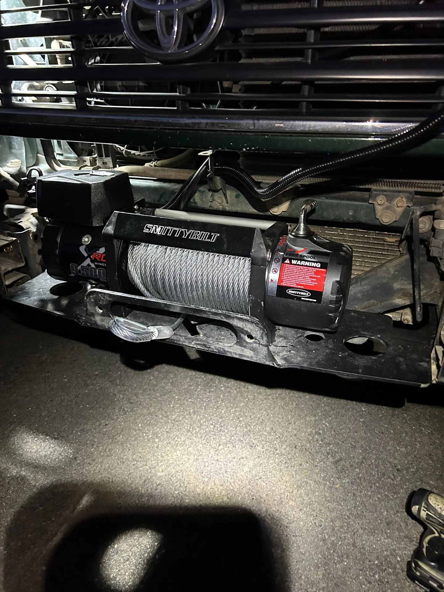

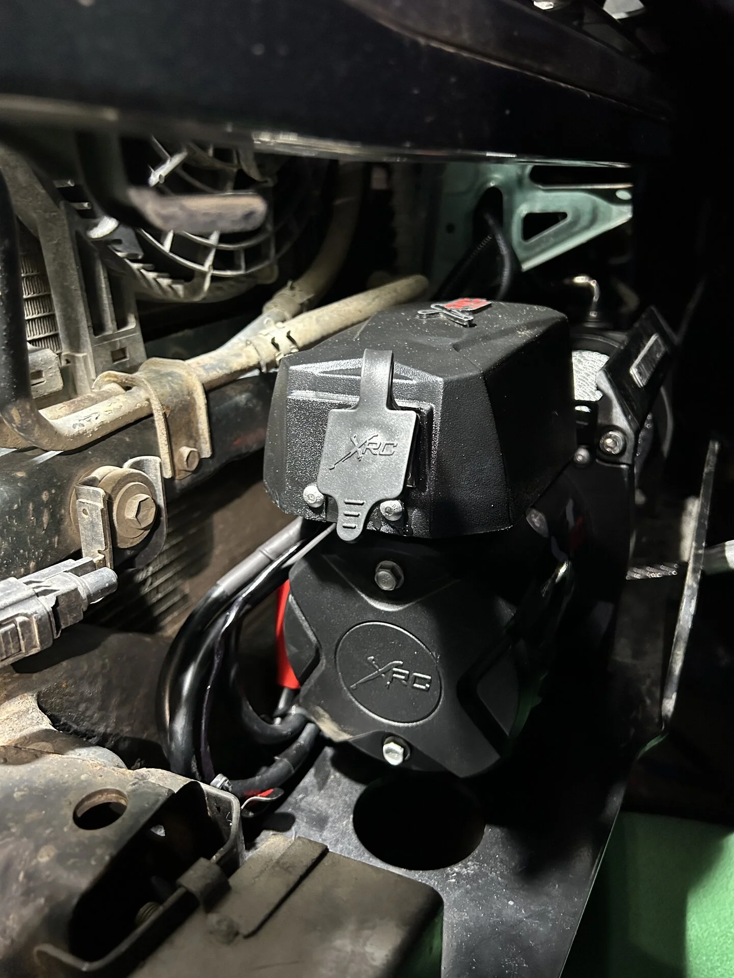

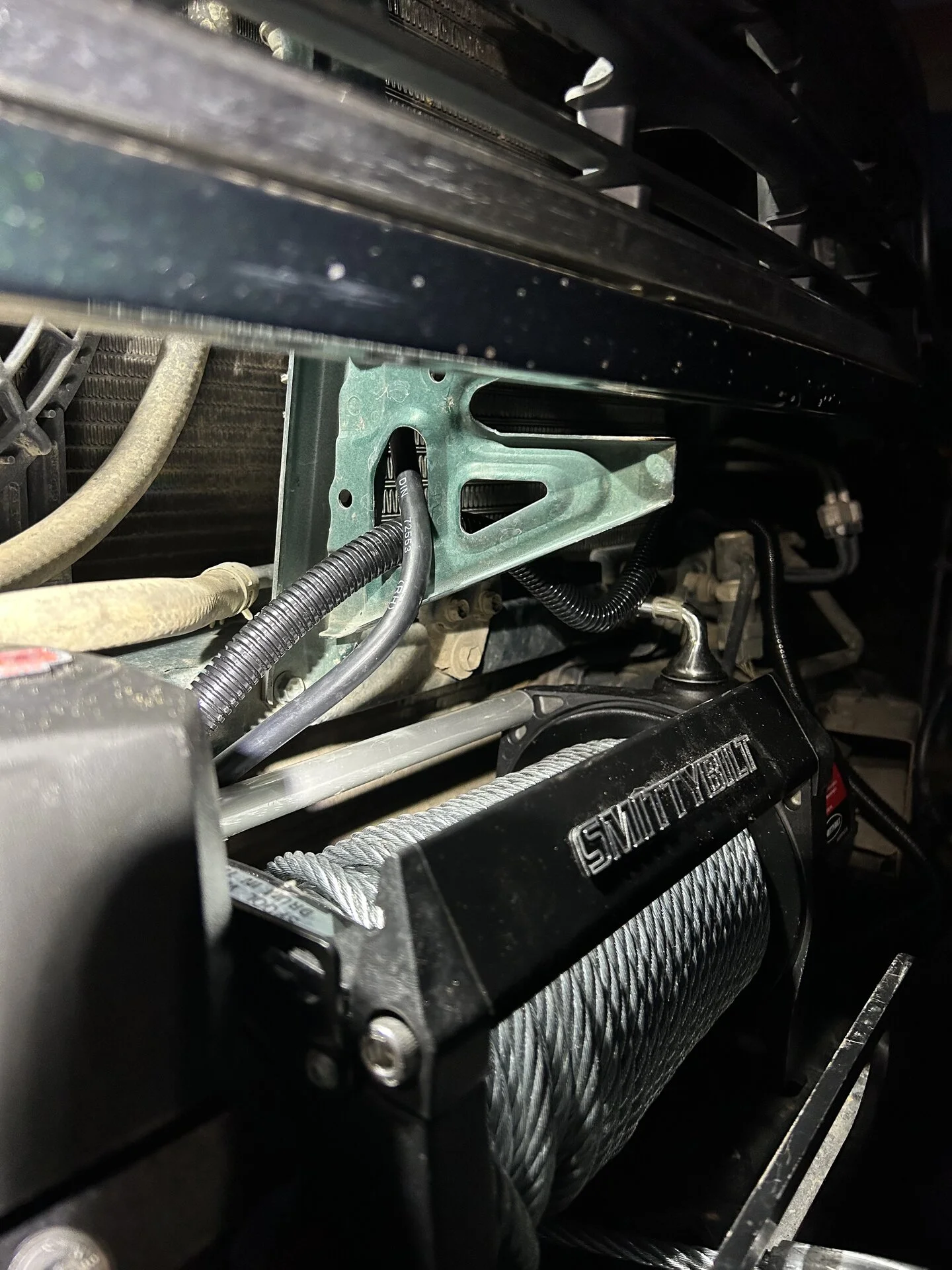

Just got finished installing the Smittybilt Gen 2 XRC 9500 on the TT hidden winch mount. The winch fit perfectly and I was able to mount the control box to the side of the winch using the provided mounting hardware. Plenty of space to reach down to plug in the remote and switch the clutch back and forth. The hardest part was figuring out how to cut the bumper for the fair lead. My dremel died halfway through and I cut it too small the first time. It worked out in the end though and I'm really happy with it!
