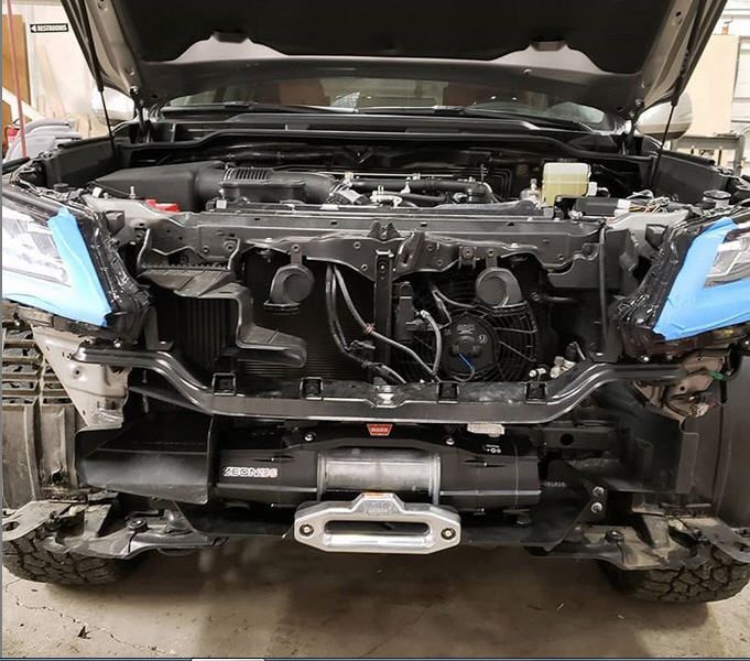

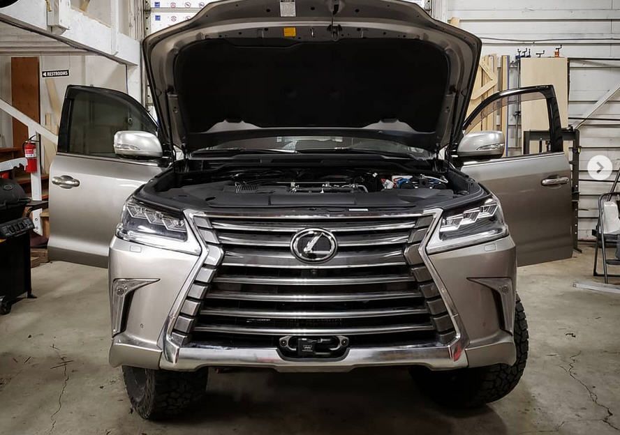

Hidden Winch Mount going in on a 2018 LX570.

Wanderlust Overland finished up the install this week.
J
I spoke with Wanderlust Overland via @IG yesterday and they plan to make a few posts soon to cover the install and hopefully provide a few pics to see how it was done for those of us seeking to do the same. The only issue I have with the hidden winch versus a full bumper is that the front end still has horrid clearance and approach angle issues. That said, the hidden winch is a nice touch for a mild or sleeper build and it's cheap insurance for those unexpected moments. But I just can't help but be concerned for the hang over and ripping it off, so torn.
That looks sweet! Finally someone else has the Warn Sidewinder on their winch. Nice work J!
