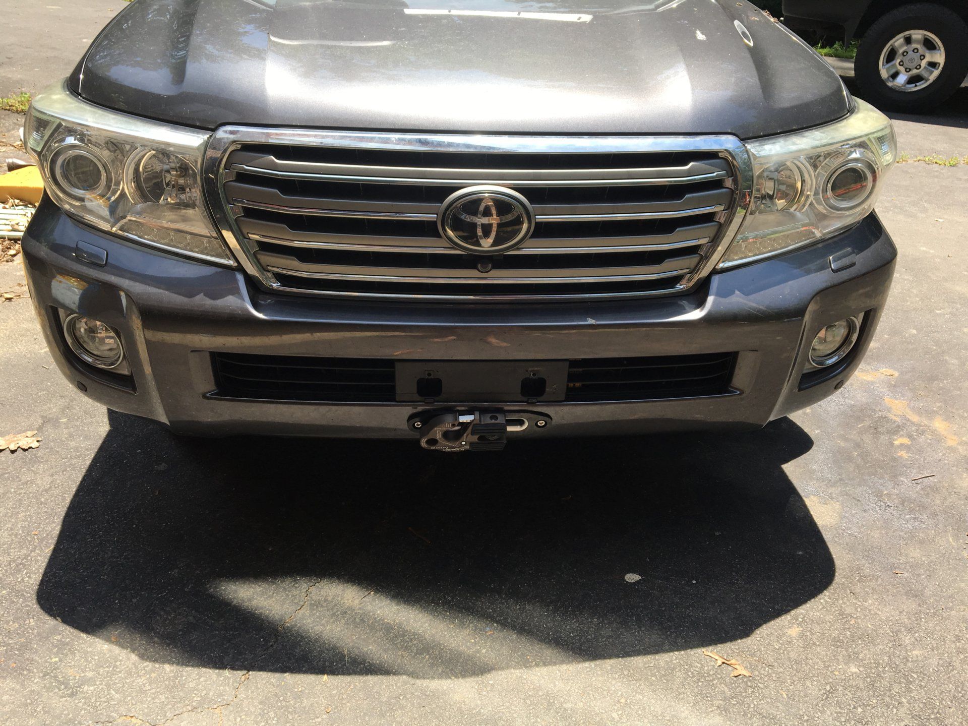

GEN 1 HIDDEN WINCH MOUNT IS A GO.
J
Nice job with the fairlead following the angle of the bumper. Does that work out to an angle of about 104 degrees?
You would know +/- a half degree. Thanks for all the help on dims through the R&D process. Nothing like building a product for a rig 2800 miles away. Couldn't have done it without spot on numbers and someone who "speaks" the same lingo.
Thanks again and enjoy!
J
Some better pics...
Inside cover to fairlead angle. I wanted this as close as possible and as @hedd replied.. the 104 degree spot was SWEET! He did a great job getting this dim for me as it really needs a level and an angle finder to get it dead on. He nailed it. Also the the mount tips needed clipped back to follow the cover angle. As you can see it follows the cover like a glove.
This is the ComeUp Seal Gen 2- 9.5rs winch and with a slight trim of the back of the grill valance the controller can mount as designed on the winch and also be accessed for the hard wired plug. The rs is a remote control winch so this is not a detrimental issue for most.
Controller plug
Front shot installed
AGAIN A SPECIAL THANKS TO @hedd FOR HIS SUPPORT ON THIS PROJECT AND HELP BRINGING ANOTHER 200 PRODUCT TO MARKET FOR YOU GUYS!

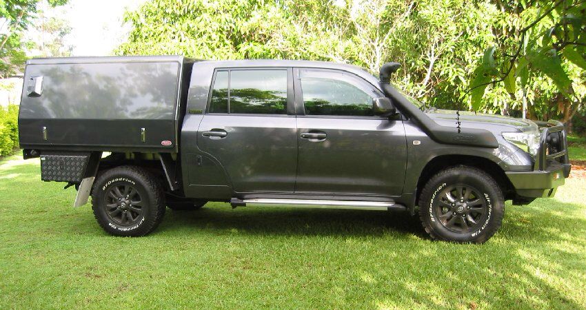

Yep! I already have a potential client in Santa Barbara that I'm talking with. He is wanting a tray (flatbed) with a single removable canopy box.
Full canopy
He's after the first pic with the back box cut in half and able to be completely removed.

I was picturing full roof removal/replacement with a built in, lift up cabin/camper/hard-side-tent something-or-other. :)
Sweet though and something I’ve not seen in the US market.

The rear tray and box on the MegaTourer is what my client is after. I'll be making something similar for my 60 or 80... Pending which ones clears CA DMV first.
