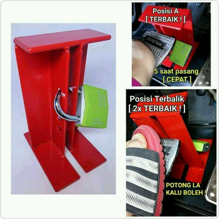

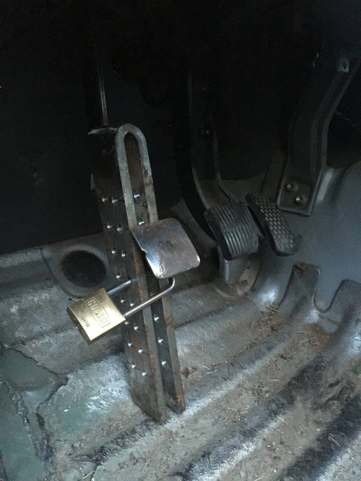

Haha the chain sure looks serious though! I’m making a couple of those clutch peddle locks for my cruisers. Here’s a better picture of it.
A f250 got stolen nine houses down for me and my next door neighbor got their motor bike stolen from their driveway the other day.
A bunch of years ago a guy I know was up at burnt bridge playing in the snow. they left a buddies Toyota pickup at the bottom because it couldent make it. Came back later and a bunch of black flag trucks and jeeps were there trying to start it. They came in fast and parked in front of them jumped out and it turned into a beer bottle fight. The dude stealing the truck got it started crashed into the other trucks getting away. The thieves scattered then crashed the Toyota into a ditch and put it onto its roof two bends down the road. He ran off into the woods as his buddies drove off.
With this lock hopefully i won’t get someone rolling my cruiser down an embankment while Im hiking again... at least the kill switch worked.

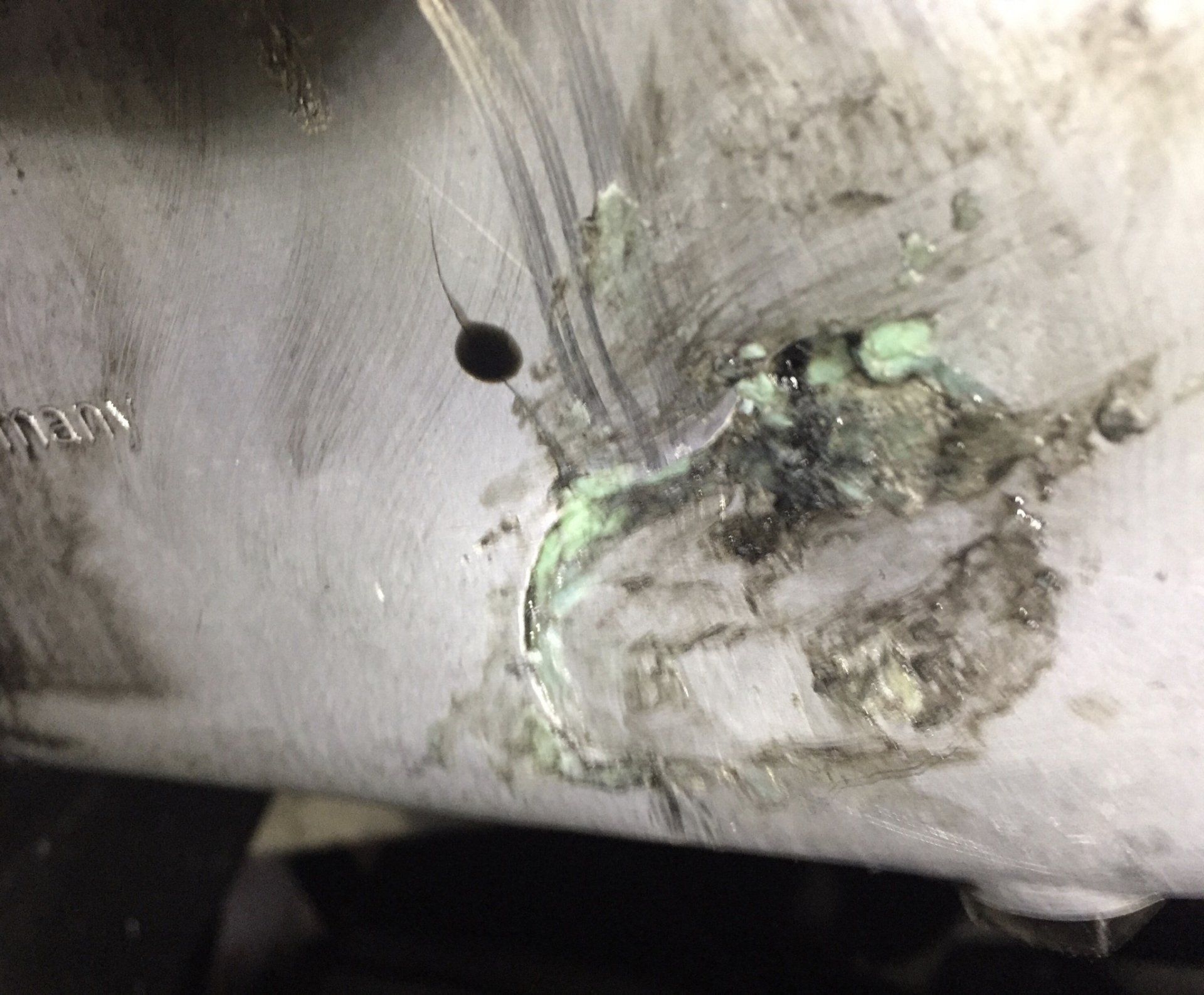

Bar of soap
Years ago I heard a bar of soap will seal up a crack even a small hole in a oil plan like nothing else.
Just rescued my stranded parents. they hit a rock with their VW and cracked the aluminum oil pan. So I brought them oil and rubbed a bit of a bar of soap into the crack added oil to the motor again. Got a call from them apparently still not a drip from the one inch L shaped crack after the 10k drive home.

That is pretty impressive. I'll have to remember that one. Amazing it held up to the heat of the oil too. I would have expected it just to melt out.
Hah I thought the same, I thought it would hold just enough oil in to get them home, but no. They drove home parked the car for the night, it was late so they just slid this pan under and went to bed. This morning this is all the oil that was in the pan. My dad figures the oil in the pan is just from all the oil wind blown back over the motor and firewall. The soap is still holding and not dripping. I should be able to follow up with a picture of the cracks.
crappy picture from last night underneath a low car after a wipe and a soaping
