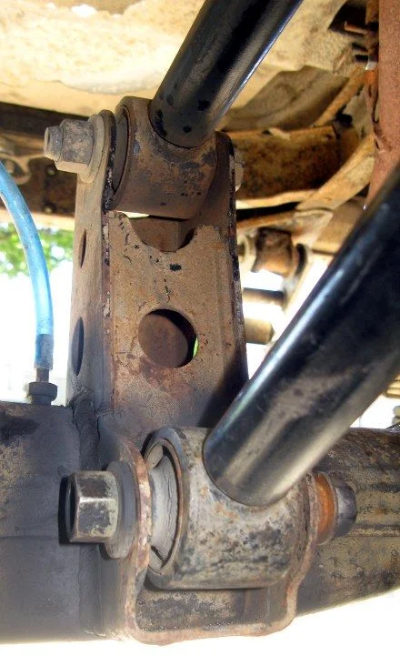

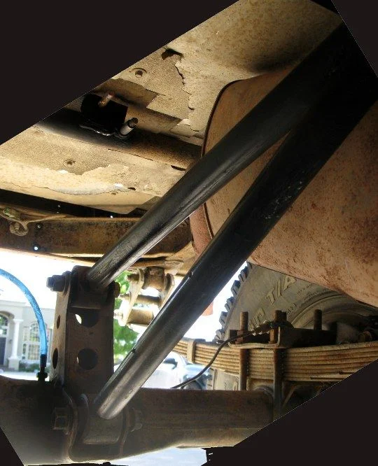

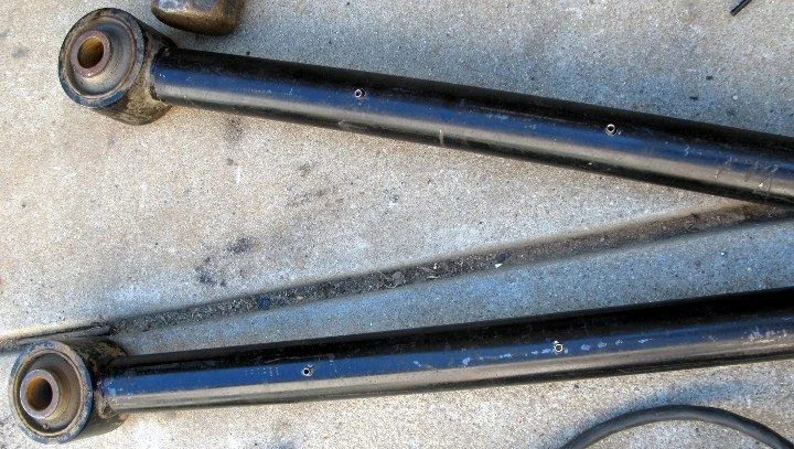

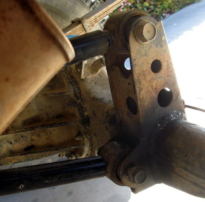

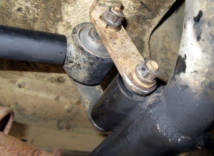

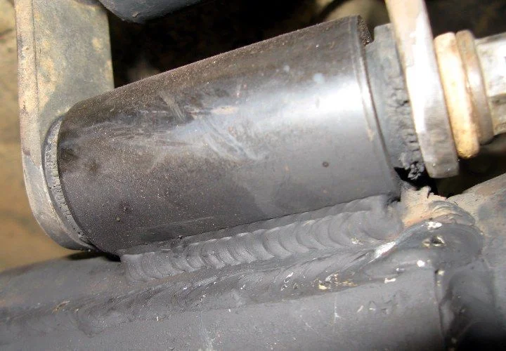

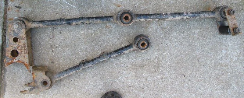

Mine's all custom made from parts you could cut off of an 80 series axle in a junk yard and a piece of schedule 40 pipe. :meh:
Front leaf-spring shackle, rounded for clearance:
attachment.php
Sleeve around the factory x-member and a through-frame tube intended for a shackle reversal, but we didn't use it (for that):
attachment.php
Misc brackets off the 80-series rear end when I cut it down:
attachment.php
attachment.php
attachment.php
Pinned instead of welded in case I want to replace the link ends some day and welding would burn the rubber.
attachment.php
Here's a picture when I was mocking it up. All that extra tube is inside the pipe, in case you were worried it wasn't strong enough. :flipoff2:
The front link is pinned through an oblong hole so it can rotate a bit. I love that it uses mostly Toyota parts.
attachment.php
attachment.php
attachment.php
attachment.php
attachment.php
attachment.php
attachment.php
attachment.php
The only problem i see with that setup is too much antisquat . It'll make your ass end hop when you go up super steep stuff and you start to lose traction . Better off mounting the front of your track bar lower . More inline with the front of the leaf .
