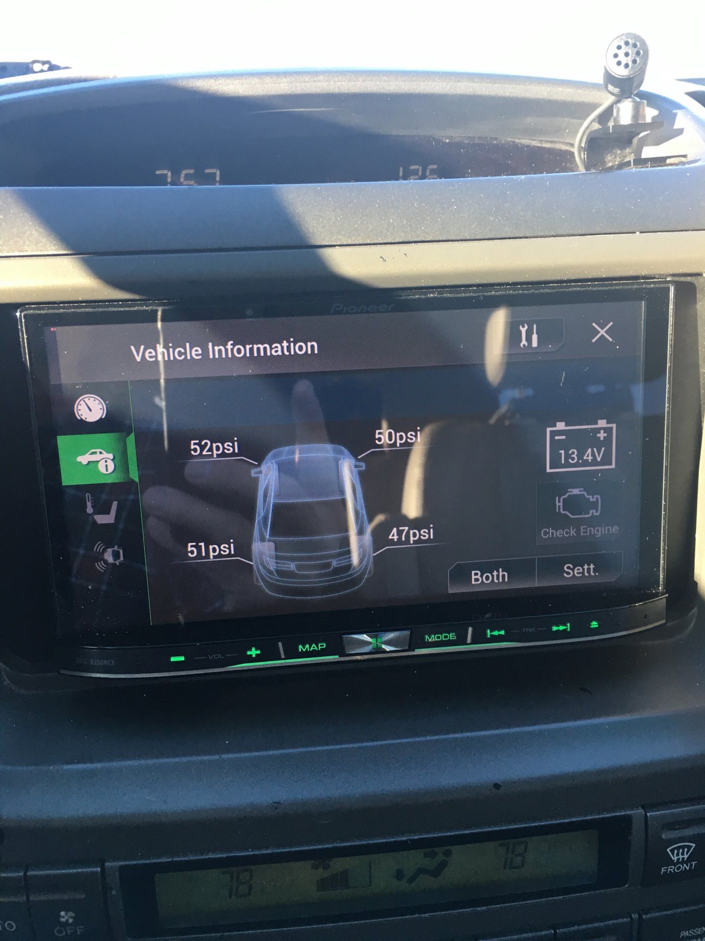

So this is the information that my iData Maestro is giving me, yes my pressures are high, I like it that way

I have a pioneer 8200nex, it reads almost everything, except trans temp. But it gives the tire pressure readout in PSI
the iData was programed for a 4runner
