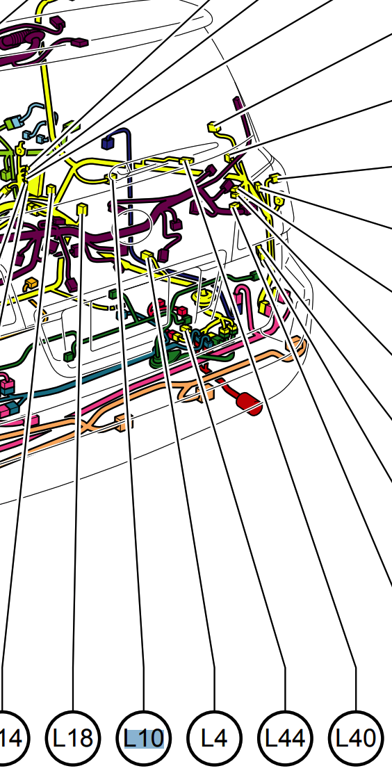

The Tire Pressure Warning ECU is located behind the right (US Passenger) rear quarter panel trim somewhere.

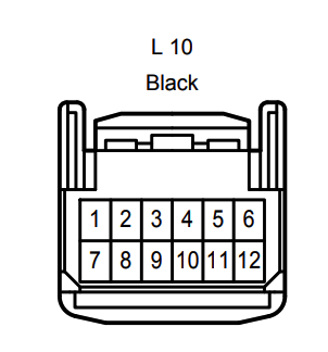

Here's the pinouts and wiring for L10 (TPMS Plug)
The way I read it, in the Tundra a voltage (+5v works) is output directly to the combination meter (dash) to light the light, and in the 200, the TPMS ECU reads the TPMS values on RDE, and sends a can message on to the ECU with a thumbs up or thumbs down, which deals with the MID and light. In other words, not going to work.
It is the same 12 pin connector, but not the same system.
