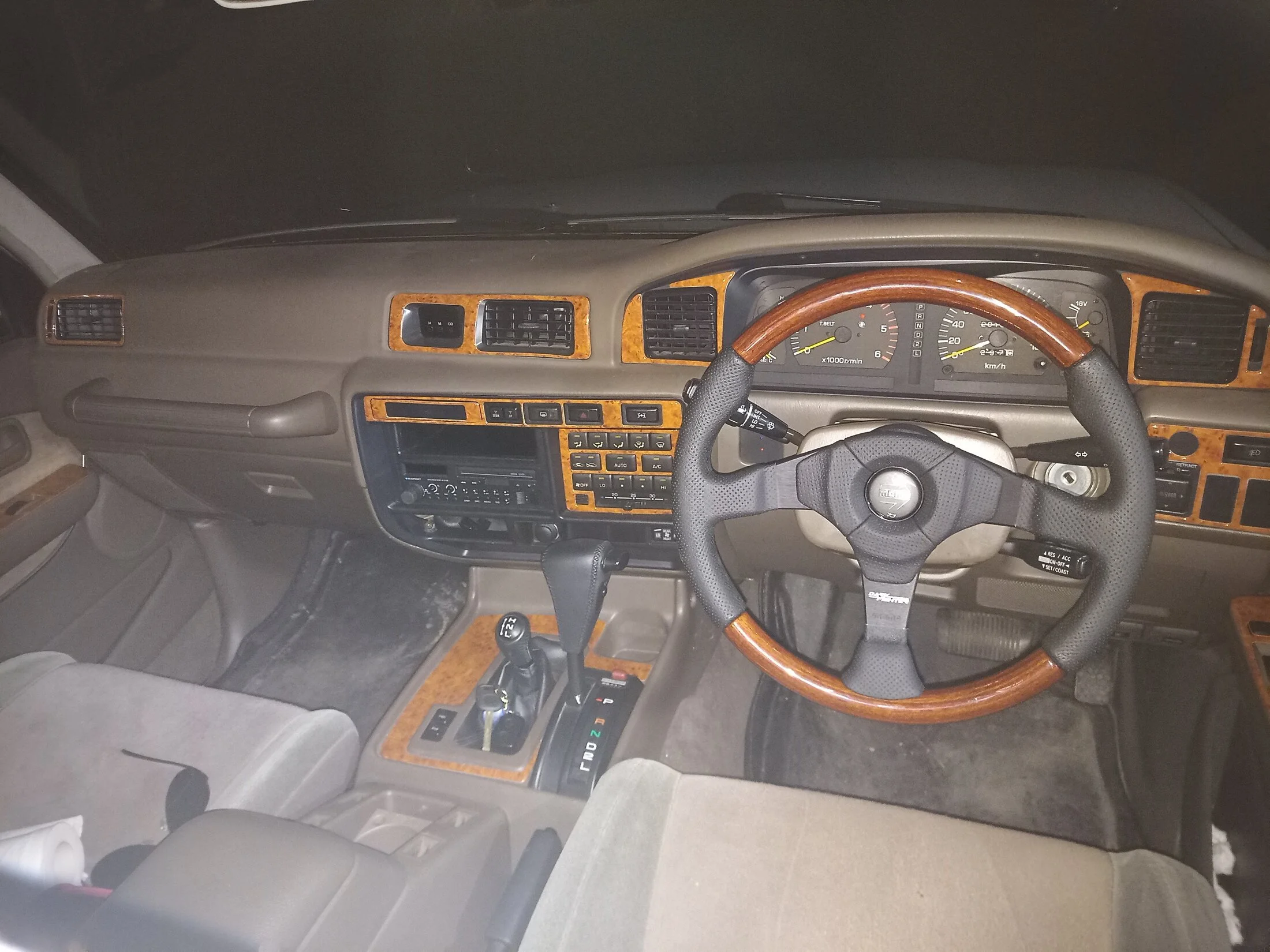

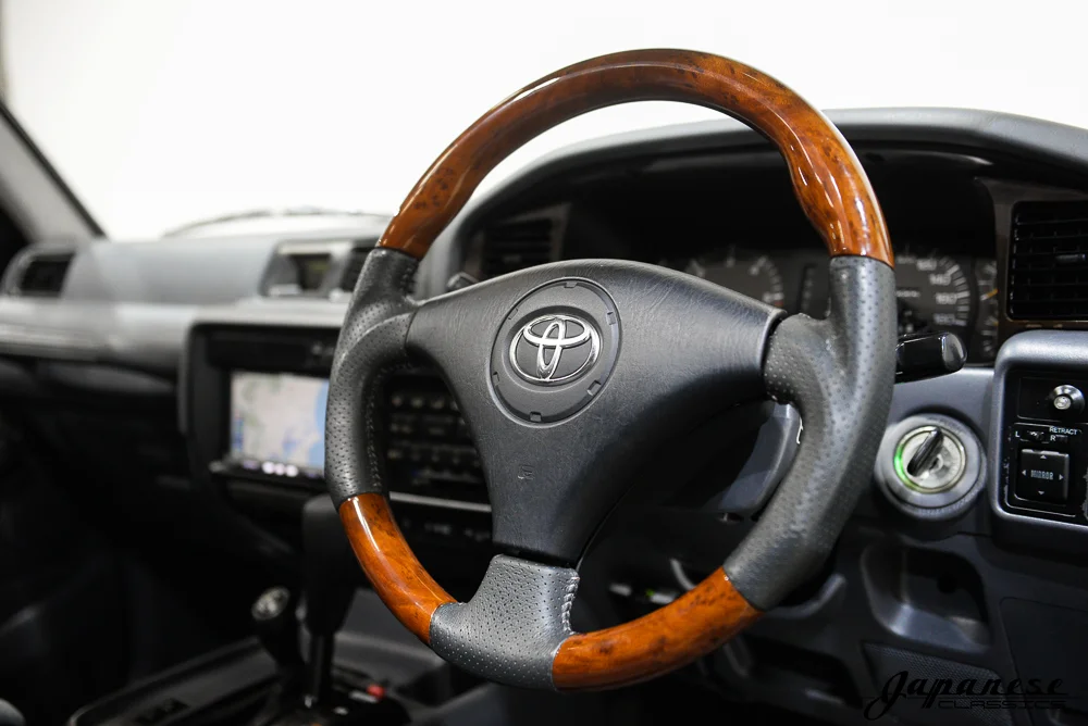

I really like the look of these RX300 steering wheels. I have a 94 so no airbags, now to go down a deep hole of "will it work" :)
It will work just fine. Basically bolt it right in. If I were you I would just remove the airbag puck in the wheel and be good to go. No wheel controls so clock spring won’t be an issue. That’s an easy one I bet.

Thanks my man
If the clock spring is an issue you might find it can still be installed. I installed a 2014 Camry wheel in my first series ‘92 80. The new clock spring fit in a lot better than I thought it might. I had to do a little work with the blinker mechanism but it eventually worked. I haven’t had any issues. I used the airbag wiring to power my horn. You might have to get a little creative. Biggest problem I had was the clam shell cowl over the column. The new wheel and clock spring were tighter so I printed my own cowl and made it 1/4” shorter. I know that’s a lot of work but depends on how bad you want it.
