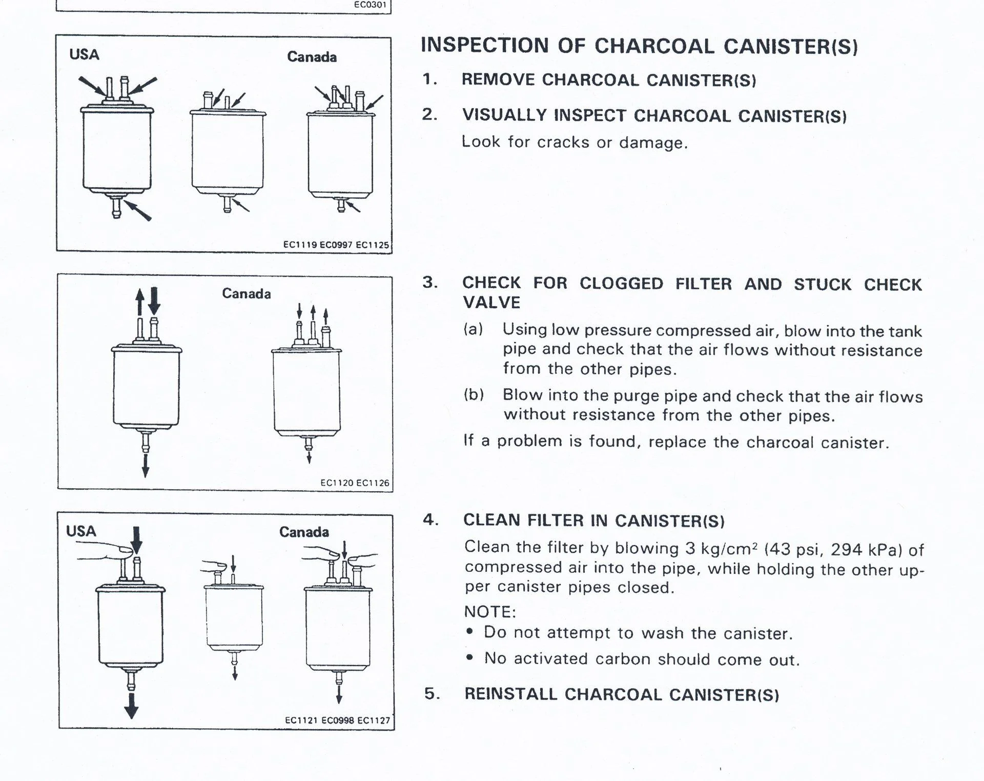

Here is a page from the Factory Service Manual on inspection of the canisters.

That is what I was thinking. Are the vents hooked up to the manifold correctly? Are any of the ports blocked? There is a vacuum switching valve. Is it working properly, or even plugged in? I've attached the pages from my 1985 manual on the subject. It should be close to what you have.
