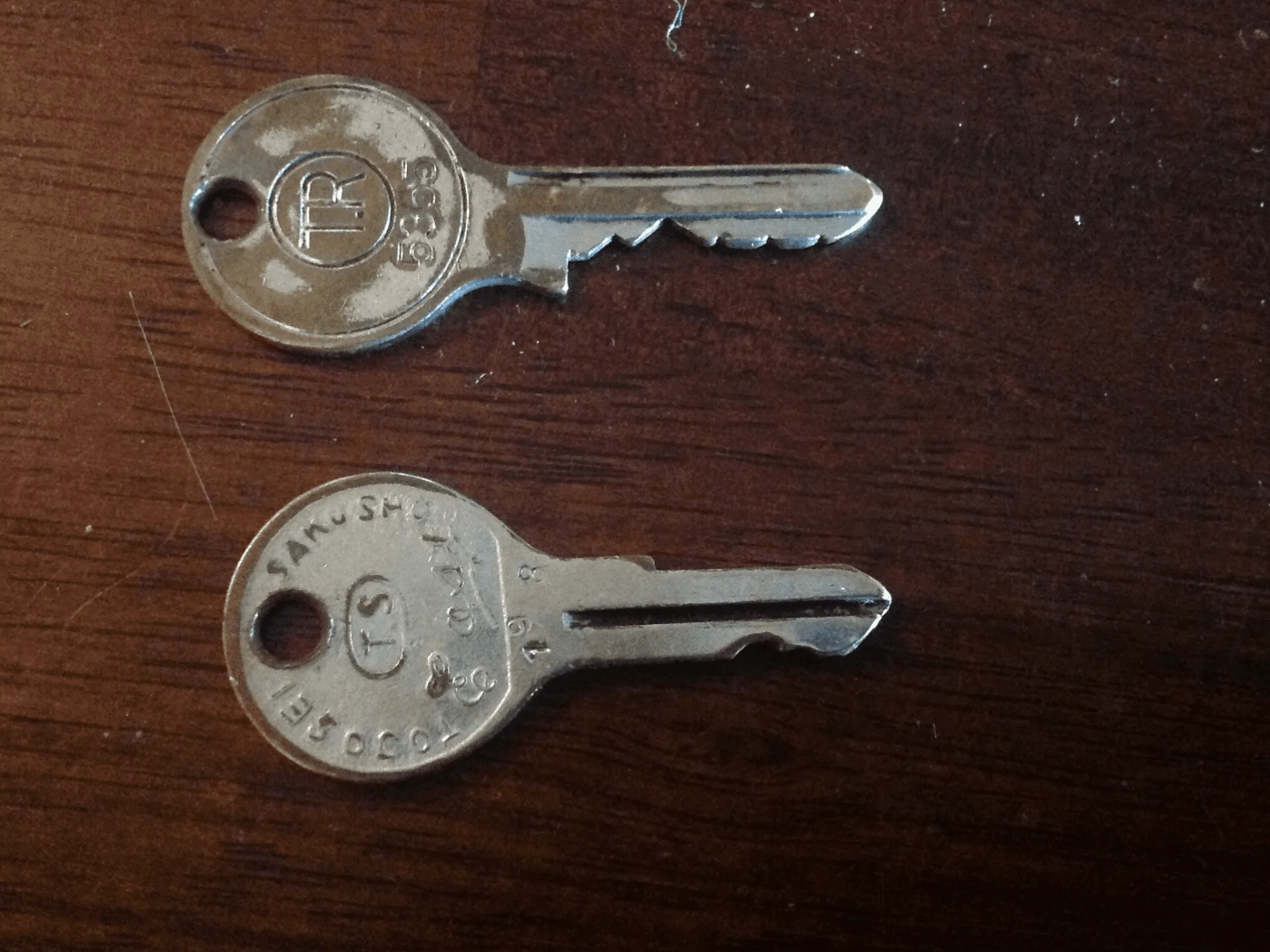

This is the driver door to my '66 LV. Do not know if it works on the tail gate. Would appreciate if some one could post a pic of a known working tail gate key. In my travels I have not been able to locate a blank to match this door key.

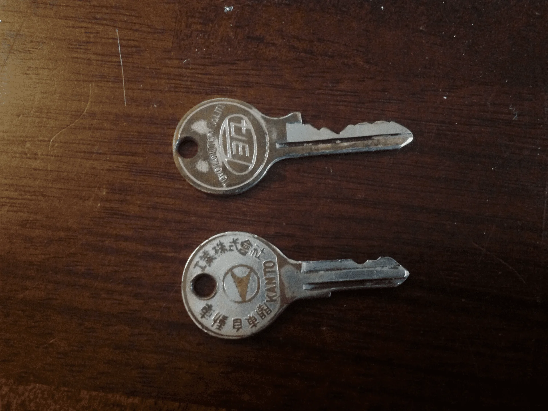

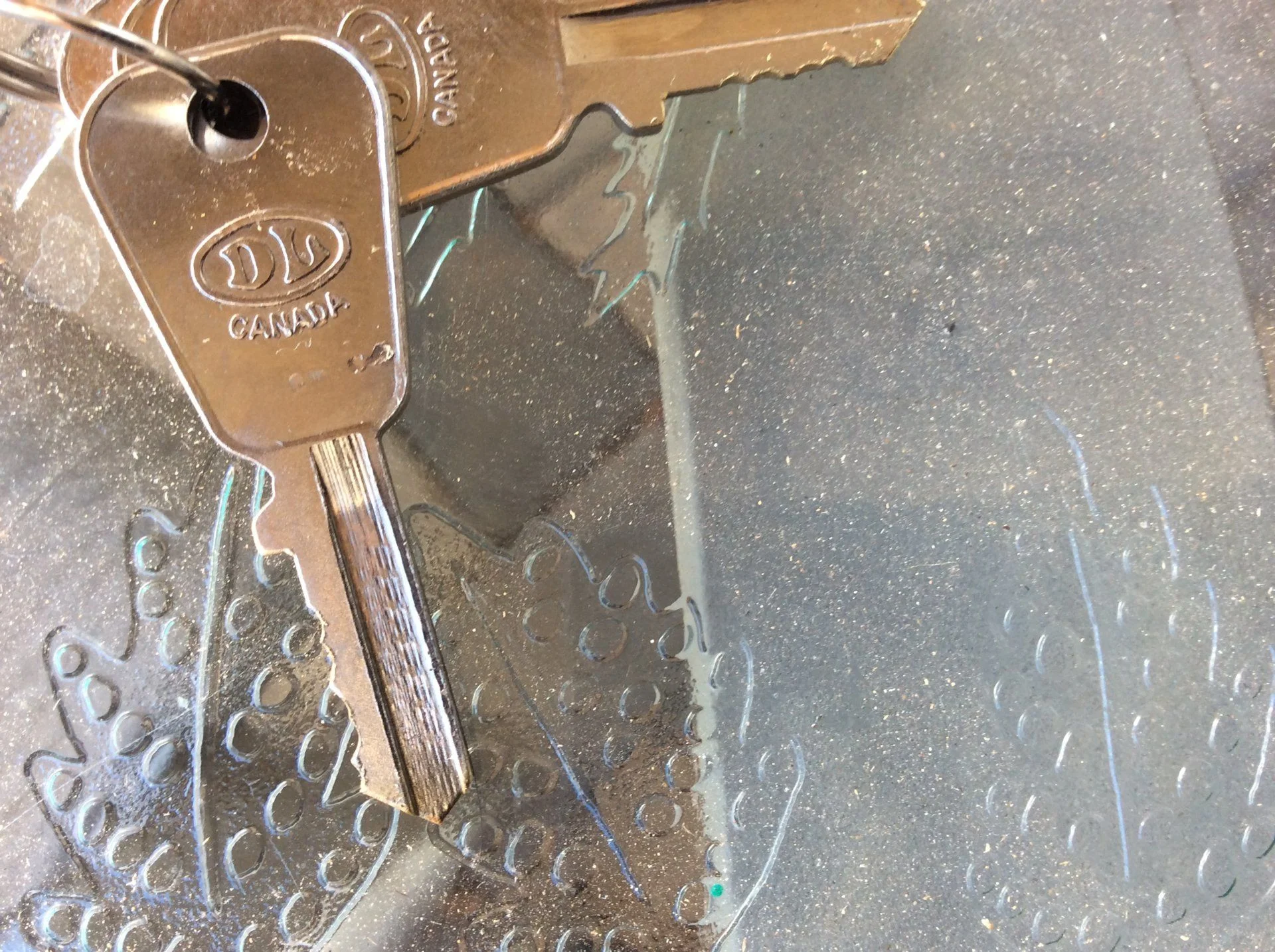

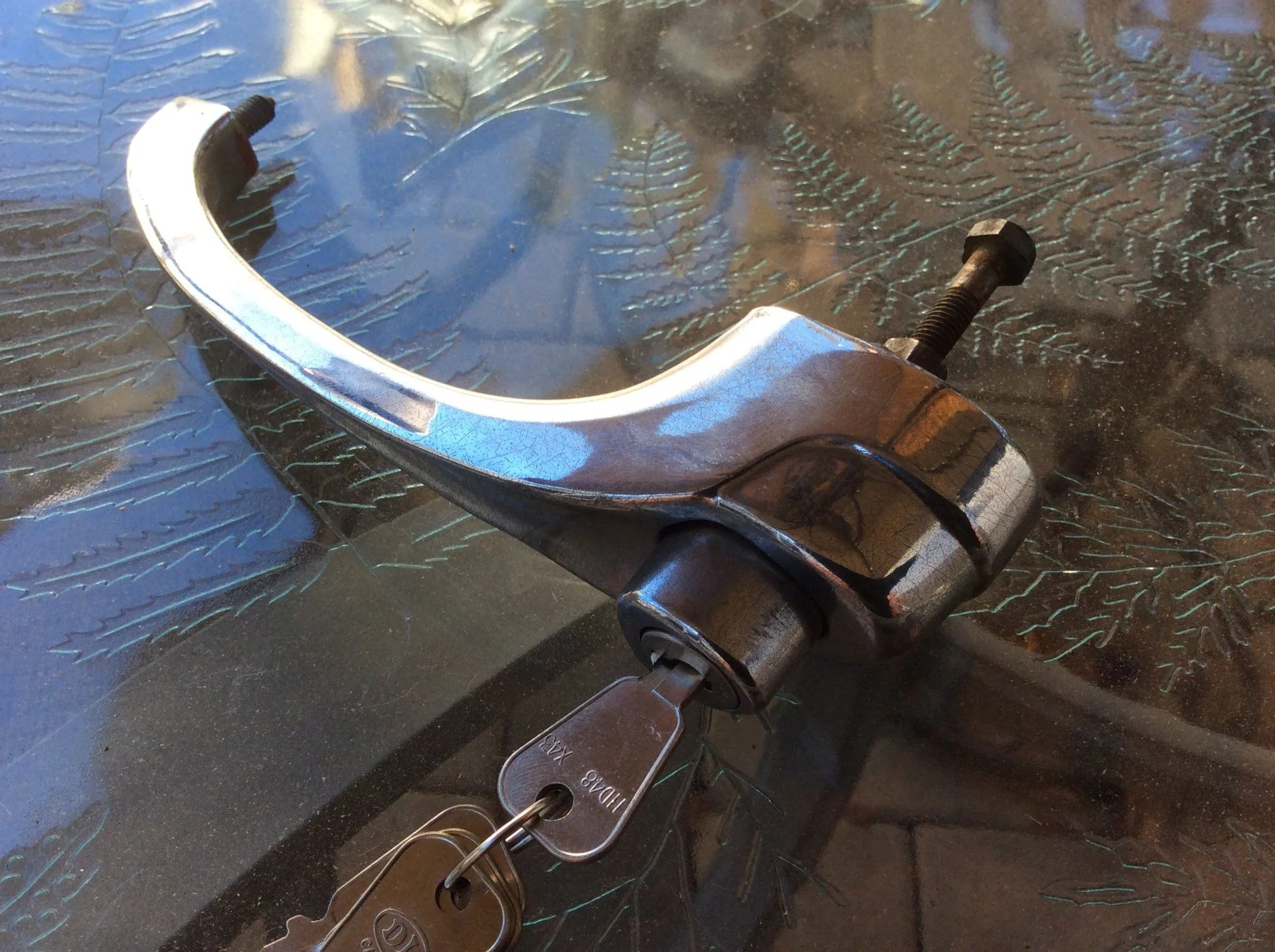

Well, finally after harping on the grandson a few times, he got it done. Turns out gramps is back in the hospital. I told the kid if he can't get it done, give them back to me so I can go somewhere else. So he went to work on them. Not the best, but better than nothing. Here are some pictures.
