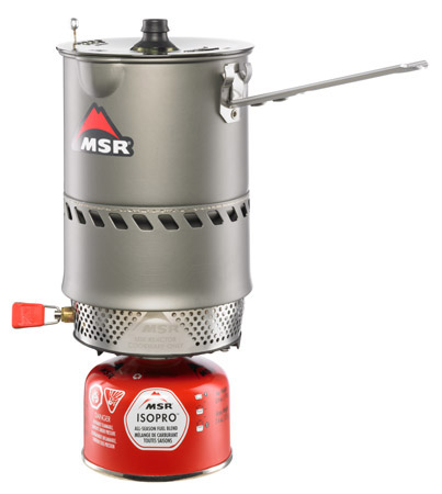

I use a Jetboil too! 1 minute to boil .5 liter of water. The problem with these is that they dont use regular propane. They are popular here in the states because you can get that isopropane damn near everywhere. But you can buy an adapter to use propane or find a similar product that uses propane.
Yeah, it sucks. For outside CONUS, I use a Soto multifuel stove, and the jetboil titanium cup. Still boils in no time. With that stove I can run Coleman fuel, gasoline, or even diesel fuel if I'm desperate.
Yeah i also installed a regular butane gas bottle under the sink. I have a gas stove which i can either use inside or place on the outside rear door table.
