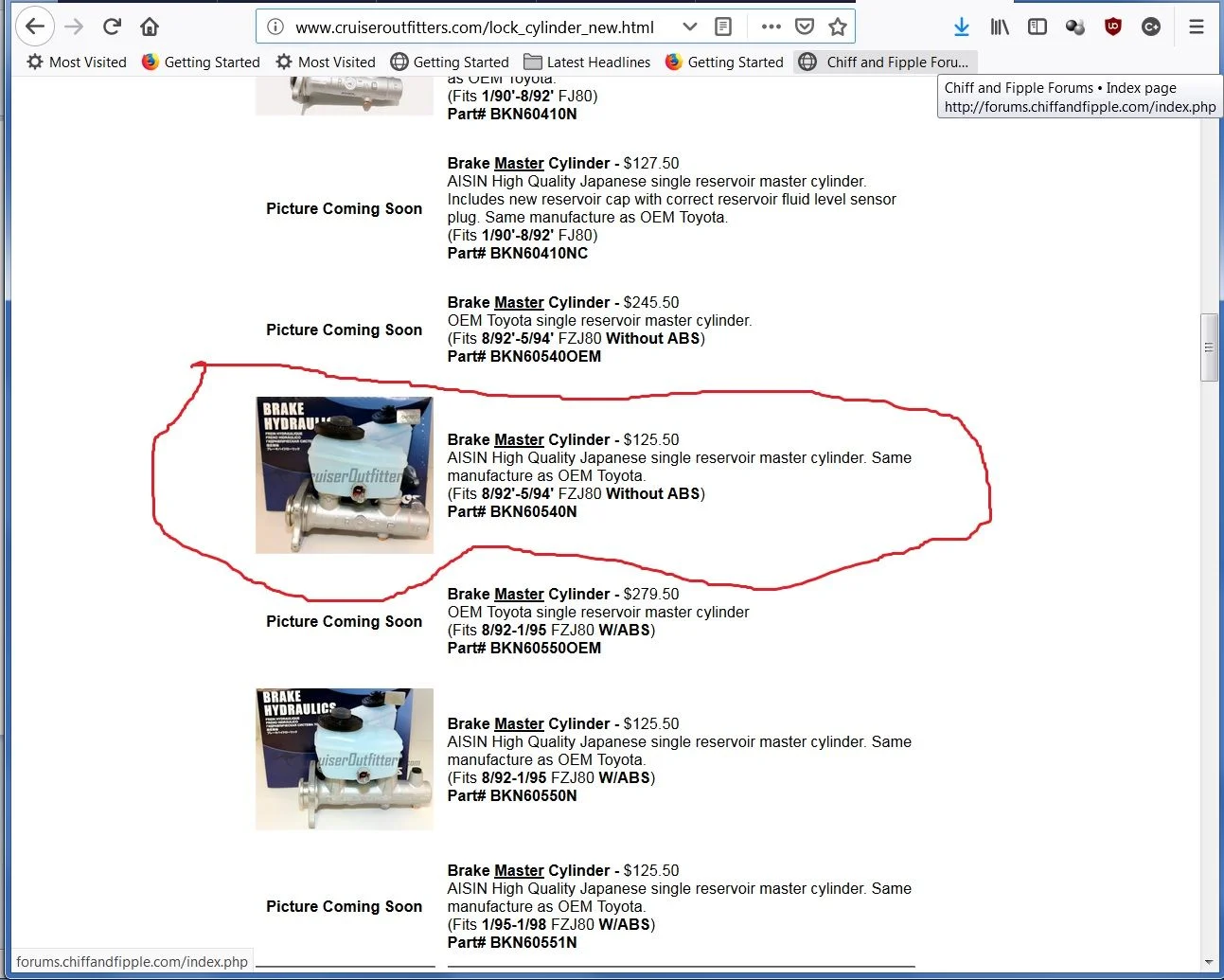

I had a '91 FJ80, and it still had drums on the rear. For a 40 with discs on all four, I think you want the non-ABS FZJ80 master. Cruiser Outfitters sells brand-new Aisin ones.
This is the one I bought from Cruiser Outfitters:
Cruiser Outfitters

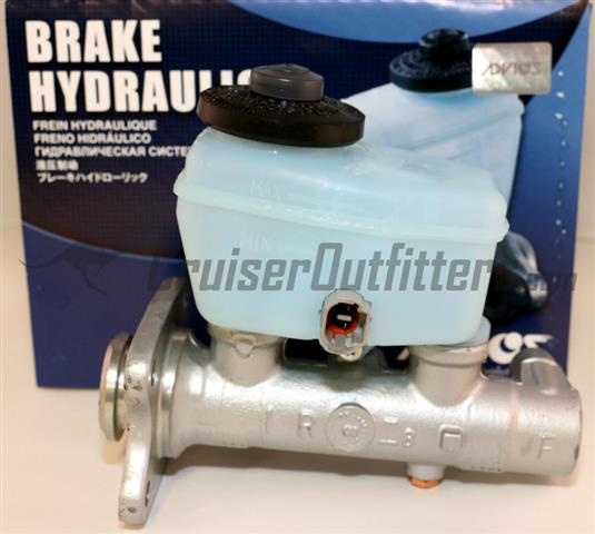

What about that electrical plug on the side? just ignore it? or is the picture not correct?
The plug is there as shown. It's for the low-fluid-level light. You can ignore it, or wire in your existing harness connection if you want. @Coolerman probably sells the right connector I would guess.
Note also that for most 40-series applications, you will have to re-route (and probably cut and flare) the the brake lines to fit the later FZJ master cyl.
