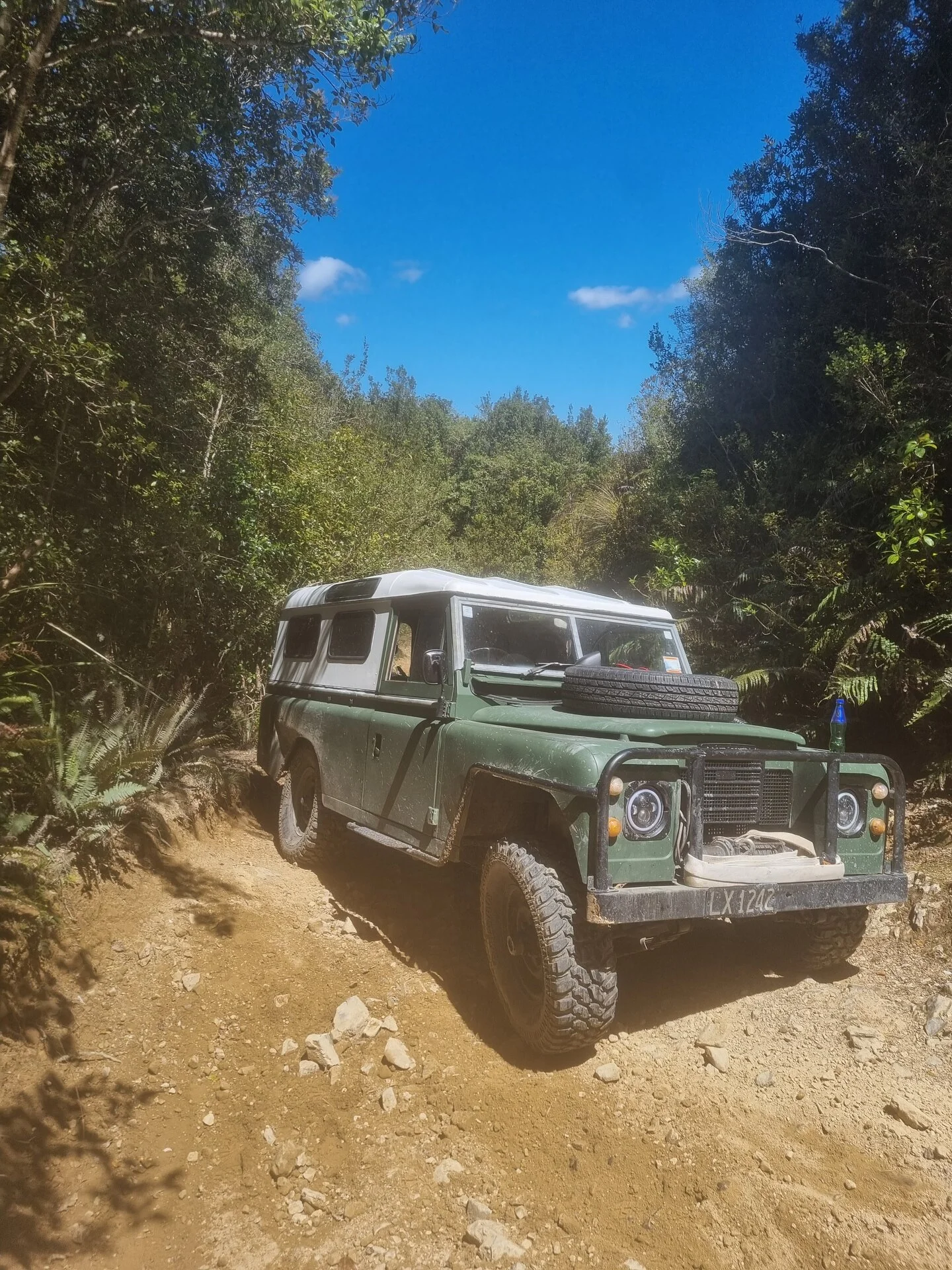

To start. I have a Land Rover series 3 that was engine swapped with a 3B before my time.
ontop of my numerous other issues, recently I have been having trouble with my throttle. For example I will accelerate and the engine will sort of bunny hop, gradually getting worse unless I slam my foot or release it. (Yes I'm driving properly I don't need tips) or I will be accelerating to let's say 50kmh and then as I rest my foot to maintain speed. It again starts to bunny hop, gradually getting worse unless I release my foot or give full gas.
Any ideas?
