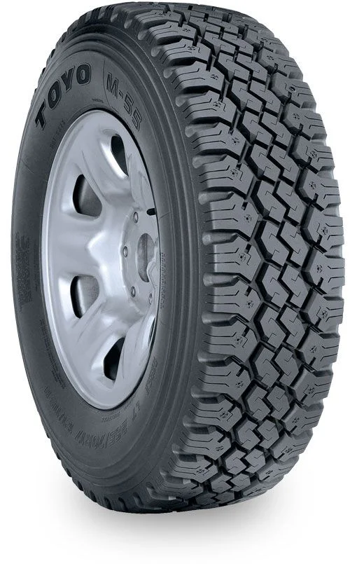

FOr the replacement set, I could simply go Toyo Open Country HT again, but remember that I had put the very tough Toyo M55 tires on my Dodge 3/4 ton truck and slide in camper. I was envisioning long road trips partly on gravel roads up north, and did not want to have to worry about the tires in the slightest. The M55 sure gives that confidence. THey sing a bit on the highway, which wasn't too much of an issue in the Cummins Dodge, but I'm thinking it may affect the otherwise quiet ride of the GX.
M-55 | Toyo Tires

I probably won't be able to get the size to fit, but part of me would love to put Toyo M-55's on my GX, the tires used by logging and hydro companies to drive in the bush and gravel roads, tough as nails. Sing a bit on the highway, which is why I'm thinking it may not be the best solution for me, given the quietness of the GX and that I'll be driving primarily on pavement. I used to have a set on a Cummins diesel truck, so the tire noise was kind of drowned in the engine noise. Then again, maybe the extra soundproofing of the GX would make the M-55's almost silent inside, with the windows up...
M-55
Every one of the 17" will fit a GX with a lift. I didn't see anything big enough for my liking :P
