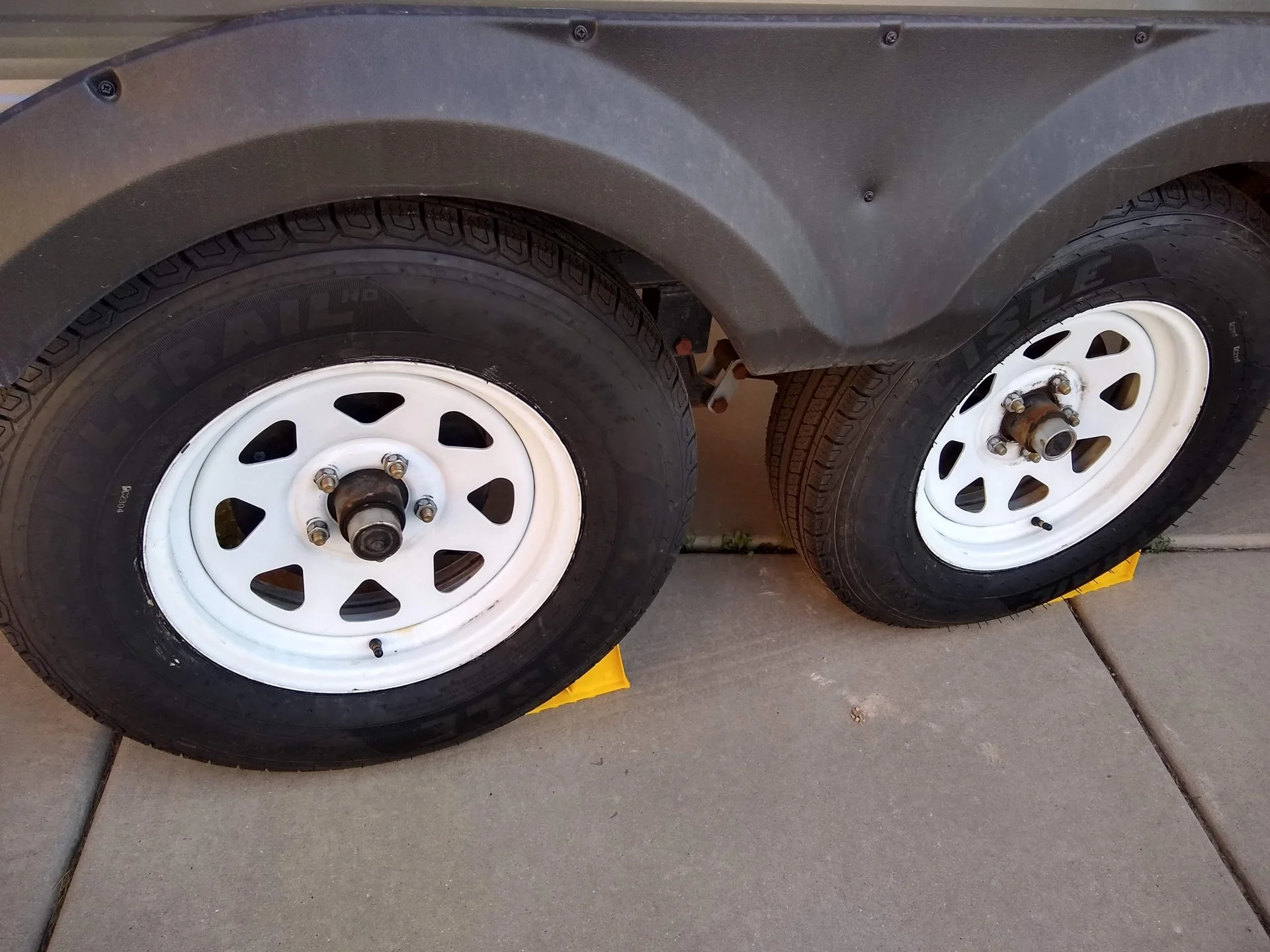

I’ve ordered my trailer tires online (once off eBay and once off Amazon) and brought the tires and wheels to my local mechanic, which changed them out. But I had to put the truck on jack stands to get all 4 off.
big thing I recommend is to make sure your new tires are at least M speed rated (81 mph). Not sure how fast you drive but older tires are only rated to 62mph believe it or not.
I stepped up from C to D load as well so I could run higher tire pressure but you may not need that buffer. Also as you’ve now seen change your tires every 5-7 years because they will deteriorate.
my recommendation for tires is Carlisle but YMMV. Not a fan of Goodyear given all the issues they’ve had with their (larger) RV tires, and I’d hesitate to run generic brands
Thanks for the info and recommendation! Carlisle tires have now been installed, and we're ready for the next trip.

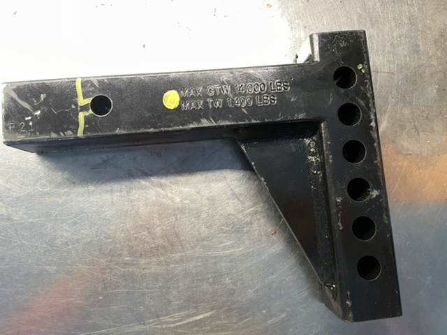

I’m setting up a new hitch and I’m thinking of modifying the shank to be shorter. Is there any reason I would not want to shorten it? I would be moving the ball about 2.5 inches closer to the bumper. Not a huge movement, but every little bit helps I believe.
here is a crude markup of the shank. I would slot the old hole to insure no one tried to use it.

Reasons not to shorten? Very little IMO. Perhaps clearance for the tailgate to tongue jack, or other clearance concerns?
The pros and positive knock on effect to stability, proposing, sway, are all predicated on optimizing this geometry. However subtle that might seem, 2.5" is akin to increasing the wheelbase by 5", with the 2:1 wheelbase to rear overhang ratio of our 200-series. That's a solid improvement to maximizing our limited wheelbase.

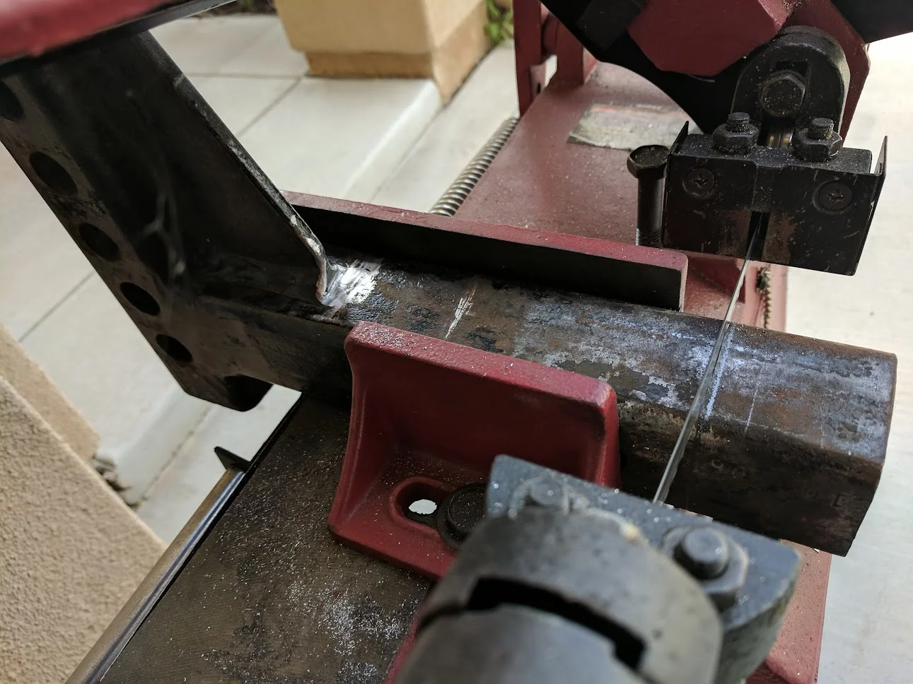

My little HF bandsaw took awhile but did the deed.

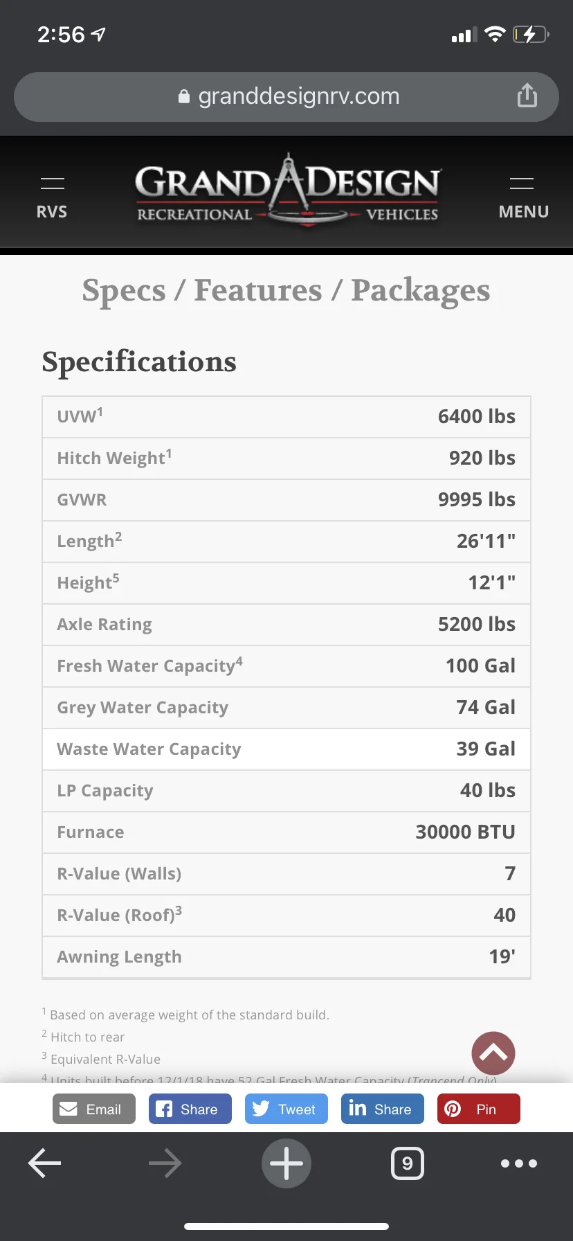

We have been searching for the right trailer for the family for some time and stumbled upon a Grand Design Momentum 21G today. It would seem to fit the bill in many ways, but it is heavy and i am doubtful of being able to pull it safely.
You can see the specs in the screenshot, I would estimate around 7k with batteries, propane and any other minor dealer add ons. If I use 12-13%of gross to determine tongue weigh, I am faced with 850-900lbs before water or gear. doing the math based on payload rating, that would equate to 1655capacity-900tongue- 425people= 330lbs of payload left for water and stuff
Seems like too much for a 2013 200 series right?
I do have e rated tires, progressive springs and bags in back, but concerned with not having any safety factor here…
obviously the GVWR of this unit is predicated on having a “toy” in back, which we would not, but I would expect to boon dock on occasion and that would require bringing fresh water in…
I know several of you tow at the limits of the truck and so curious if anyone thinks this safely feasible? TIA!

Too big and heavy for the LC/LX once you put any stuff in it.
