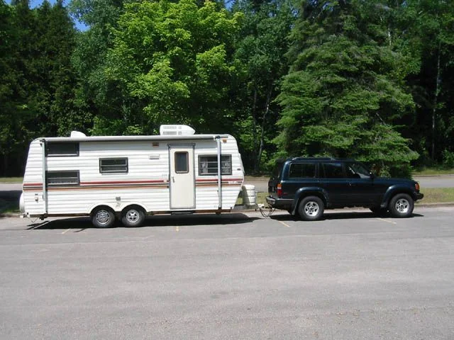

That said, I've towed a 24foot camper with equalizers with my SC 80, and found no problems with vehicle controlling the size of the box (stock suspension, airbags x 4, LTX tires). But that was with a 5500lb GVW trailer.
https://forum.ih8mud.com/attachment.php?attachmentid=151422&d=1182103008
Bottom Line: I just don't see it realistically happening at 7000lb. Add in the western slopes you hit before you get to AZ, this would be a really uncomfortable ride, with a Supercharger working really hard to get you there..
