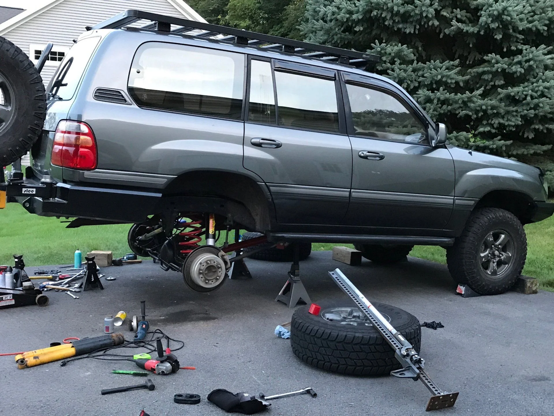

While I'm under there.......why not put in the ToughDog Adjustable Foam Shocks...
Longer for more droop, bigger for more cushion, adjustable cause I like to change my up my ride.......
View attachment 1551673 View attachment 1551674 View attachment 1551677
Droop: With the ome's the tires were about an inch off the ground, with the TD's I had to jack the car about 2" to get the wheels back on.
Test Drive: I set it on the softest setting #1 then worked my way up to the 4th click. Very nice 1st ride, can't wait to get in the dirt with them.
I Just put them in last weekend. Really pleased with them on the road. I have not done any offroad yet but my current road setting of 4 seems like it would be much better and I have 3 more soft settings. I can't wait to put them upfront. They are a must have IMO.
