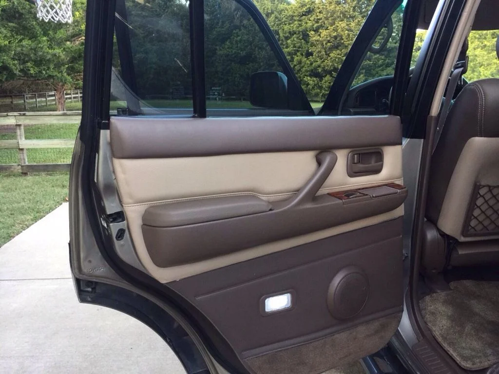

What did you do with the previous door panels ?
I still have them

First, Great looking truck! Something to be proud of. Question, Source for your soft LEDs, and rear cup holder. Thank you sir. Oh, an aside, I was accepted to the Citadel in 1975, couldn't afford it at the time.

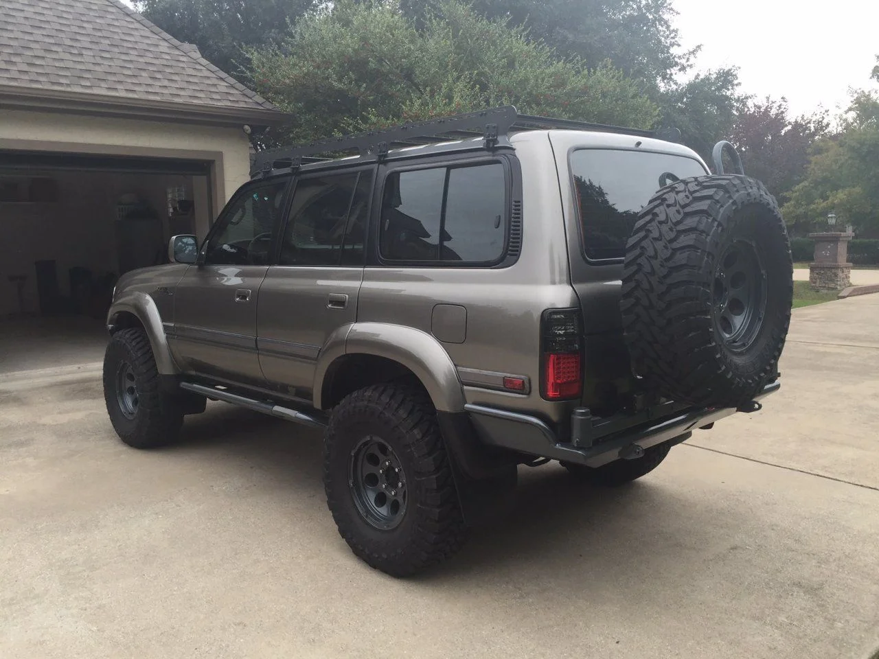

Is that legal shade tint or darker? If Darker, by how much? How bad was it to remove back window tint and save the rear defrost?
I used my wife's garment steamer to remove the rear window tint, once you get an edge up, get the steam between the tint and the glass, the glue releases, and it comes off very nicely without risking the defrost lines. Final clean with some windex, and done.
Excellent information!!! Thank you! Merry Christmas!
How did you get the window tint to match up?
I ditched the factory bronze tinted glass in the hatch glass and rear quarter glass. I replaced that with clear OEM glass from Dan.
Since all the glass was clear after that, I tinted it all the same color.
I actually replaced every piece of glass in the truck except the front passenger and driver door glass with brand new OEM glass including the sunroof.
