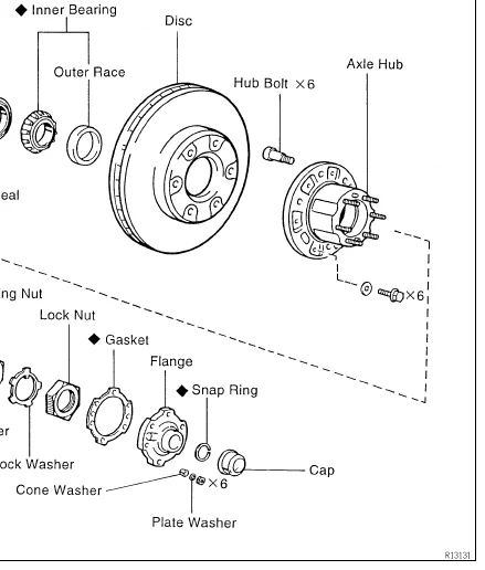

A little axle pron to go along with the explanation above,
As you can see, the hub to disc connection uses a hex head screw, but the drive flange to hub connection uses studs, nuts and cone washers. Mechanically, there's no difference between the hub and flange connections, from a risk/failure point of view.
The drive flange supports am internal torque load, from the driveshaft. The hub, through the wheels, supports an external torque load, during braking and on starting forward motion. I'd argue (without providing the mathematical analysis, but purely from inspection), that the wheel load torque is the greater of the two (due to the longer lever).
So, with all that in mind, the hex head screws are doing more than the studs. If you wanted to make the argument that you could replace the studs with screws, that'd be it.
