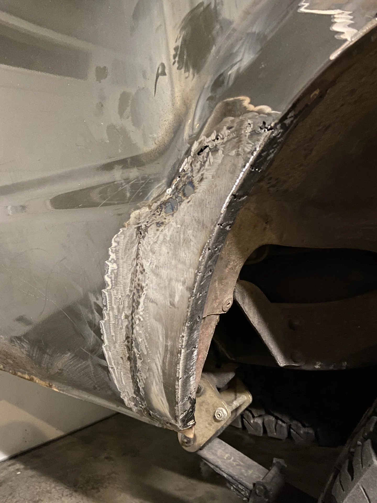

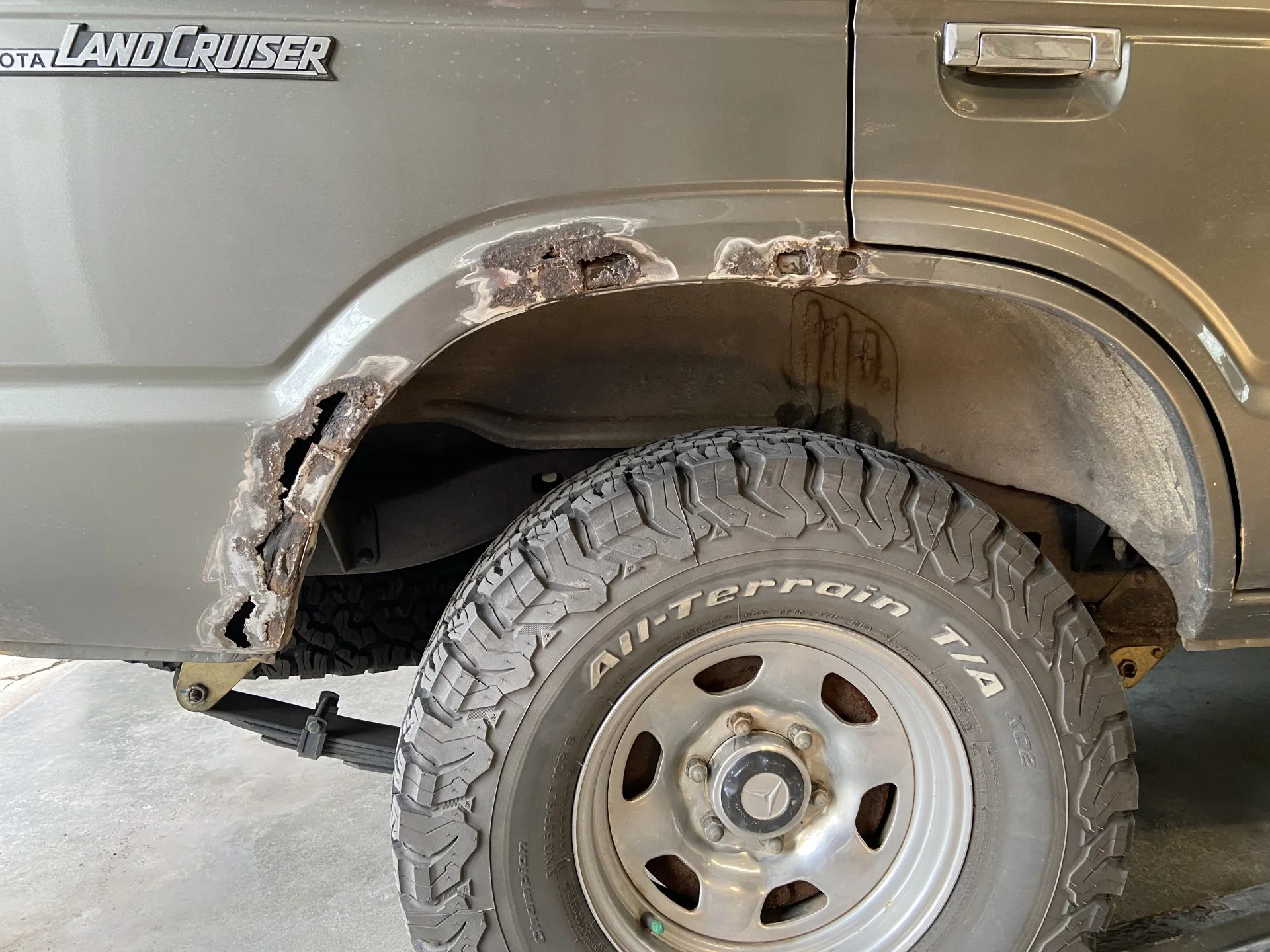

Yes it did have some rust in the usual spots. I cut it out and welded in some patch panels I made.
Wow good work! Mine needs some body work too but I'm working on the frame axles and leafs first. Side note I have this speedo cable seal kit I picked up from city racer and I cant find any info on which way to install the inner seal. Have you seen anything or done this?

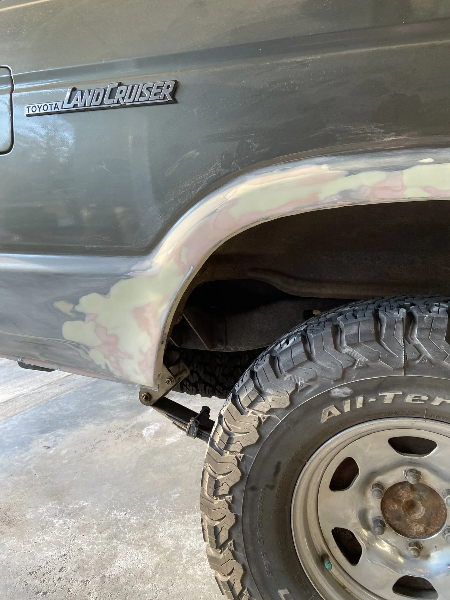

Fill and sand body repairs​
done​
