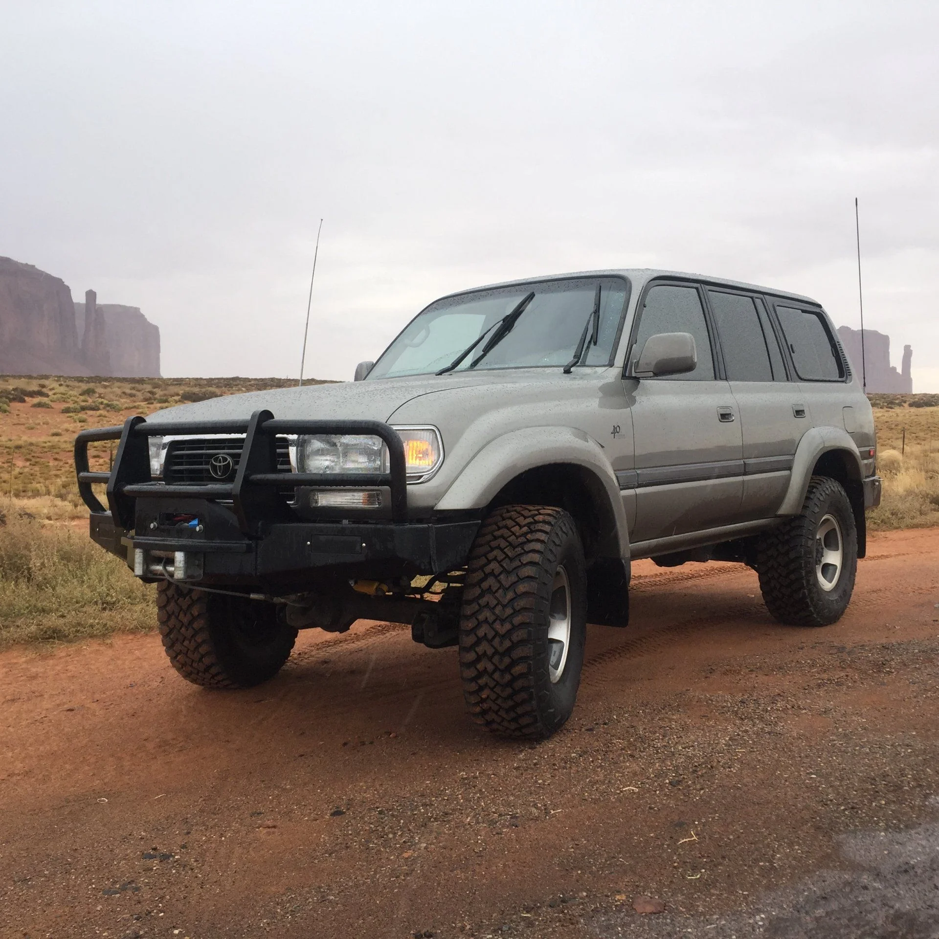

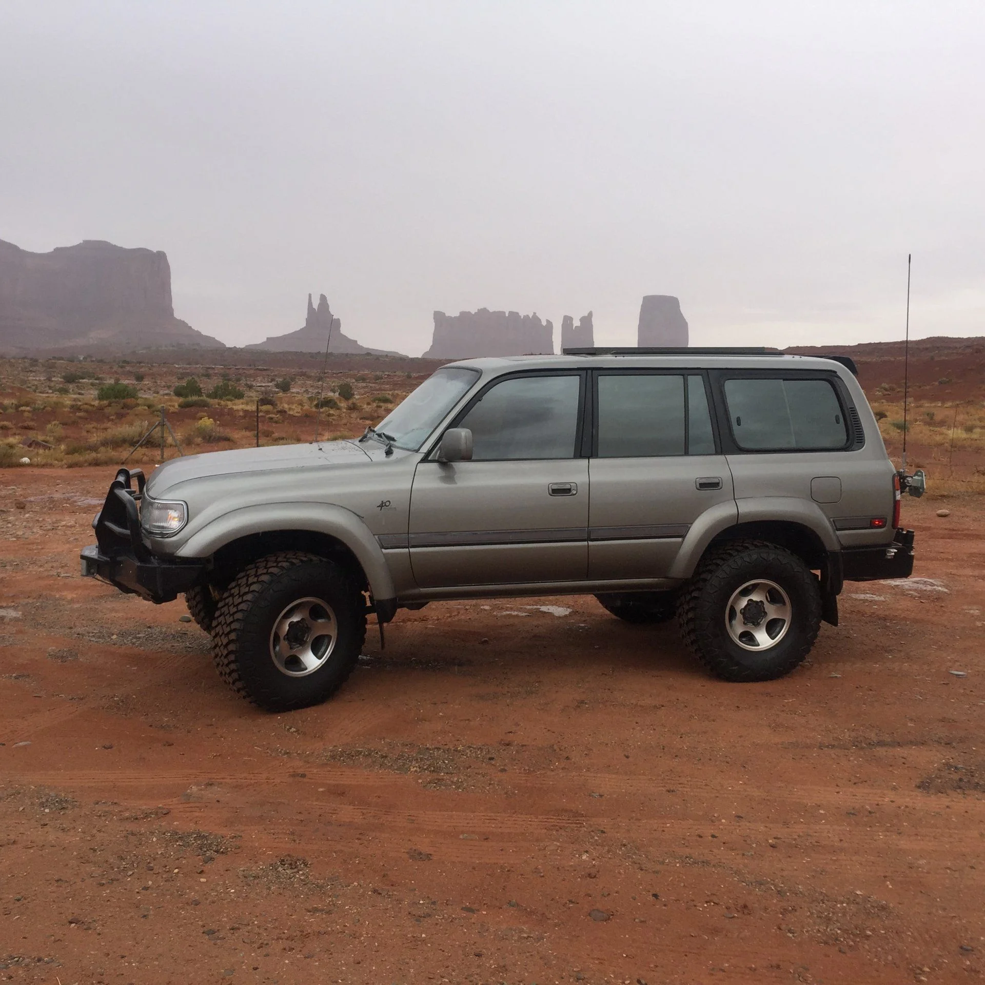

The car is having 850J with some spacer in the front and 35 tires. While I like the look the handling is not the best, also bear in mind that we will have the roof top tent installed and also will carry some parts on the roof so having 4'' lift with raised center of gravity is not the best.
Robbie also suggested that I do the head gasket prior to the departure (June) and either regear or down size to 33' tires. I think that I will go to 2.5'' OME suspension kit and 33 Toyo M/T tires. The reason is the high center of gravity and also availability of big tires in Russia and Mongolia.

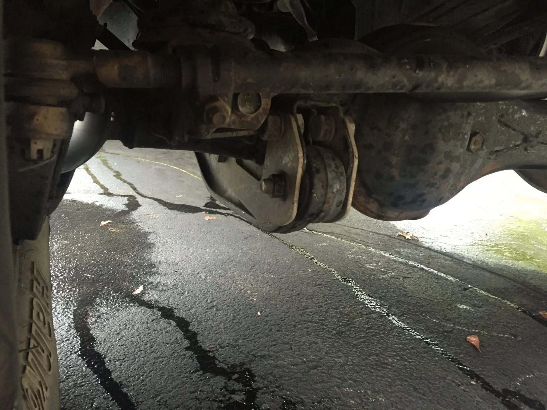

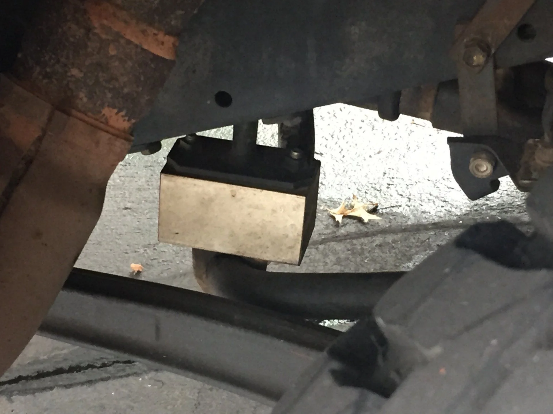

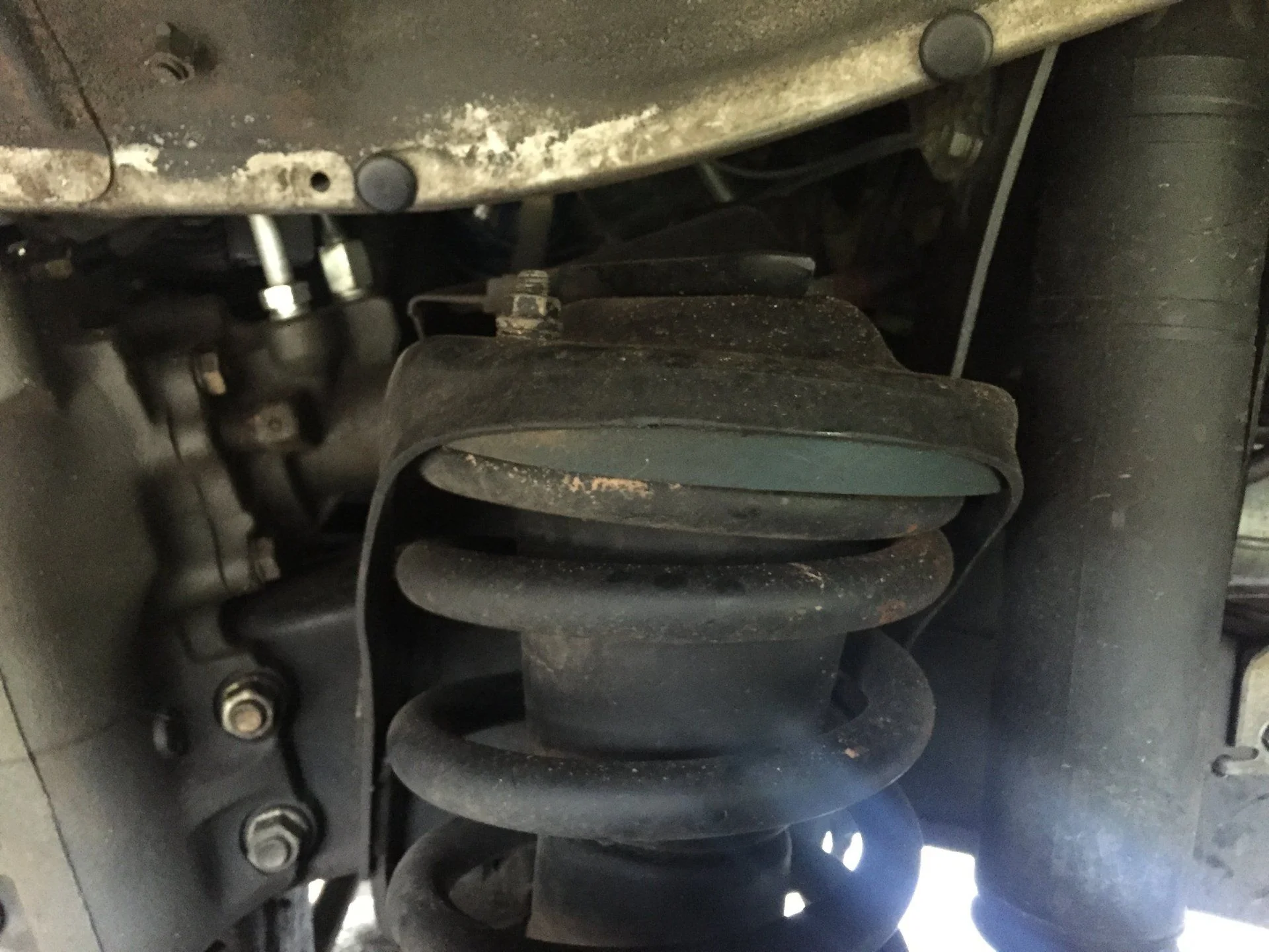

What I am not sure is that what needs to be done for me to put 33's there is a lot of suspension work done by PO stop brackets, caster correction etc.
Looks like some spacer also in the front, CC and some stop bracket.
I don't know if I should keep it there or remove it when putting 33's .
Hard to say without trying. If interested, at some point we could just swap wheels and tires so you can drive it around to get an idea of what/where you are at with lift/handling, etc.

just remove the coil spacers. leave the caster correction more caster makes it track/center better but will leave you with a heavier feeling steering wheel. part of the luxury side is light steering feel (very little caster) which is why there are so many vibration issues. i've run up to 7 on past vehicles with bigger tires amazing. i still miss my CJ on 37's 7* caster. sway bar drop is really just to make it flex better. it shouldn't change much either way
