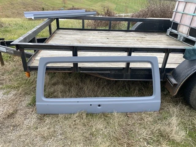

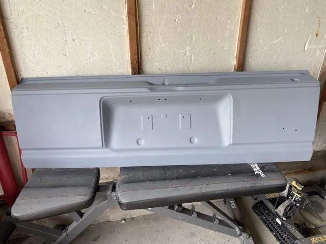

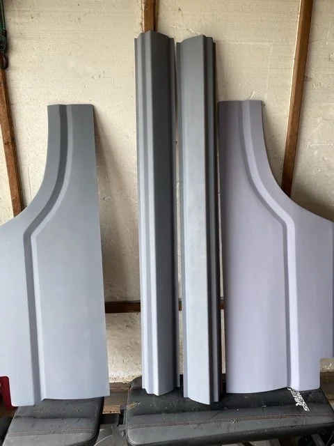

I've been prepping new Wolf Steel quarter panels/dog legs/fenders/rockers for my 62. Also was able to source a tail and upper lift gate, which I sanded down to bare metal.
I've primed and sealed the front and back of all sheet metal (I know that some of this will be lost when the parts are welded on, but my barn environment where I do my work and store my parts in humid - I'm in KY). I want to protect the inside facing sides of all new sheet metal. Should these be top coated? If so, what should be used?
I used duplicolor self-etching primer and primer sealer.
As background, this is my first paint/restoration attempt. I'm doing my best.
When everything is sorted, I am going to Monstaline it (please don't jump on me for this ;)).
Thank you in advance for your help.
