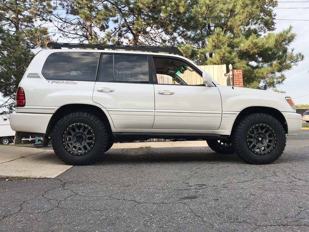

That is ridiculously awkward looking and drives like crap i bet, you'll need to reindex your torsion bars so you can crank it and get more lift out of the front. You also need at least 60mm of droop as well. Most here ride with a minimum of 1" rake and no more than 1.5" maximum rake.
Here's mine with a 1" rake
In my personal experience, “rake” doesn’t mean s***, compared to “front droop”, but there is just about a 0% chance that you can have the “forum hive mind” 1-1.5” rake, with a rear measurement of 24”
