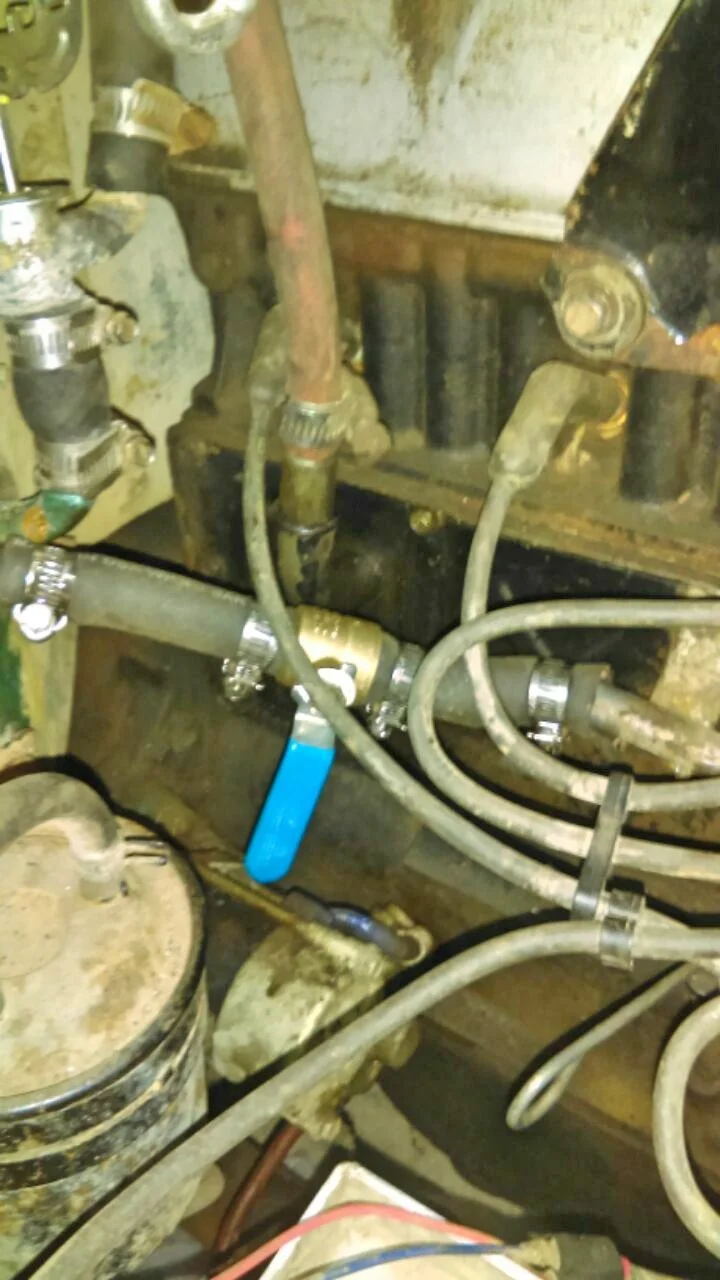

Be sure the lever on the shut off valve is all the way down, as seen in the top left corner of my photo below.
On a 76 it's very easy to make a heater shut off valve like this to completely stop the flow of coolant to your heater. I did this to mine years ago and it stays shut off during summer months. I agree with you, way too hot in Washington lately. 🌞🌞🌞

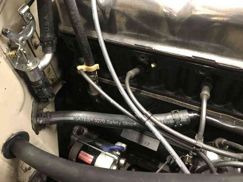

as stated above, there should be a valve mounted to the firewall, passenger side of engine above the starter.
if the valve is there, either the control cable is broke, not hooked up or the valve is bad, it will move but not close off the flow of antiboil.
