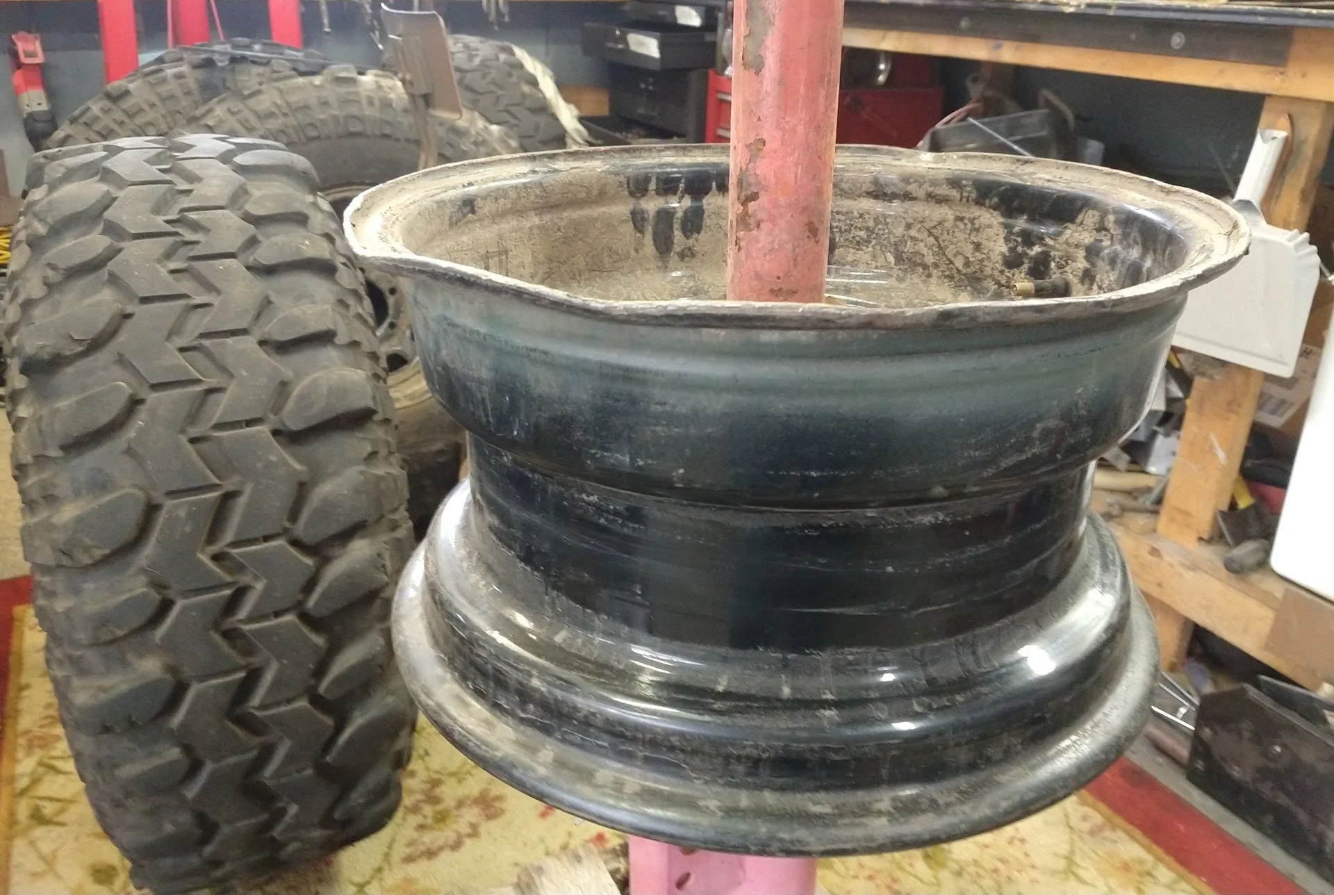

Funny.... I've had a set of weld ons sitting in the garage for a couple of years. Figured it is finally a good time. Just pulled all the wheels off and getting on it. Using the exact same black wheels although quite a bit more beaten up.
Eric, glad you’re going first! :beer: I was worried my wheels were too banged up, may just need to grind a few spots to get the inner rings to fit. What rings do u have?
Eric, glad you’re going first!! :beer: I was worried my wheels were too banged up, hopefully just one requires some grinding to get the inner ring to fit. What rings do you have?
What's up Josh! Like I said I bought them a while ago... Still in the box they came in. Looks like I got them from AtoZ fabrication. Just standard 3" rings. I'm thinking about adding some anti-coning spacers in there. They are 1/4" thick, 32 holes for 3/8" bolts.
Just going to pound the rim so it is somewhat round and close to the ring all around and then start welding. Think I am going to space the ring out some so you run a fillet weld and don't have to grind as much. Hopefully will help with keeping them airtight too.
