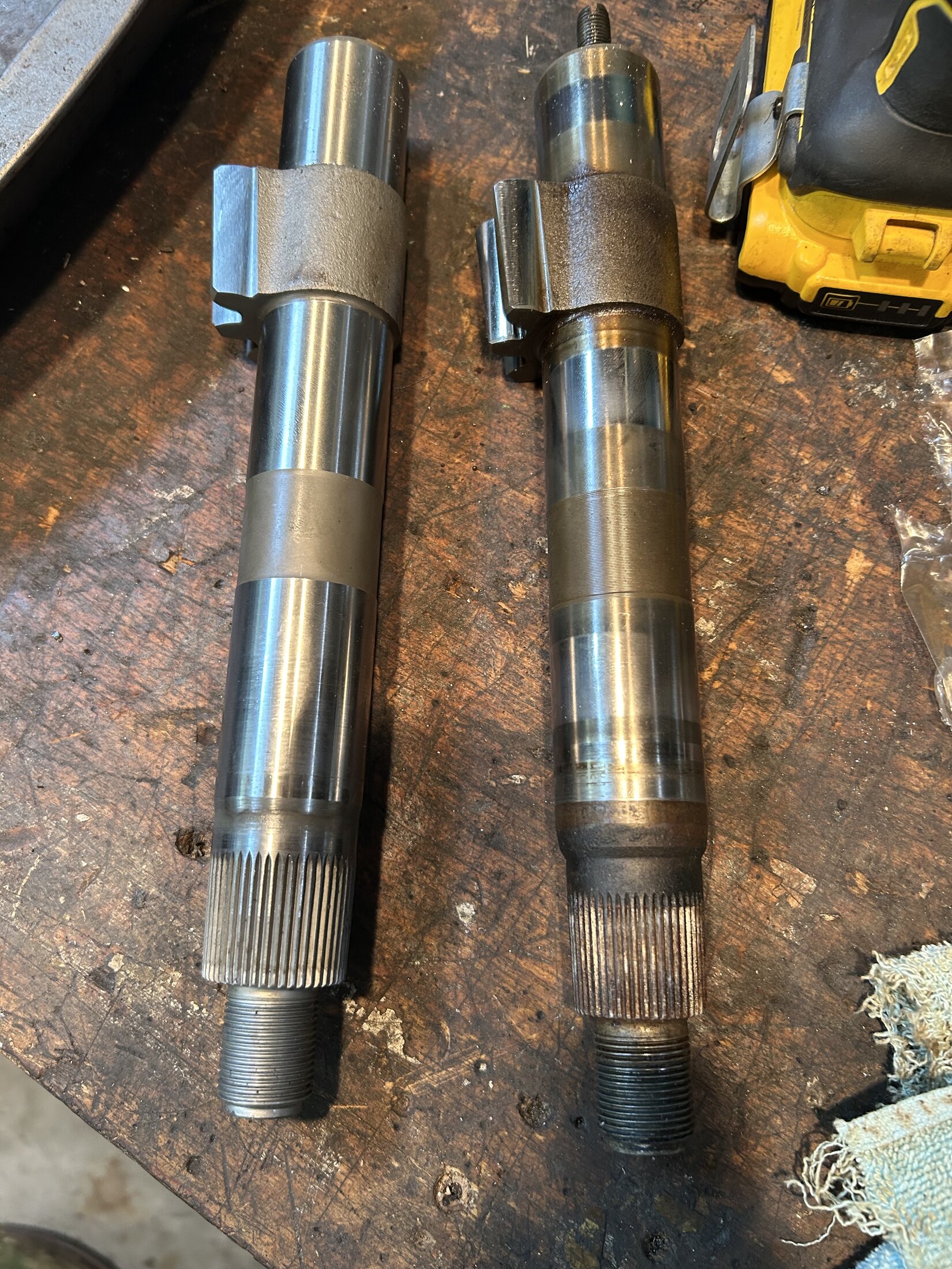

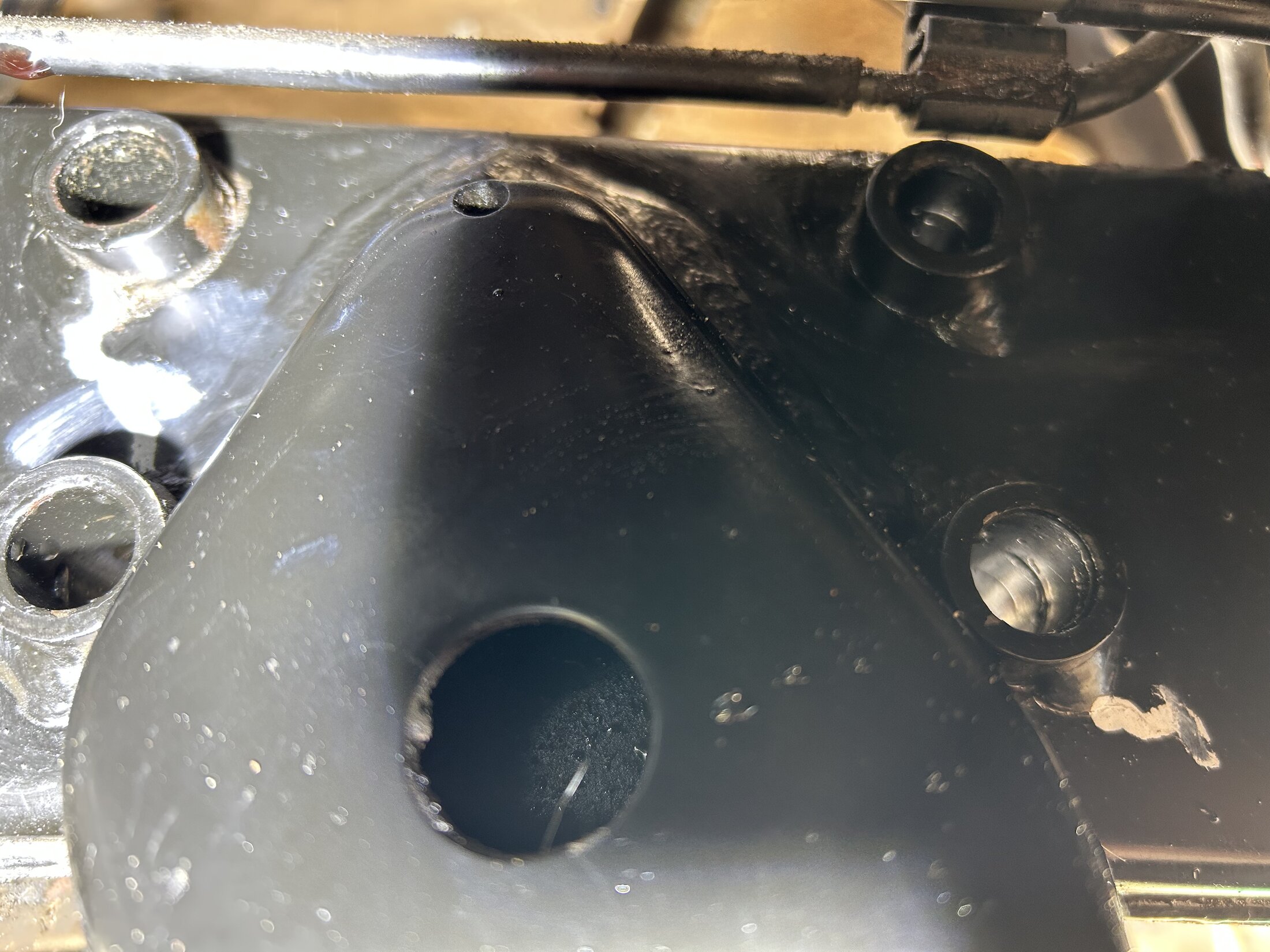

I’m leading the Thursday morning breakfast run but my 80 is on blocks in the driveway as rebuild a steering box with a 105 shaft. Also drilling and welding the minor cracking on the inside of the frame and adding the delta plating where the box bolts on.
We had a 80 sheer the 105 shaft on Kane Creek at Cruise Moab this year . Fun stuff
Funny thing, is the panhard bracket had no visible cracks that I could find and my 300,000 mile sector shaft had no twisted splines that I could see. I already had a spare box so now I have a leaky well used box plus a spare shaft. Doing the sector shaft on the work bench makes me think it would be pretty easy to swap a sector shaft on the trail if need be. If the inner fender was not in the way, you could swap the shaft with the box still bolted to the truck.
I used to carry a spare Saginaw sector, Doug any idea how they compare size wise ?
I believe the 80 sector shaft and early Saginaw shaft are about the same size. The later 1980's saginaws are smaller?

Doug if you haven’t ordered the delta kit, I had send cut send cut out 5 sets of plates, (it was cheaper that way). PM or call me and I will send you a set..
Got the Delta plates in the mail last night. Just need a day off to get things back together.
A Dremel with a mini disc or a tiny carbide burr. Works great on the cracks, have fun,,, welding contorted is for young guys…
Dremel with the carbide bit is the ticket . I just finished slapping together the steering box. Gotta hit the sack.
